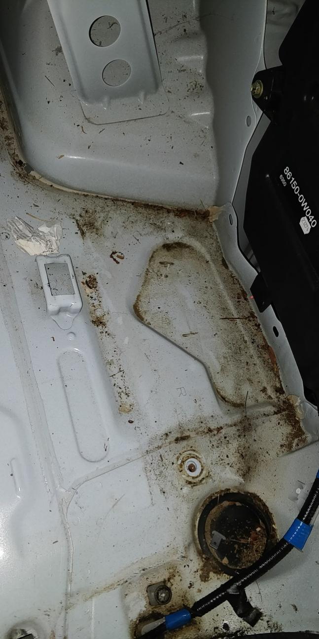

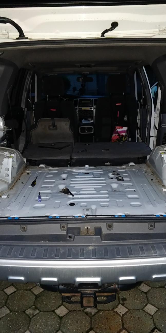

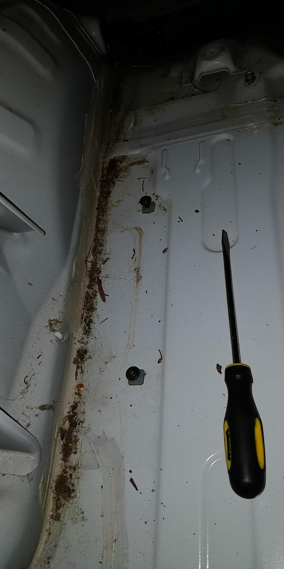

started the process of gutting the whole interior to clean carpet and clean out floors under carpet. Previous owner was apparently a disgusting person. I took pictures of the stuff in the back, the front is even dirtier.:cry::cry:
only thing I broke is the two small pieces of plastic trim that hold carpet down in the very back, so I gotta find those also
Im getting new carpet in part of the house so Im gonna get some extra pad and replace the stuff under my trucks carpet. I dont think it will be too difficult. I know the truck is gonna smell way better when Im done.

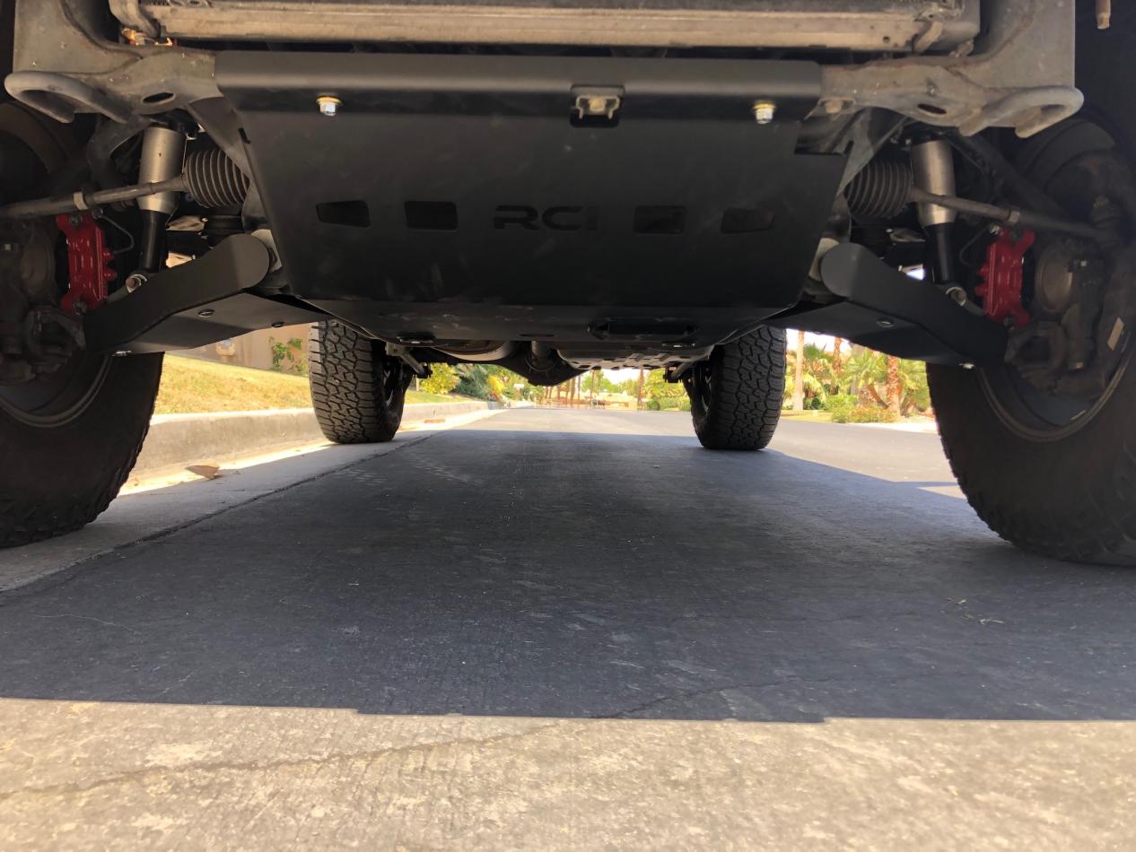

Got my RCI Front Skid and A-Arm skids installed today from the recent group buy. Absolutely blown away by the turn around. Ordered Monday, received and installed today! Also ordered a Gobi ladder, but who knows how long that's gonna take to get here.

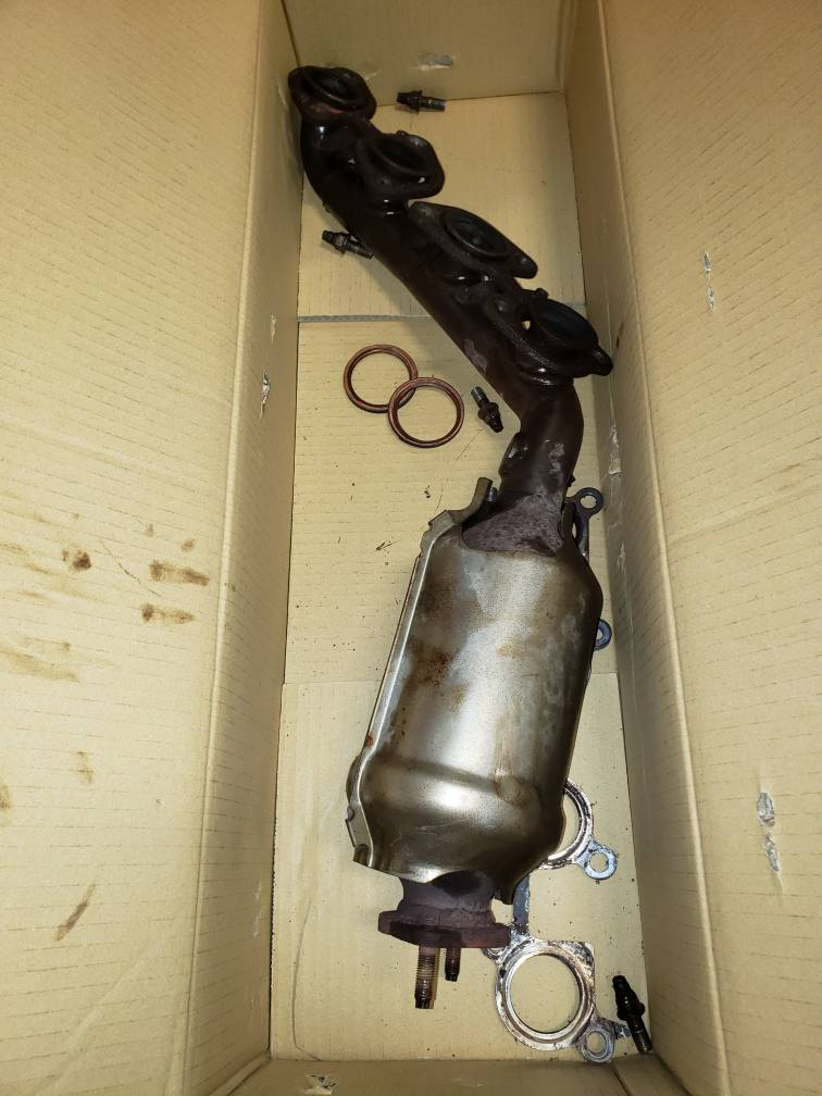

I had to replace the passenger side exhaust manifold today.
What a ***** of a job, took almost 4 hours.
But no more tick, tick, tick, tick

I really need to do this too, but I'm holding off as long as I can. on the old one, can you actually see where the leak is?

This is a brutal job, I replaced the passenger one on my v6. I used a plasma torch to cut the nuts in half. The manifold metal on the v6 is thin and warps leading to it leaking at the block.

Mine's been ticking for a while and I'm afraid this is what it is. *Really* not looking forward to doing it. Might just spring for headers when it comes time - to make it more worth it in my mind.
To verify my leak I turned my home air compressor pressure way down to 30 and rigged it up to the tail pipe using some fittings, a spray paint cover and a clamp. I slowly applied air while listening for hissing. The leak became apparent pretty quickly.
Wish I had an air compressor :/ I do have one spot under the cabin that definitely has a leak of its own, (I can see the black where exhaust comes out) but I think I hear one around the manifolds as well.
Exhaust shops around here are cheap enough I'll just take it to one for diagnosis.
