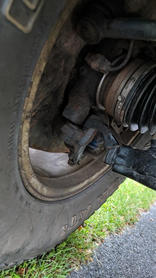

Holy crap! That’s bad! It’s One of the main bolts holding your knuckle together!
Did you put Red Locktite on those bolts? The book says to do that.
Yep! The tow truck driver looked at me and said "You are very, very lucky"
And no, I torqued them to spec but didn't realize I needed red locktite on em. I'm going to go back over the rest of those bolts and put it on now, though.
Got incredibly lucky on Saturday. Heard a little *ping* on my way over to some mountain bike trails in a local park. Was suspicious but everything drove fine so I thought nothing of it.
As I was back out of my parking spot later my front right tire started dragging. I pumped the brakes thinking it might be a stuck caliper and put it in 4WD in case it was something screwy with the drivetrain. Move the car forward and it was fine. Reversed in 4WD and it seemed fine.
Got to the end of the park entrance and decided to jump under and take a look before I got too far.
Who can spot the missing bolt?
Was a lesson to me to always recheck bolt torque after 100 miles or so after doing work. Soooo glad it didn't turn out as bad as it could've if I'd kept driving on it.

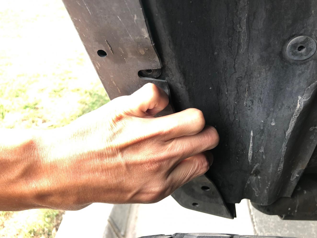

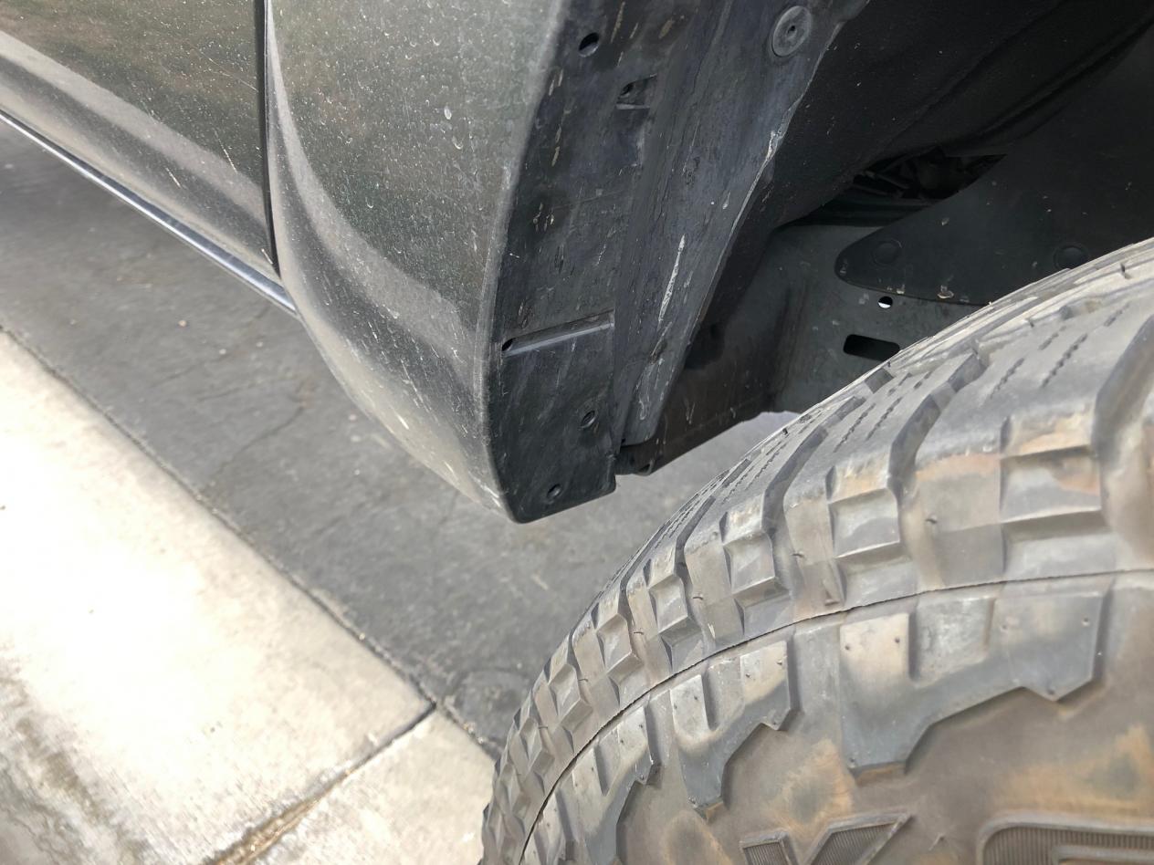

The last major rainstorm we had ended up soaking my passenger side floorboard. Got the water damage all taken care of shortly after, bet never actually fixed the problem.
So, I took some flexible galvanized wire, sanded the edge down smooth and used that to clear the top drains. Water immediately started going down the drain holes, but wasn't trickling out the bottom.
Thanks to this forum, I decided to look behind one of the panels where the drains exit. A laughable amount of debris had accumulated there over the last decade and a half of being parked outside. Cleaned it all out and now it's draining perfectly! I couldn't believe the amount of debris, so I'm definitely going to be finding a way to put some mesh up top so it won't collect there in the future.
hey - did you just undo a section of the fender liner to access the drain area? is there a drain hole alone the rocker that you exposed and used a wire on? can you let me know a few more details - i really need to do this and thanks
I will post some pics when I get home from work

Installed the missing control arm bolt! As much as I love my Volvo, I can't stand having the 4Runner down for the count. It's supposed to be the reliable vehicle
Here's a few photos that should steer you in the right direction. I didn't pull the panel far away at all. Just enough to get a flathead screwdriver or a finger in there and swept the debris out. You may need to go along the bottom edge as well depending on how much debris is in there. I didn't have to unclog any drains down there, only up top at the sunroof opening in the corners.

thank you...i see you popped some clips to get behind that panel. i take it that panel is the fender lining? almost looks like it is part of your fender without a crease to the left of the pic. im going to do this soon i bet its why my passenger floor is flooding during rain (just wet carpet not flood)

or is that showing no fender liner?

Yep, just the clips that are holding the fender liner to the side skirt/fender panel. My clips were quite brittle for 15 years of 120+ degree summers. Easy to replace though!
It's easy to test to make sure you've cleared any blockage. Just open the sunroof and pour a bit of water in the drain holes. If u see it coming out the bottom, you've hopefully solved your issue!
