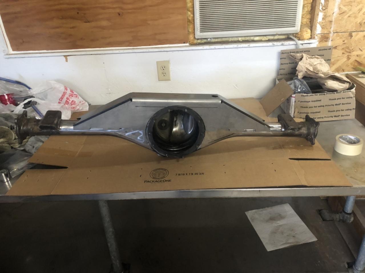

Pulled out the rear double decker setup to start planning a rear cargo system. Planning on doing a flat floor with a pull out table underneath to start and then going to build to separate modular drawers that can be used together or independently, one will have a fridge slide on top.

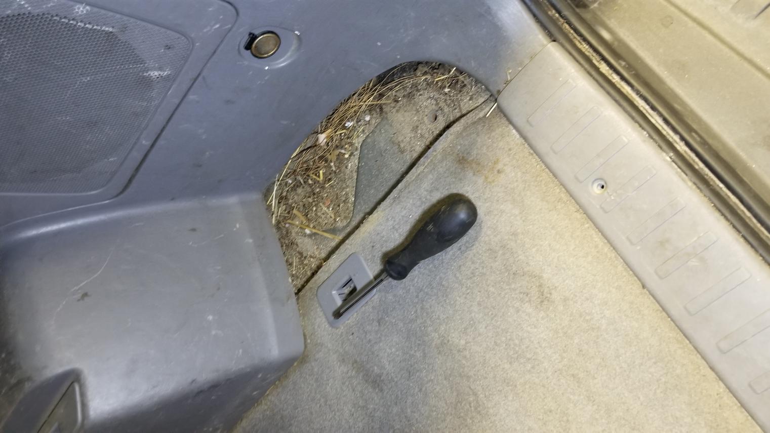

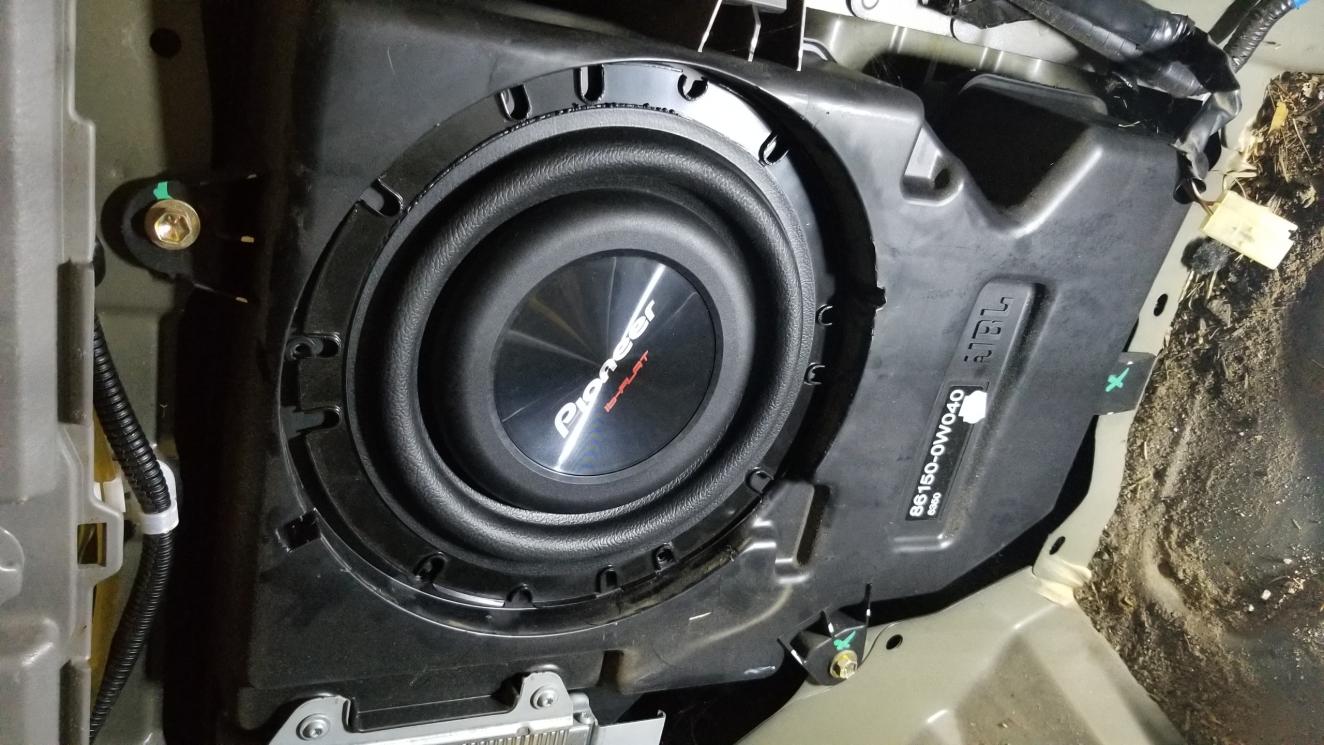

Swapped out a junked JBL sub for a new Pioneer.
Easy job. Only took half an hour. I was shocked at how much dirt the PO got in behind the panes! How is this even possible?
Happy with the sound now! Decided to cut the wire to the center dash speaker. Difference is night and day.
Nice!
Is the subwoofer worth the $64 and time to install? Is it really an upgrade?
Also, why do you disable the center speaker?

My sub and center speaker were completely blown. It was intolerable to listen to. For 64 bucks it was welllll worth the money. I work on cars for a living so the time was nominal.
As far as the center speaker goes I just didn't see the point in replacing it. But listing to it make noise was driving my crazy. Took 2 minutes to pop it out and snip a wire. Problem solved.
The sub replacement was a piece of cake. The stock sub connections are labeled plus and minus so just check the wires going to each becore you cut and strip them. It bolts right in, no drilling required.
