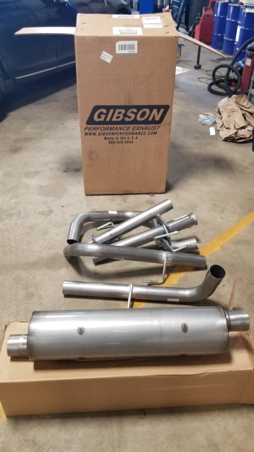

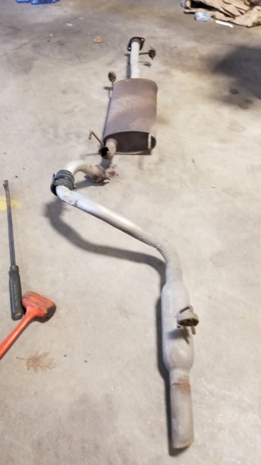

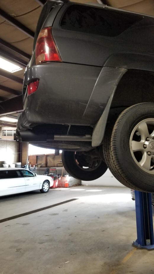

Well, my aftermarket garbage exhaust rotted off (had to zip tie it to the cross-member to stop it from rattling)... I didn't really want a performance exhaust, but I did want stainless. So I bit the bullet and looked until I found a Gibson on sale. I got the black tip stainless elite for $379 shipped, so I was happy with the price. Got it installed today in 40 minutes. As recommended I stuffed a screw driver handle between the pipe and cross member before tightening the clamps. I do not have any rattles as some have had. The exhaust is deep and louder than stock at idle up to about 2300 RPM then I don't notice a difference. So far I do like it.
If you buy this exhaust here are my tips.
1) buy a new donut gasket as it does not come with one.
2) Use the screw driver handle trick mentioned above to avoid rattles.
3) Leave all isolator hangers on the vehicle, apply a quick squirt of penetrant to each hole before install to allow the new hangers to go in easily.
4) Install the pipe over the cross member first and work in both directions off of that (you have extra pipes to fit different models, this will help you figure out which you need most easily)
5) Assemble it in the vehicle and do ALL of the hangers last. NOT by one as you go.
My only gripe with this exhaust is the tip placement shows a ton of the pipe inside it (maybe this will go away with some driving and soot) but I feel the need to take the tip off and cut a good 5 or 6 inches off the tail pipe. I will be doing so and then pushing the tip in a bit farther. Other than that this cannot be beat for the price.
