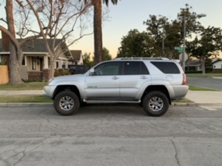

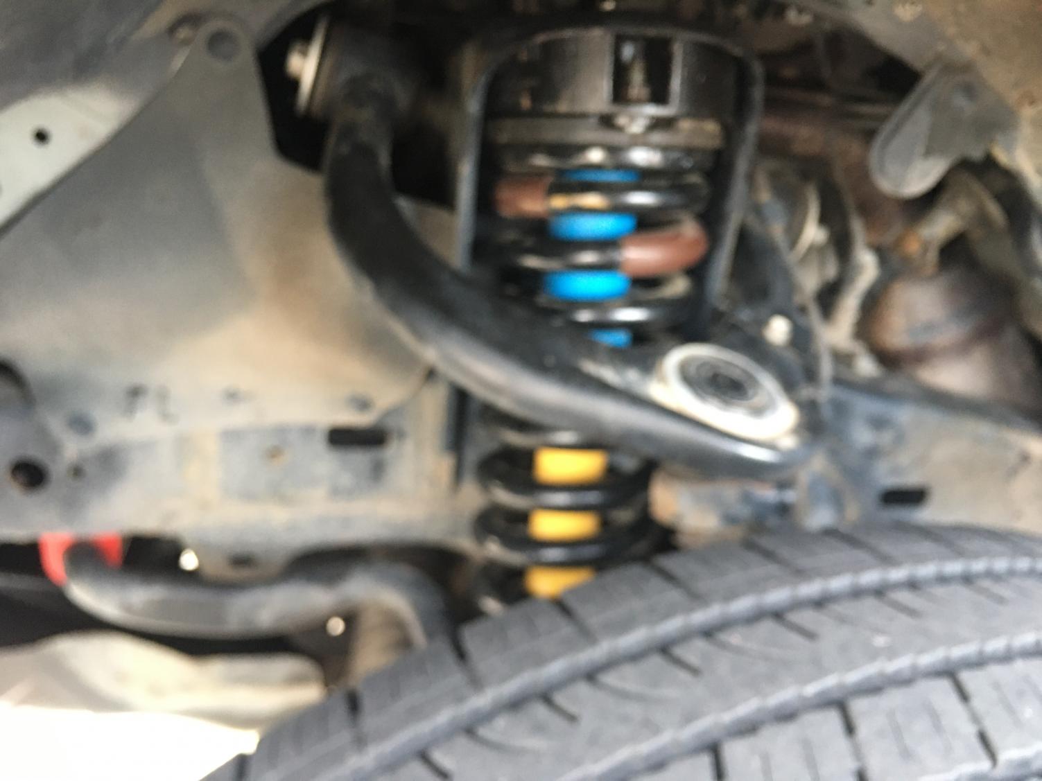

I got the ‘18 TRD Tacoma shocks and struts on. Took about 5 hrs, no big deal, although I had to cut the rear shocks off. XReas is history. I may be sitting a bit too high in the front now with my spacers.

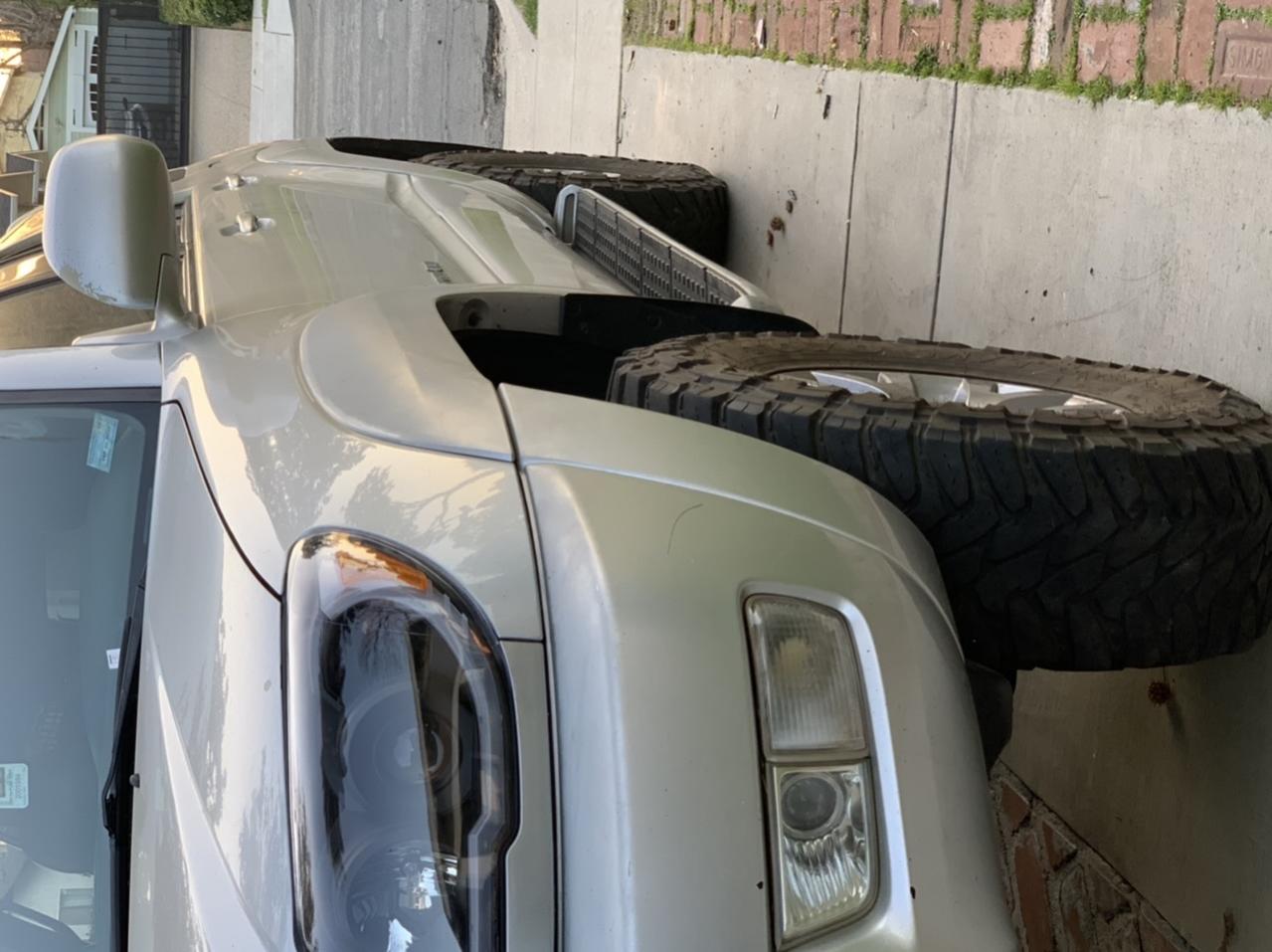

HID Retrofit
I purchased a set of aftermarket housings from Ebay for $80 and retrofitted Morimoto Mini H1 7.0 projectors into the housings. I used these two threads as references (thanks @TiN and [MENTION=65918]krupnation[/MENTION]):
Finally done! Mini Morimoto H1 retrofit...pic heavy
TiN's Mini H1 Retrofit
I purchased this retrofit kit from Lightwerkz and went with 4500 K XB bulbs and mini gatling gun shrouds. Install was easier than I thought and I have the rotational alignment pretty well dialed in, but I still need to do horizontal and vertical aiming adjustments. One of the vertical adjustment screws looks like it came out of the housing so I'll likely need to re-open the headlights and get the aim dialed in right.

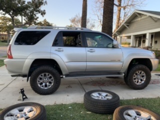

Changed up the wheels a little
