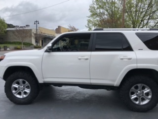

Lift done on Sunday, tires yesterday, and alignment today! It was a busy weekend but completely worth it.

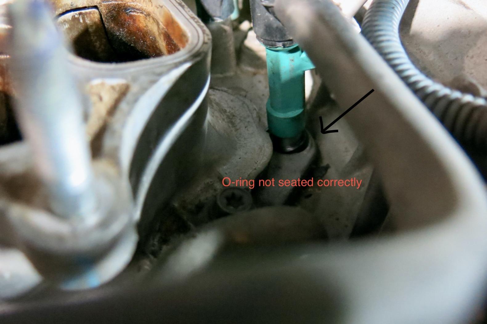

New Fuel Injector (with problem)
So, like many projects on these trucks, we have to do it multiple times to get it right. This is one example. I had a sticky fuel injector. It improved about 50% of the way with some really strong fuel injector cleaner, but did not resolve the entire problem. (BG 44k) Took the intake off and replaced the injector and it made a terrible noise, obviously did not like the old gasket on there, and also threw the old misfire code again. Took it down again, and noticed that the fuel injector was not seated correctly (see photo). Fixed that, put in a new gasket for the intake and VIOALA, thing runs like new. Smooth and happy.
437K and ready for another 400+.

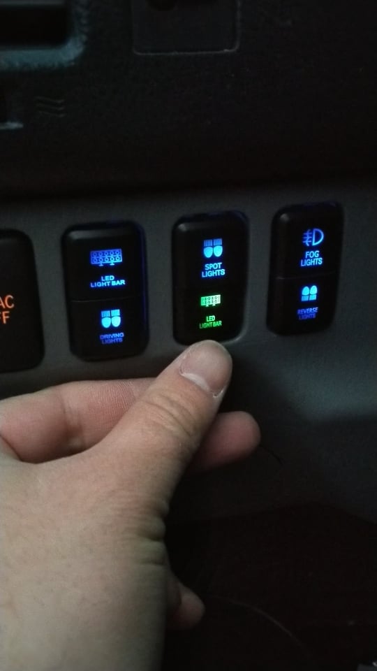

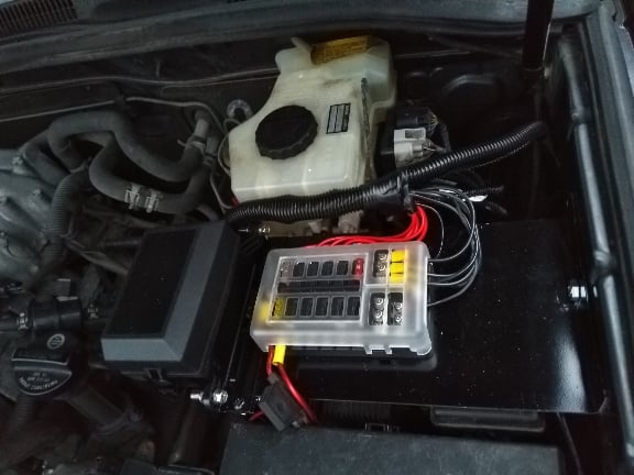

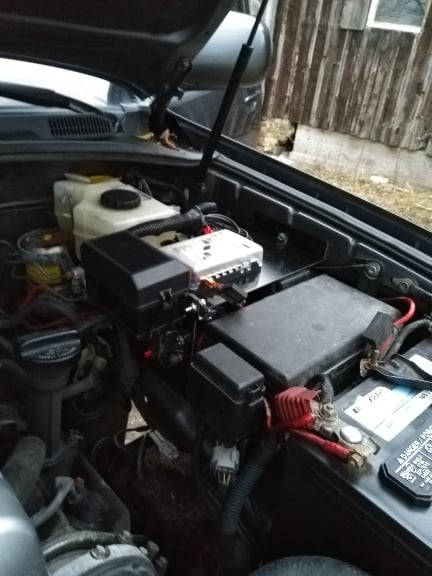

TLDR: Added aux fuse panel, added wiring to turn on auxiliary lights automatically with stock headlights brights switch!
Finished stage one of a lighting project - something I've wanted to do for a while.
I found some awesome double push buttons on eBay from China that have the same profile as a ch4x4 but two buttons per unit. They don't have custom ones but I bought one of each of what they offer and eventually plan on using each option.
With these, I designed (attempted to) a circuit that would allow me to either:
A. Select manual mode, turn on auxiliary lights individually with pushbuttons
B. Select auto mode, turn auxiliary lights selected by pushbuttons with vehicle's bright switch. I've wanted this for a while as my lights can be lacking for back country roads and I get tired of keeping my finger on the auxiliary switch should an oncoming car pop over the hill. I'm also able to disable brights in automode if I don't want to use them (fog and snow at night)
C. Master disable all auxiliary lights, should I need to for some reason...
I currently only have some Auxbeam 6" LEDs on the bull bar, but I plan to add the Off-road Town J583 lights and probably an overhead led bar once I buy a roof basket. I'm considering ditch lights but I haven't decided yet.
I took advantage of the project to add a 12-slot auxiliary fuse panel in the front; hoping to complete a dual battery set up later. It's an aging T4R but most of the components can be reused on my next vehicle when the time comes. Currently supplied with a 30A fuse until I get my battery cable lugs in the mail, then I'll be using a Bussman 100A circuit breaker.
Ran into a few circuit problems after installing, but I was able to resolve those and everything appears to work well now. If anyone is interested I'm willing to share the diagram once I get it up to date.
If you value your time there are some pre-fab auxiliary circuit systems out there on the market in the $300-$600 range. This stage of the project took me 30+ hours, so the prefab stuff could be worth it if you don't want to spend the time!

Nice job! Do you have a link to those double switches? Have never soon those.

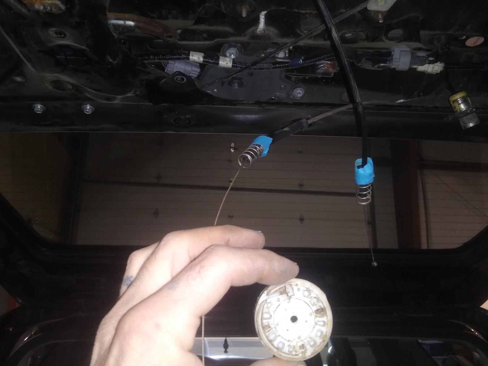

09 4runner Liftgate motor
Anyone know how to put the window regulator cables back on the spool that goes in the motor??
