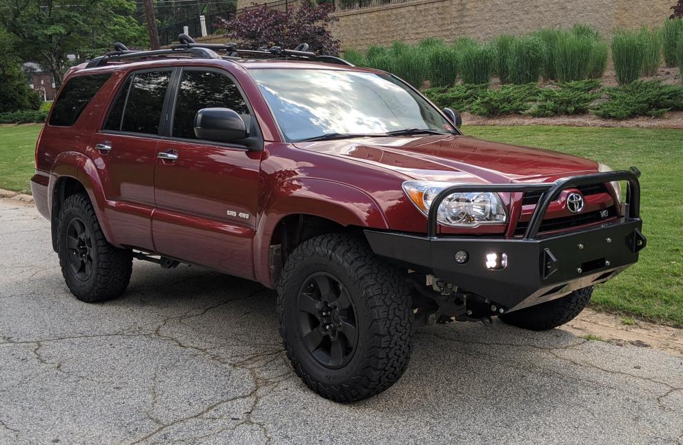

Finished getting the Shrockworks bumper mounted and lights wired up, new 275/70/17 BFG AT's with 5th gen plastidipped wheels. Also removed my front mud flaps and there is no more rubbing. Its finally coming together! Havent decided what to do with the turn signals in the bumper. . . I dont really need them with the turn signals in the headlights. I may just wire them to a switch as running lights? Any thoughts?

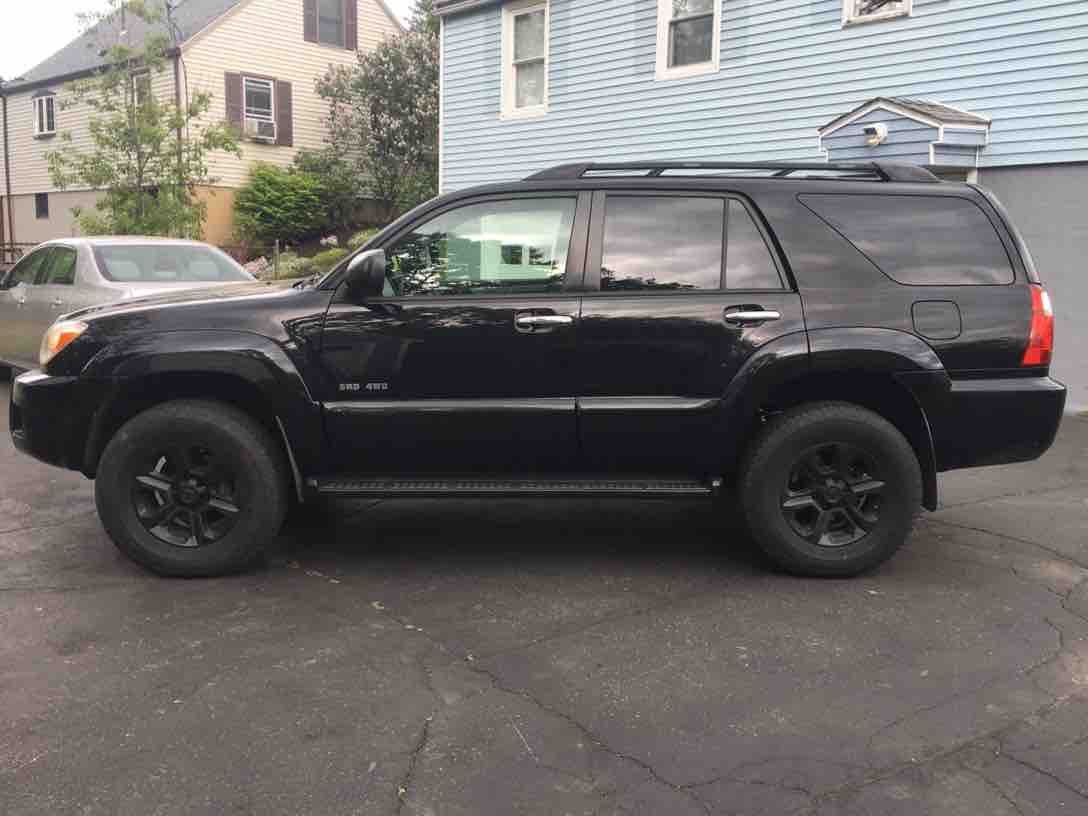

Finally assembled my 5100s and FJC suspension. Love the new ride and leveled look, alignment later this week [emoji1303]IMG_4631.jpg
Looks good, what lift are you running? I also recently installed a SW bumper in the same configuration, planning on tapping into the turn signals and running lights when I have a minute but interested to hear what others have done as well.

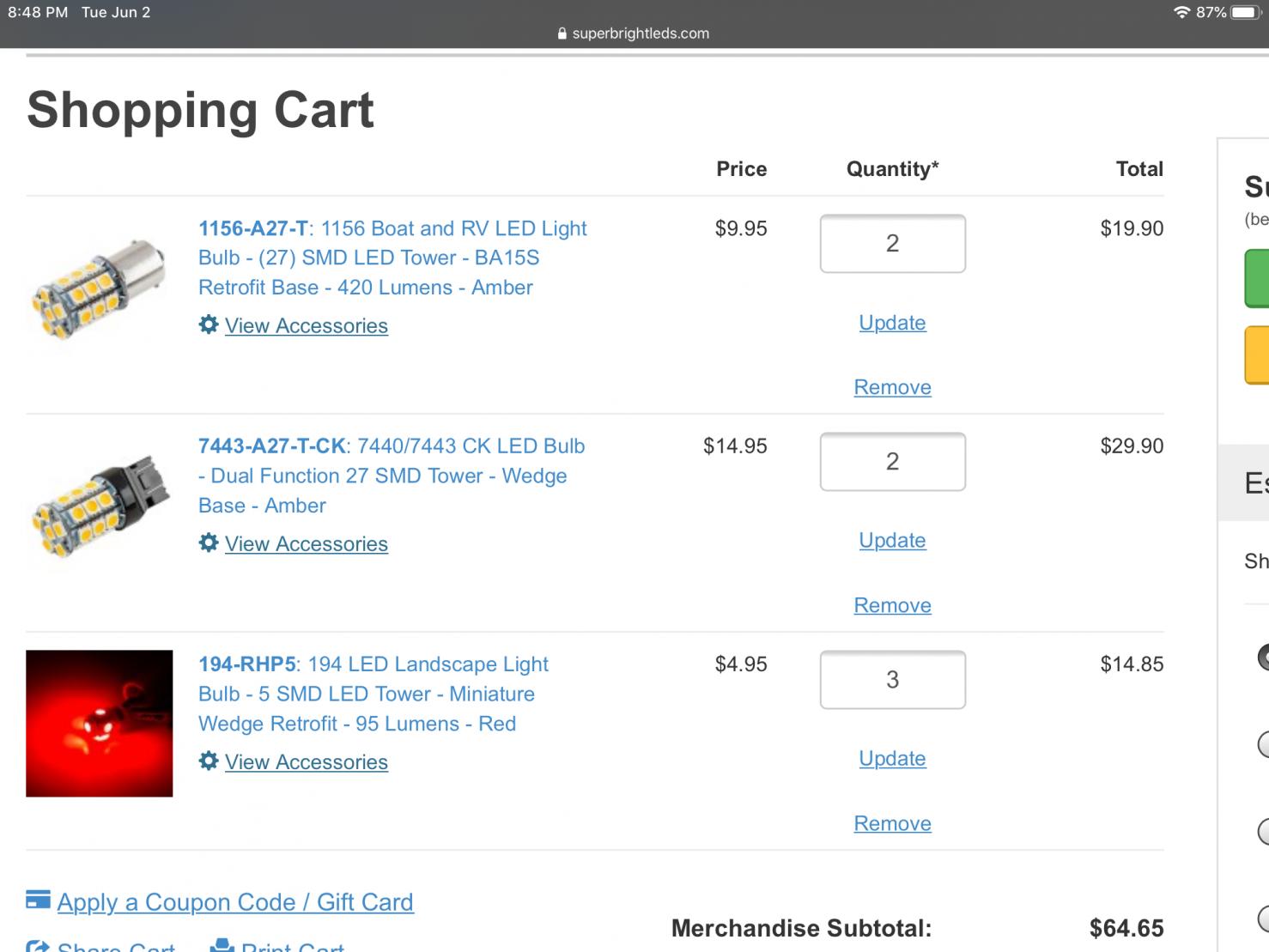

Would you have part numbers, brands, and info. with your LED signal swap? Maybe a post you did? I was on superbrightled.com and want to make sure I get the right ones and what resistors are needed. Not sure if these are the right bulbs or not. Only the rear shows dual function.
Also Resistors vs. flashers? I’d rather not have to cut my wires and solder in resistors if I don’t have to but willing to consider if it’s my only option. Feel free to pm me. Thank you.
I'm not sure about part numbers/brands because I did it a while ago, but those dual-function ones should work for the DRL/blinker. Unfortunately, you'll have to use resistors - as the flasher relays available don't work with DRLs. It's pretty simple to wire them in, though. Just find the ground wire, and the wire that provides the 'flash' voltage. Wire the resistor between those two and you're good to go. Resistor kits usually include everything you need to do it.
So you now have LED DRL/turn signals?
Nice. Is there a writeup? Feel like I may have missed something and would like to do this on my ‘07.
Honestly, just replace dual-filament blinkers with dual function LEDs (should be a 7443 bulb), figure out which wire provides the flash signal (turn on the blinker and probe the socket with a test light/multimeter), then wire a 'normal' LED resistor (can be found all over the place online) between that and ground, and you're done. Takes like 5 minutes per side.
I am just running front suspension from a TRD Offroad 4x4 Tacoma with a 3/8" spacer, the rear is stock.
turn them amber then make em running lights
Yeah I think I am just giong to add a switch and make them running lights.
