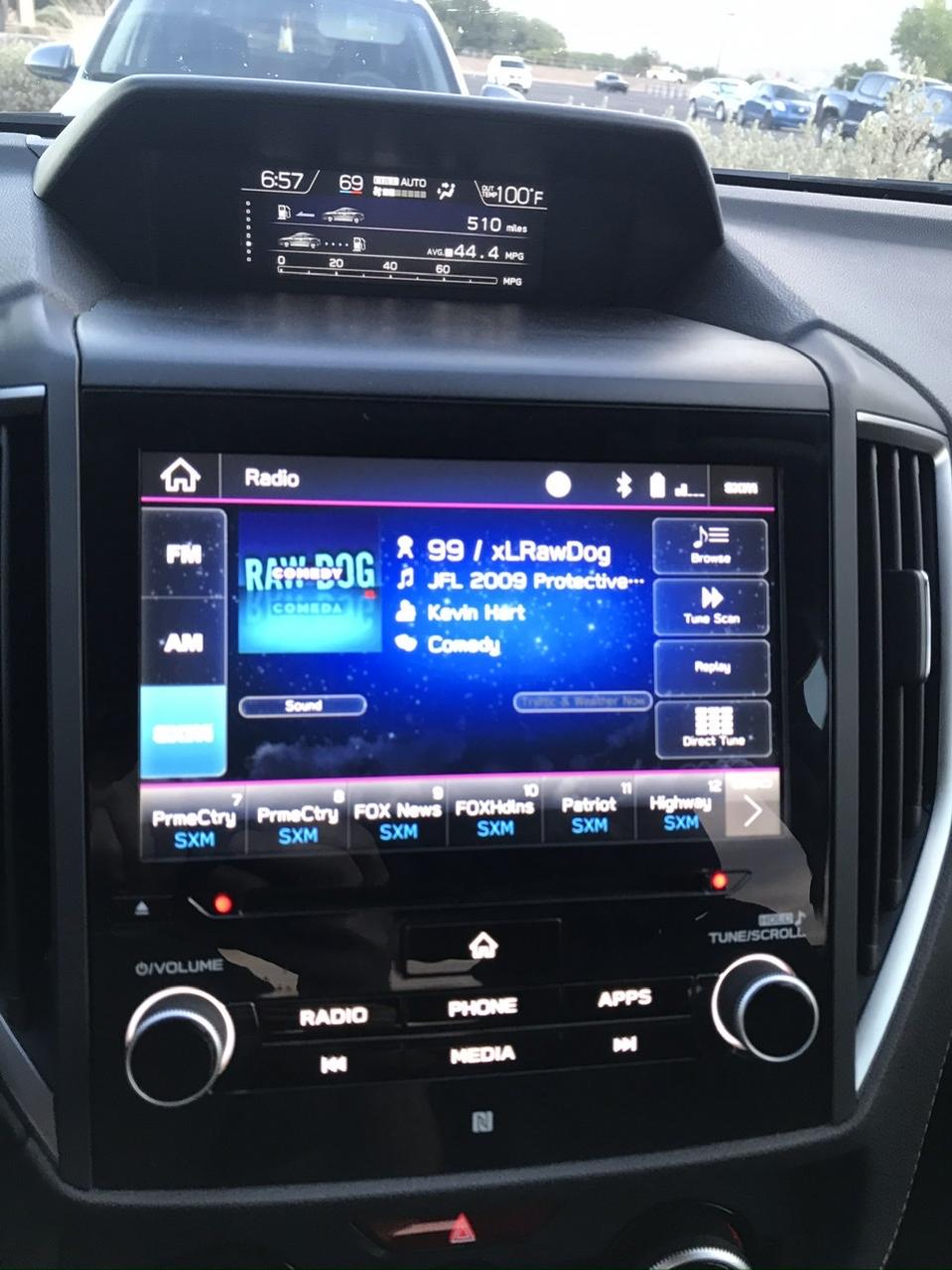

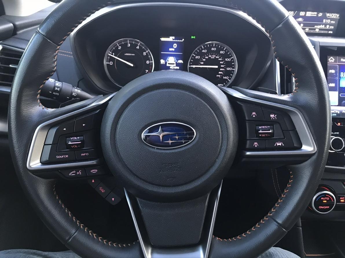

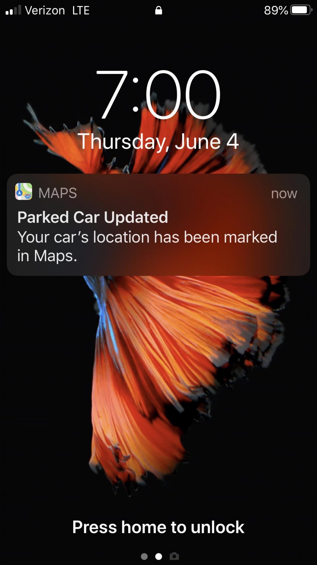

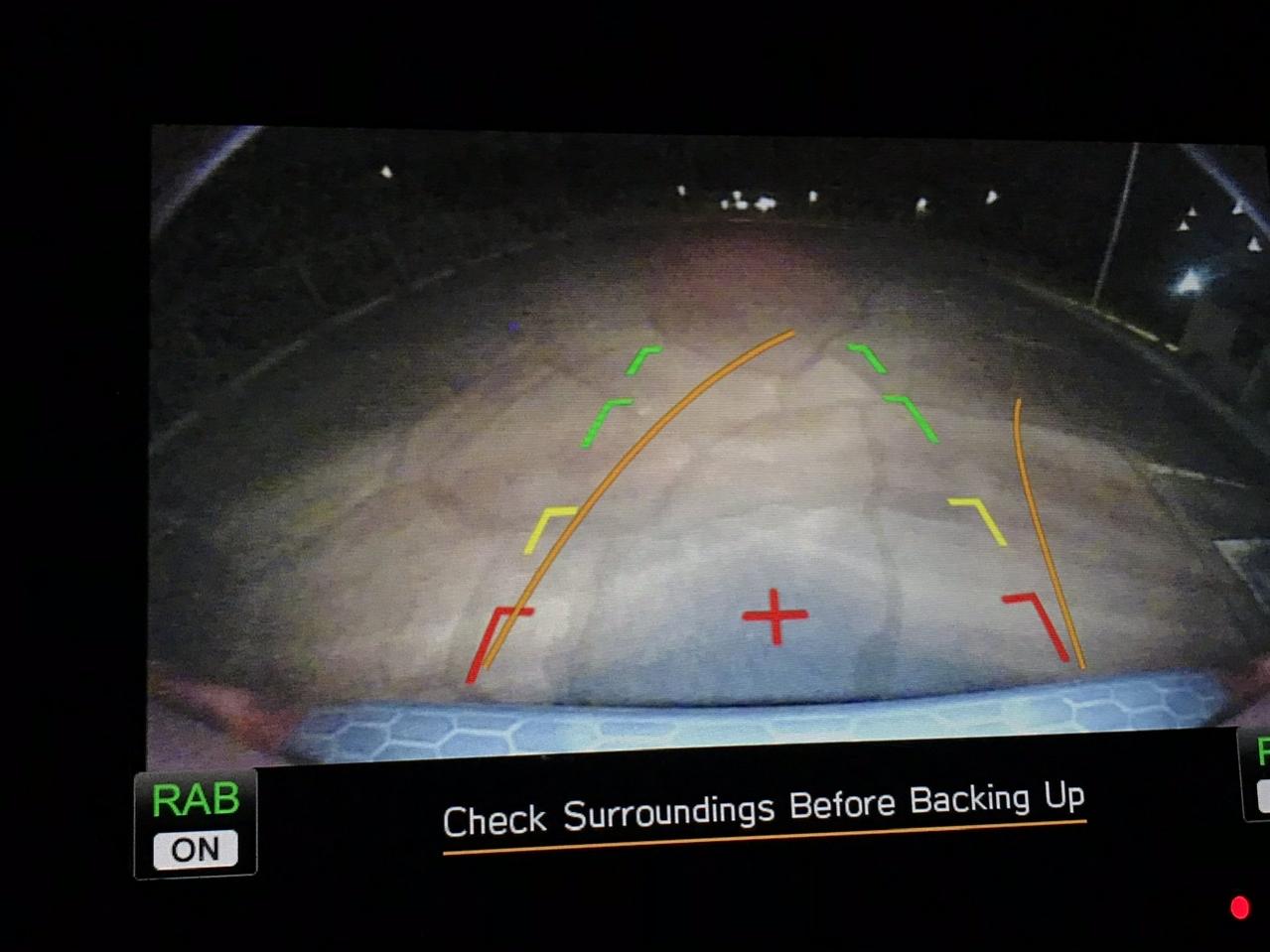

Left the 4Runner at home this evening for my drive to the city. Since I’ve got my 4Runner February this year I have only driven my early 2019 Subaru Crosstrek about 4 times and was worried about the battery and gas going bad or gumming things. I start it here and there but that’s about it.
I didn’t really want to drive the Subi. but felt I’d better. Kind of hard to relearn all the steering wheel controls and placement of everything. Sure miss the gas mileage but don’t mind too bad since I love driving my 4Runner.
Since having the 4Runner I’ve found myself trying to duplicate so many things (except for the lack of H.P. Lol) I’ve come to love with modern technology. I’d list them all but would take too long haha.

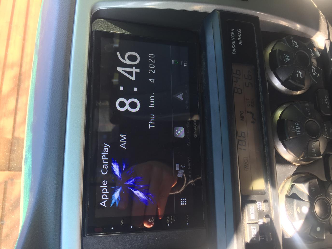

Installed the new Kenwood dmx4707s. Pretty sweet little deck capacitive touch screen car play and only 300 bones!
