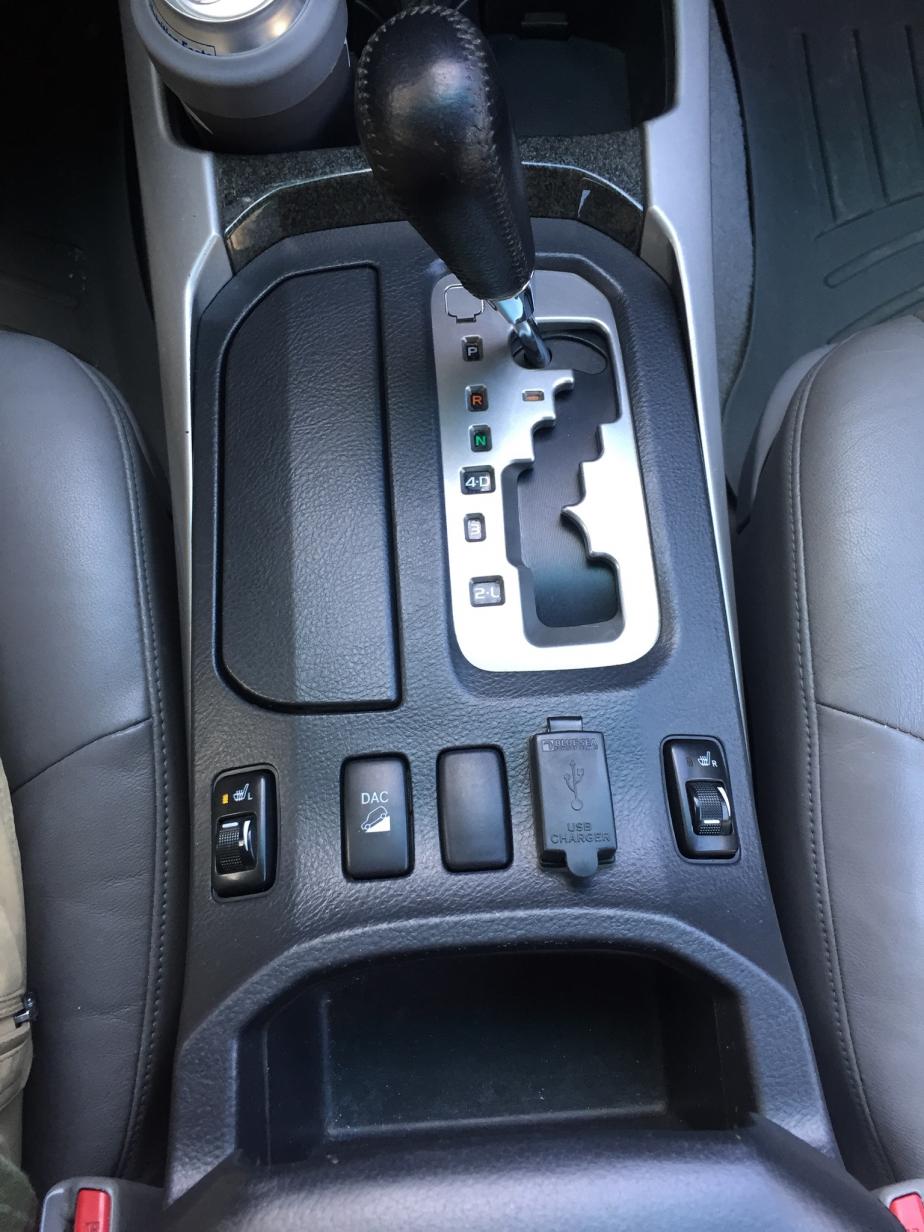

Deciding to put that into the center console, made me evaluate The location of the DAC switch. So off it went to be relocated next to the 4WD lock switch. Suddenly I had two available switch locations available. Hmmmm, what to put there. Hint is in the photo. To be shared next.

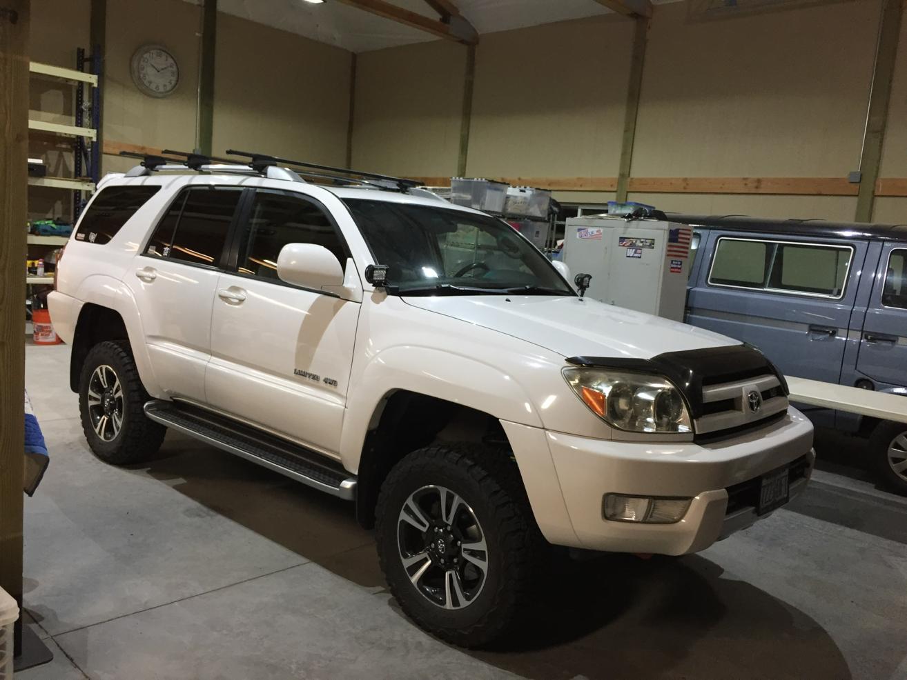

I’ve owned all of the first 4 Gen 4RNRs and the first 3 all got mods. It’s taken 17 years to start on this one which I bought new in 03. It’s been so good, but I think the girl is appreciating the recent attention.

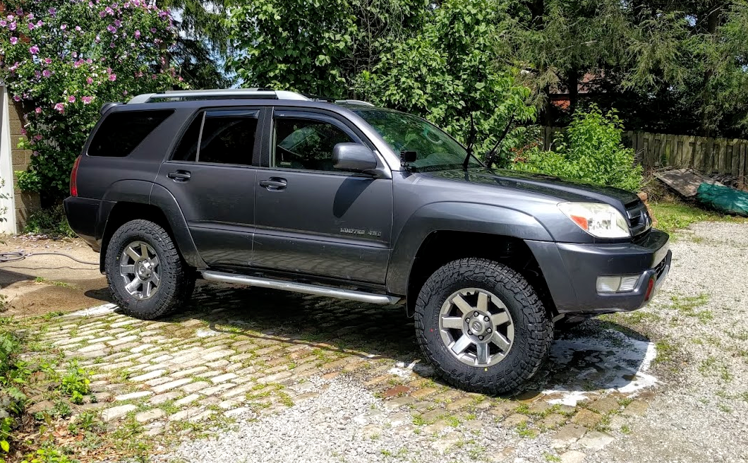

Picked up some new wheels the other weekend and had the local tire shop put in the order yesterday....got the call at 8:30am the tires were in....they had me in and out in 15 minutes. Did a quick wash job and now ready to head out camping for the weekend....

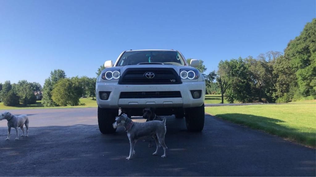

Spent most of yesterday installing a halo kit that I bought from Oracle Lights. I’m super happy with the results. Woke up this morning after waiting on the sealant to cure and put everything back together. The only thing I’m concerned about is fitment. These halos fit perfectly on OEM headlights but the ones I got from the local body shop (I was backed into while I was away from the 4r and it completely destroyed my grille and both headlight assemblies as well as bending my hood upwards) are apparently differently sized. The rings that go around the high beams didn’t stick all that well due to the fitment issue so I applied some fast-curing epoxy to make sure they wouldn’t fall off. Wired to my DRL’s. The dogs seem to like it :)

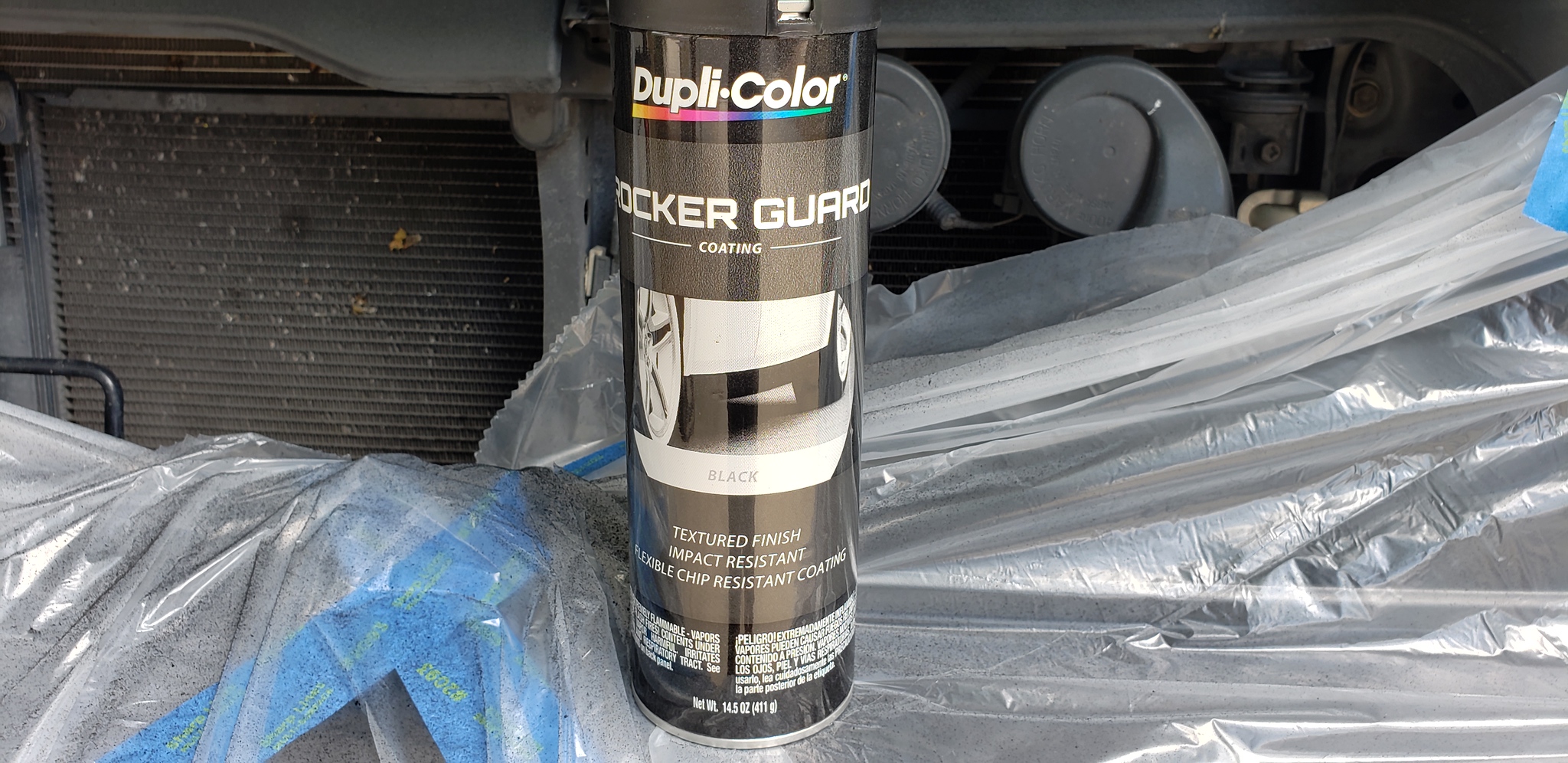

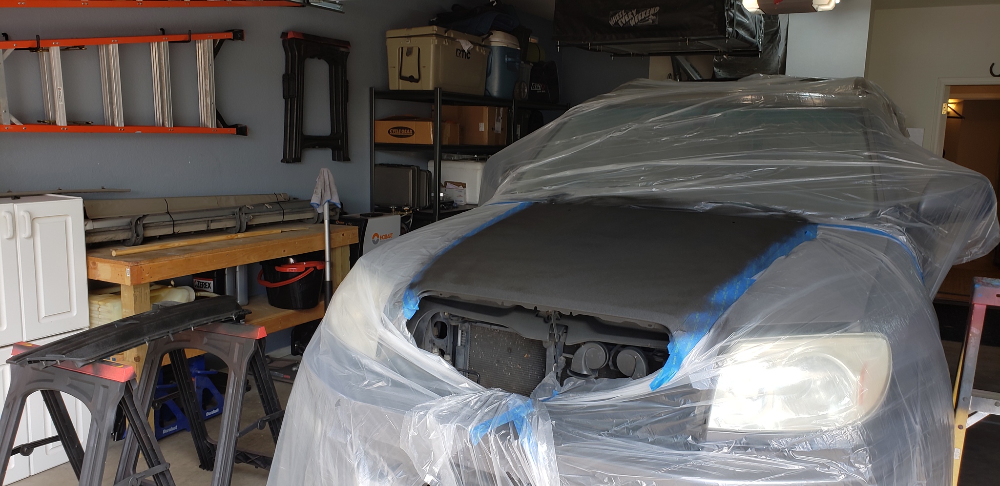

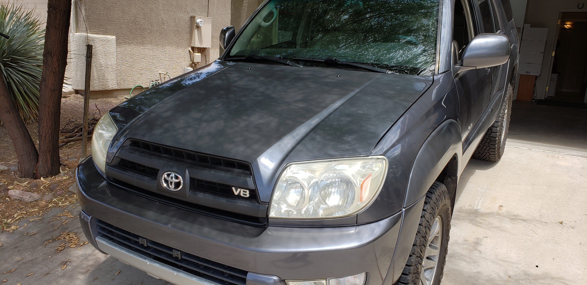

I decided I really hated the way the hood blackout looked with the matte finish paint and decided to repaint it a 3rd time. Used Duplicolor rocker panel black paint this time. Slightly textured. Painted the hood and grill with it. I think I like it so far.

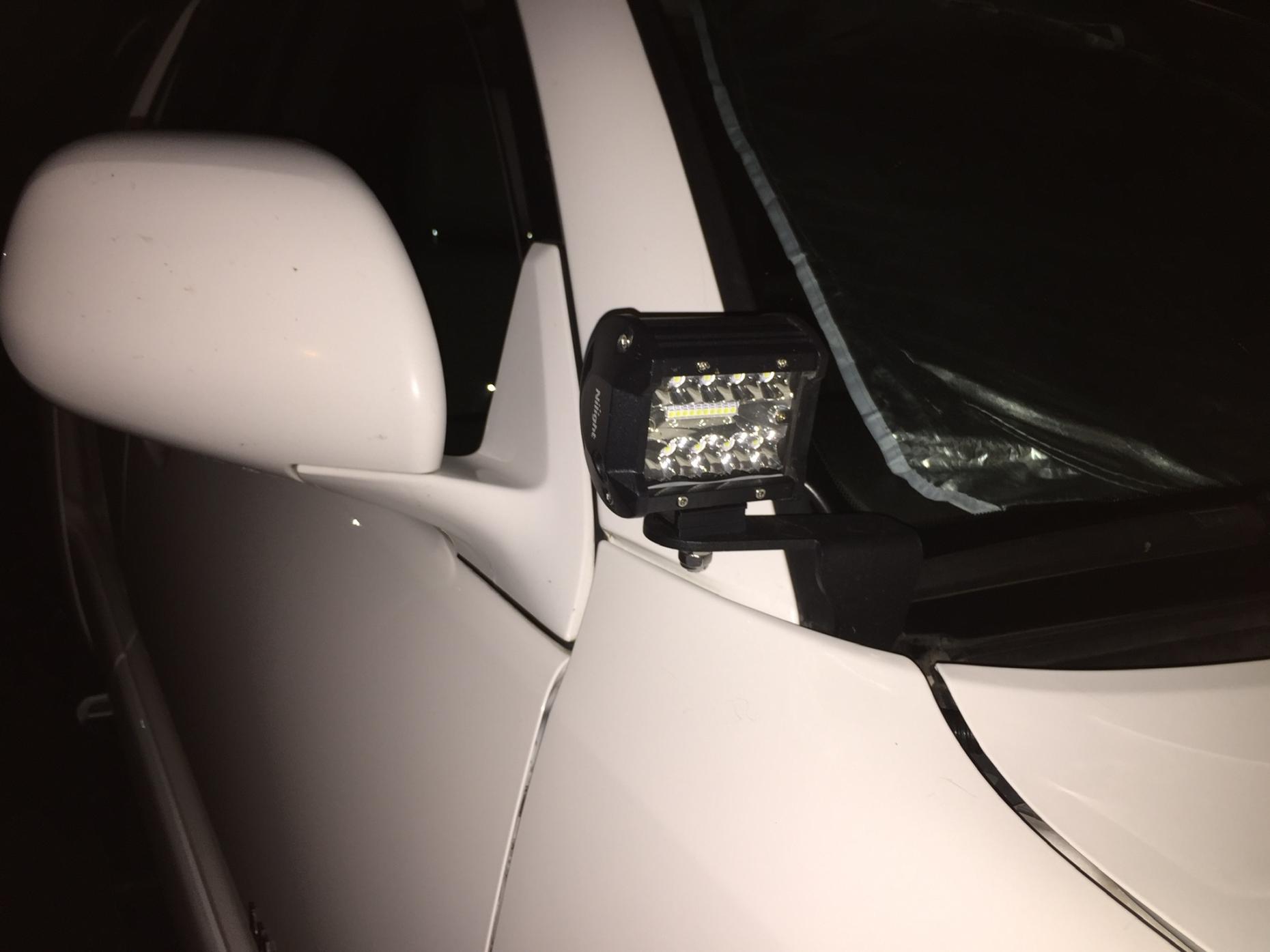

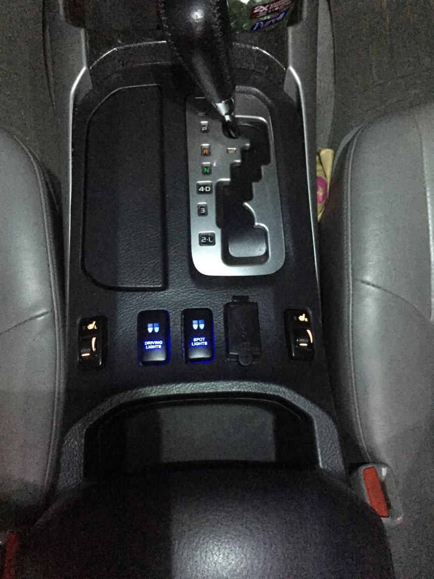

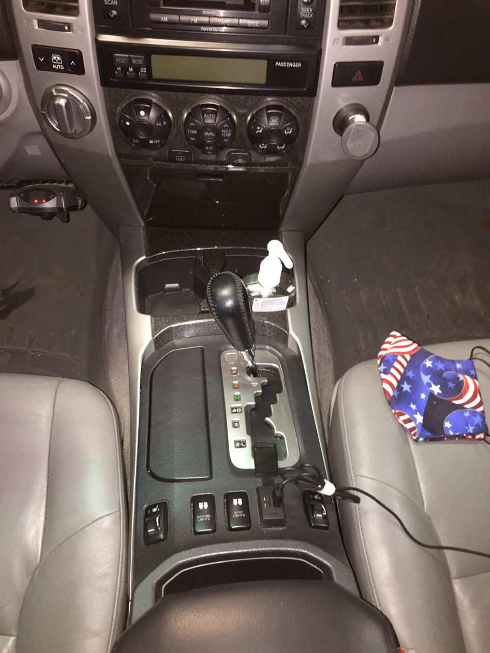

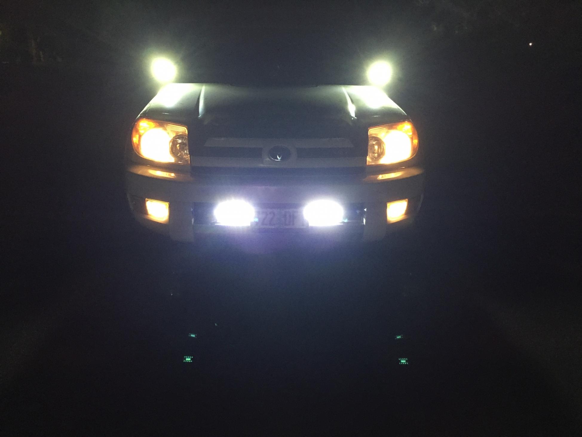

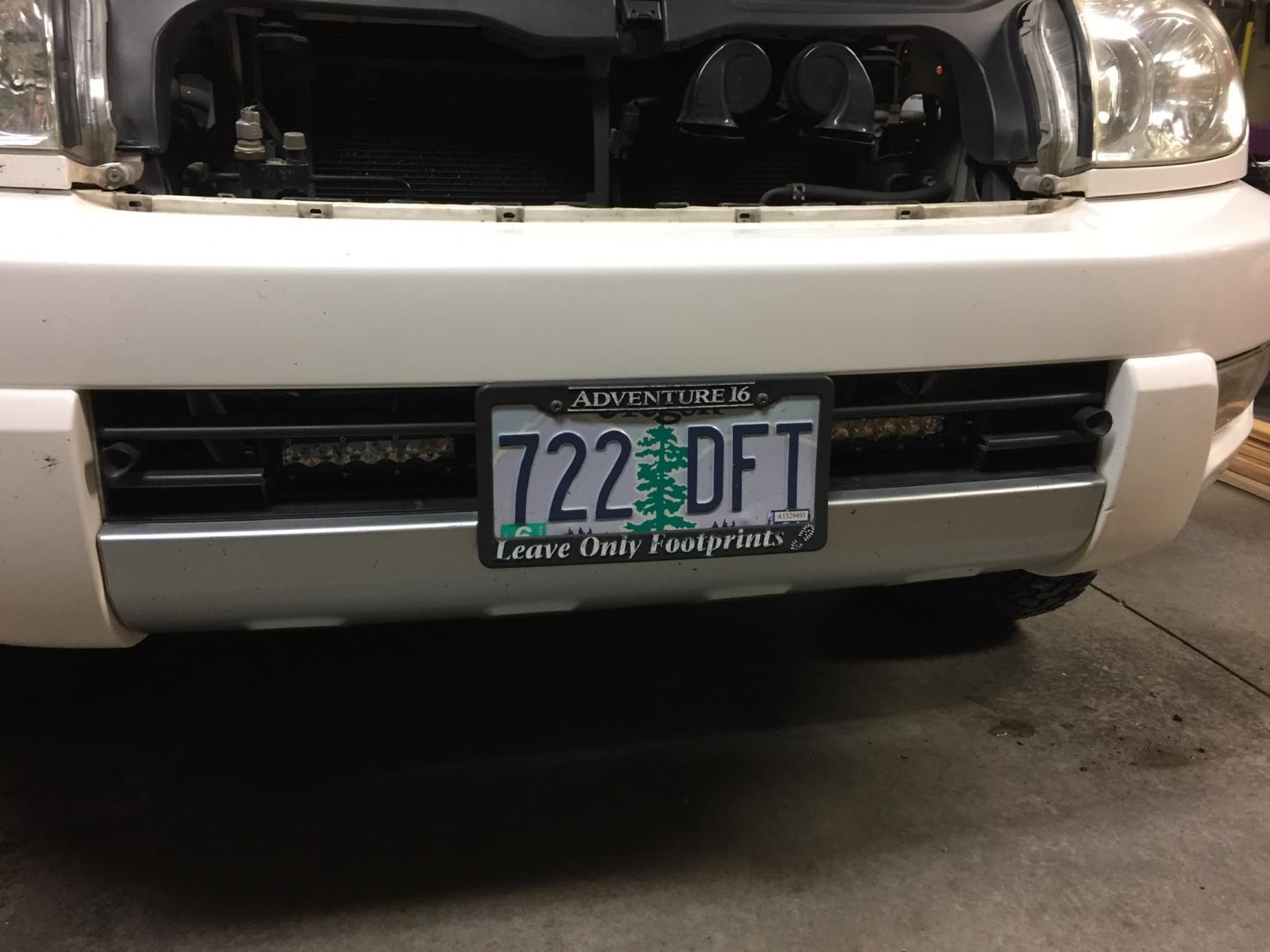

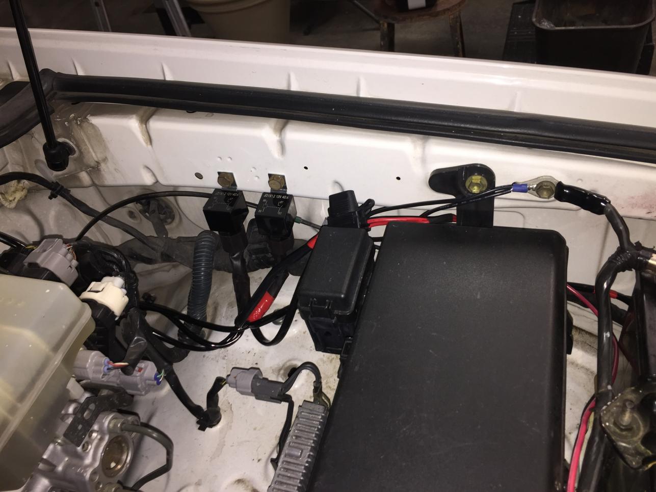

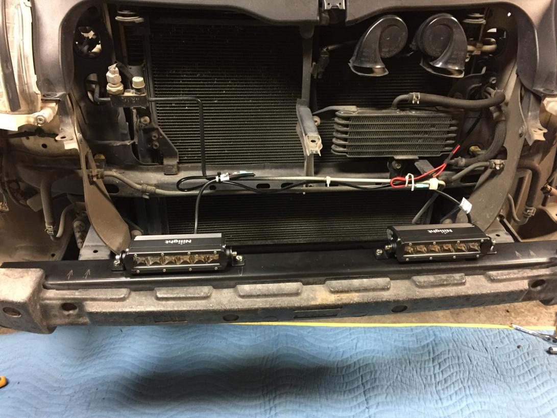

Part 2, continuation of my last self isolation projects post. After getting into the dash and moving the DAC switch I decided I would use the 2 available center console switch locations to add some needed lights. Decided to go with some driving lights I figure I could conceal well and some ditch lights. The CBI ditch light brackets are first class and a well worth purchase. I went with some cost effective NiLights I picked up on Amazon. If these fail I’ll upgrade, but at least the wiring and mounts will be sorted out. I’m using some available threaded bolt holes in the left apron for the relays. And then for the driving lights I was looking for the most secure bolting options. So I added some “nut serts” in the reinforcement. So the most direct and secure mounting I could find. Removed a bit of the bumper grille to allow the light to shine through. Overall very happy with the way it turned out and not a ton of investment, just some time on my part. I think the pictures help tell the story.

Couple additional photos for the last post. Showing the switches, illumination and another view of the ditch lights.
