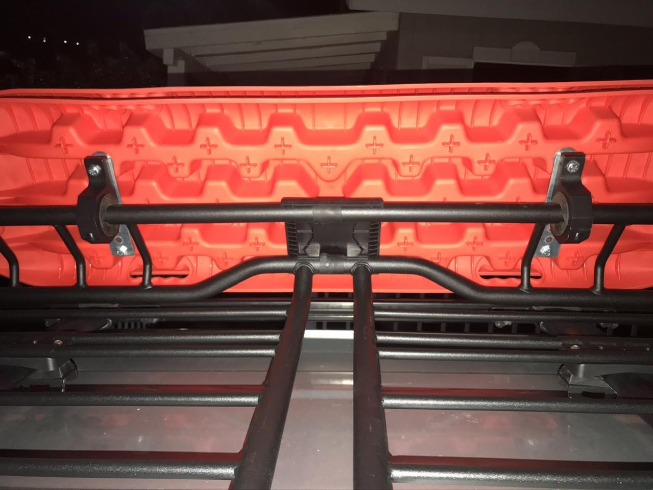

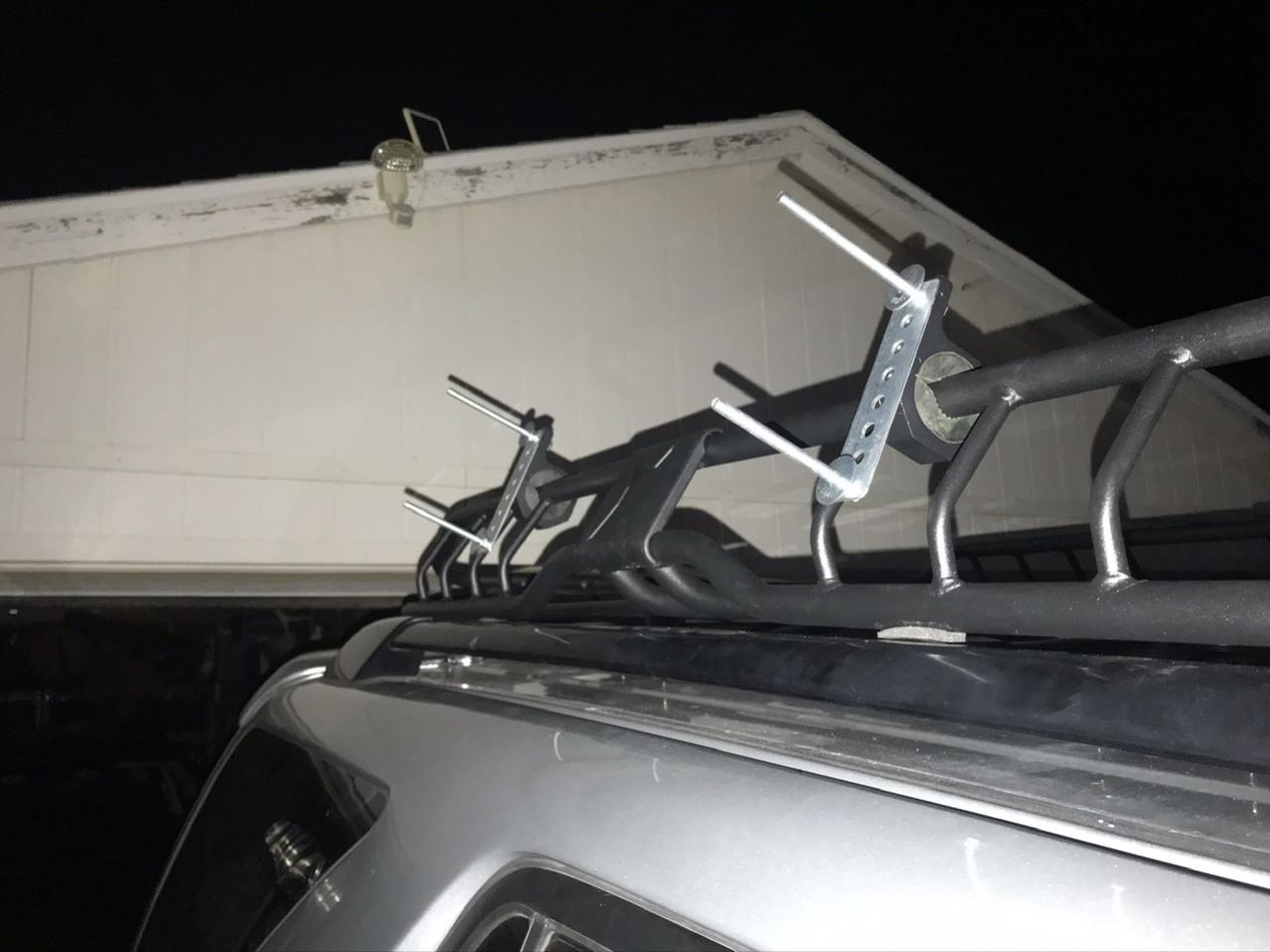

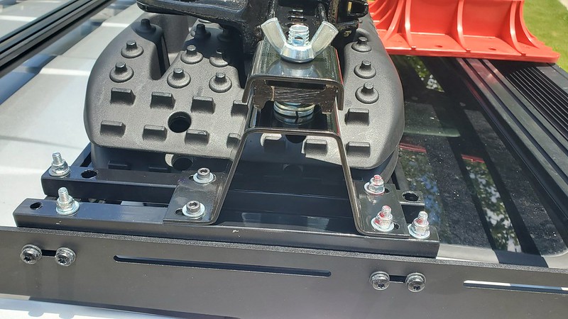

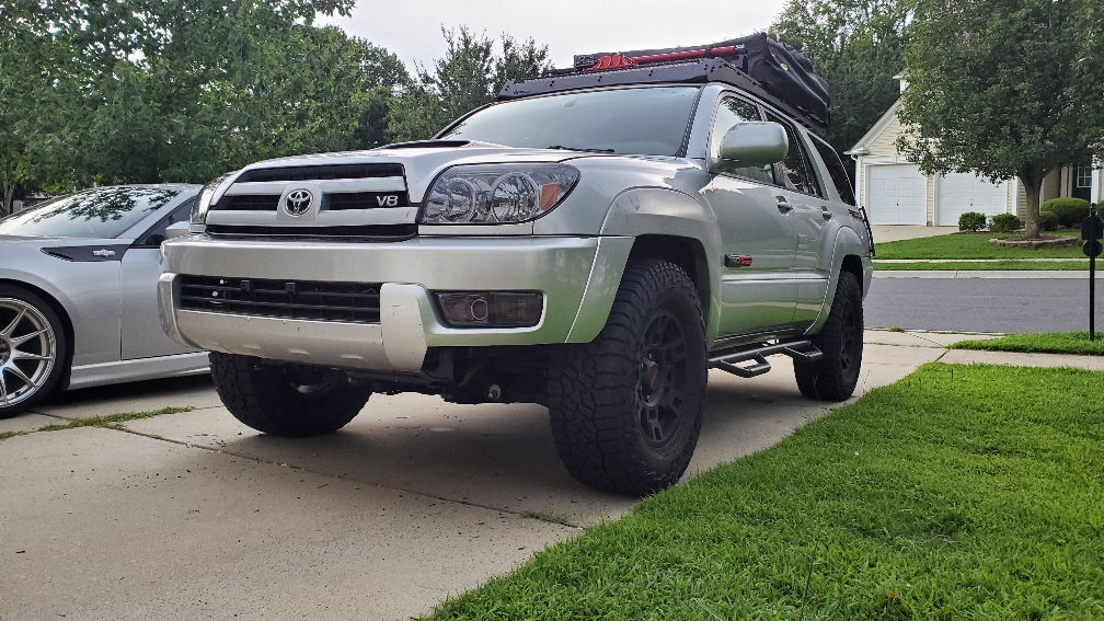

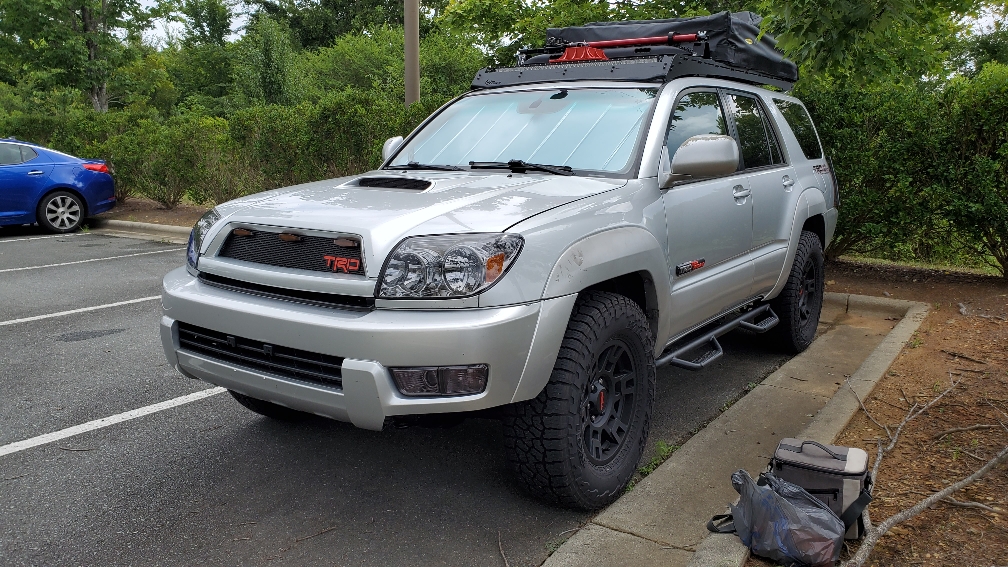

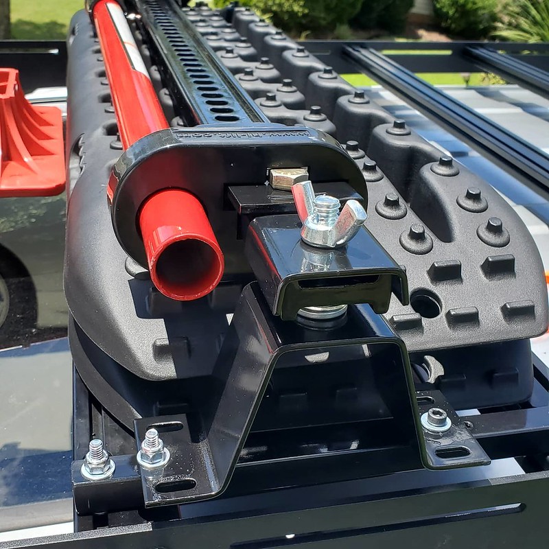

while waiting on the rest of the lift to deliver I decided to tackle the recovery gear mounting on the roof rack.

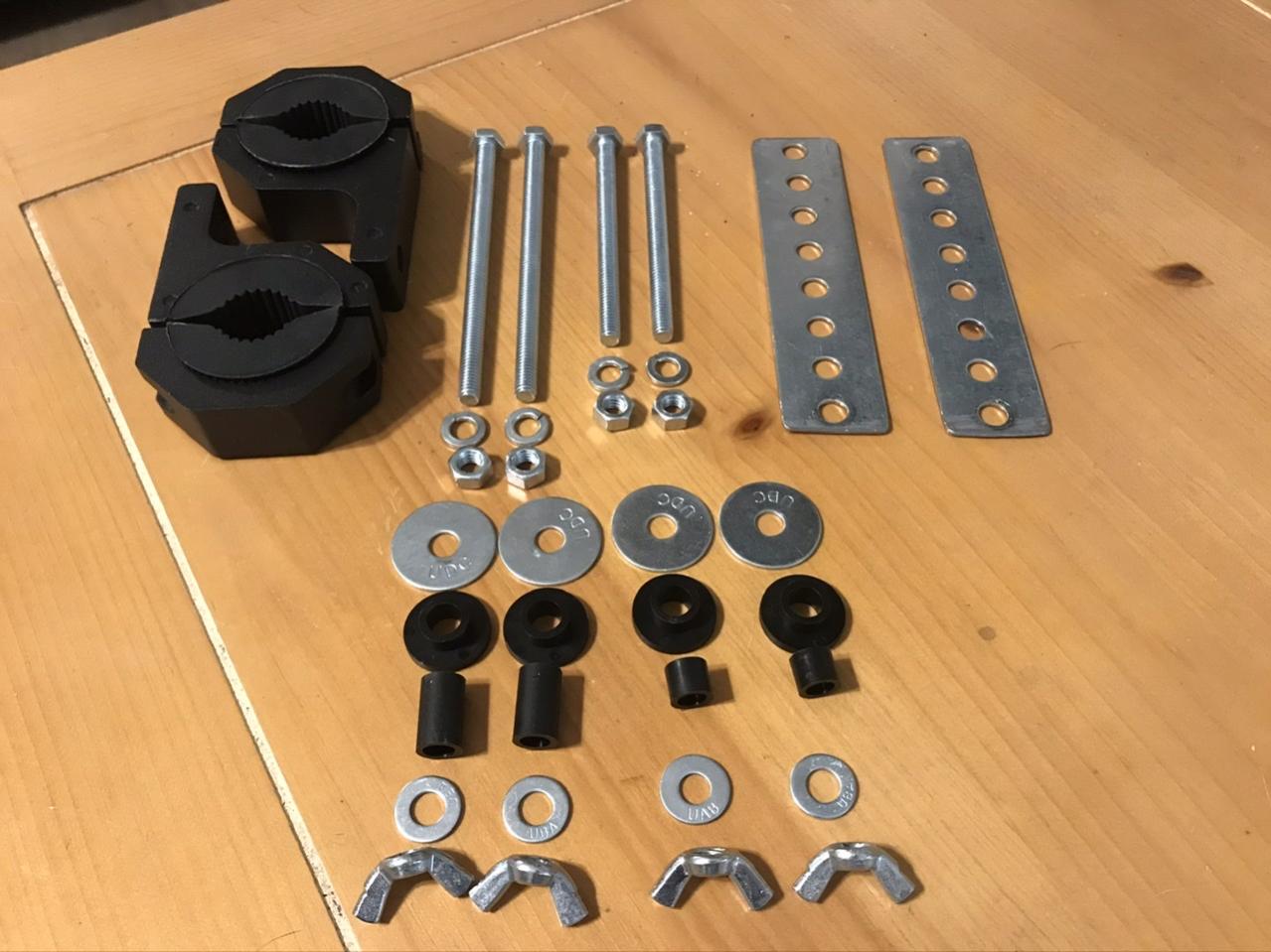

Made some custom stand-off mounts from a steel square tube to mount the Hi-Lift jack mounts in a way that would allow me to use the jack to lock down the traction boards.

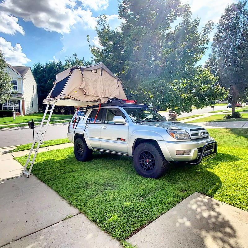

Also somehow managed to manhandle the Smittybilt Overlander tent up on the car by myself to test fit everything.

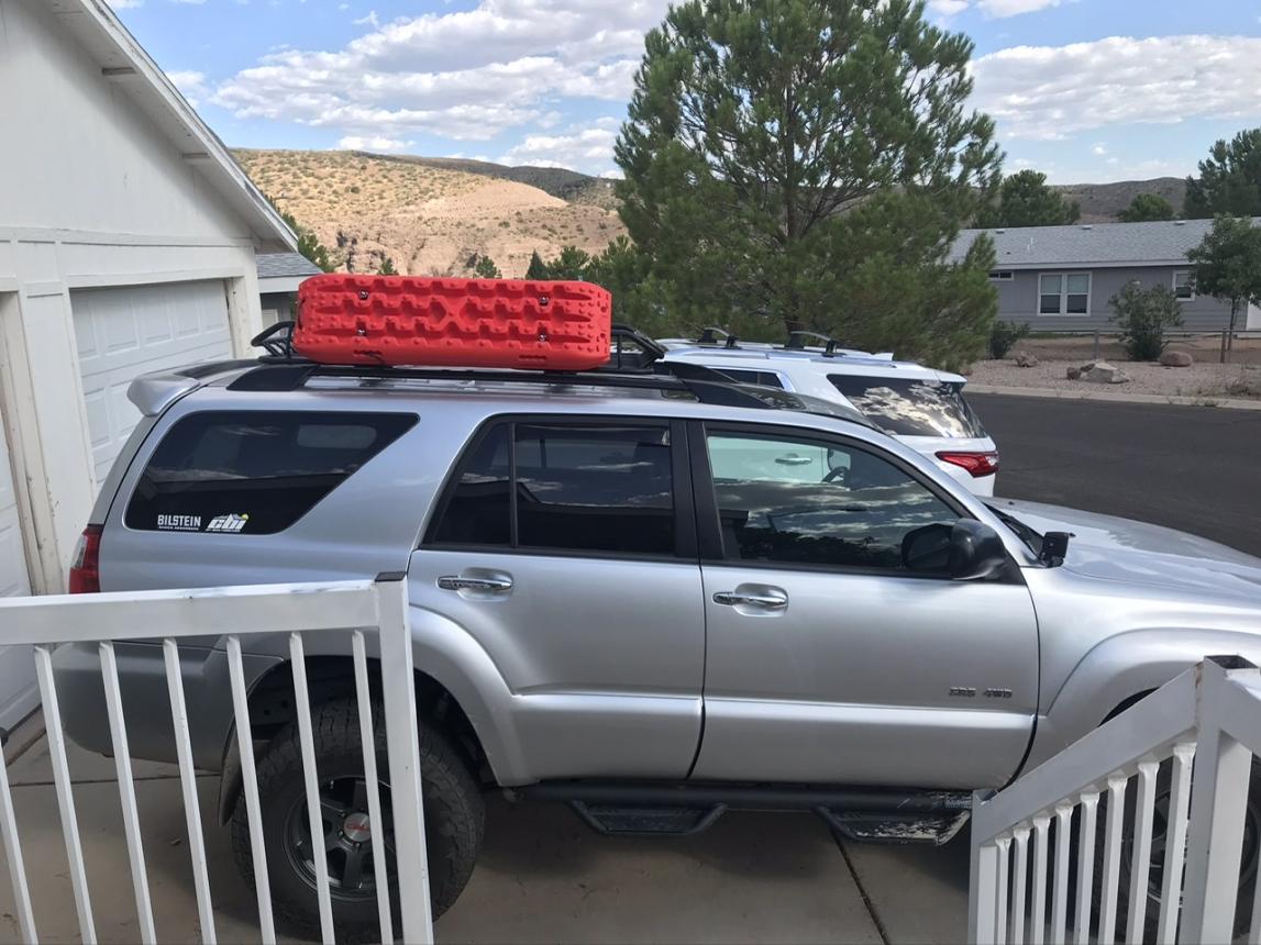

Roof basket and traction board mounts

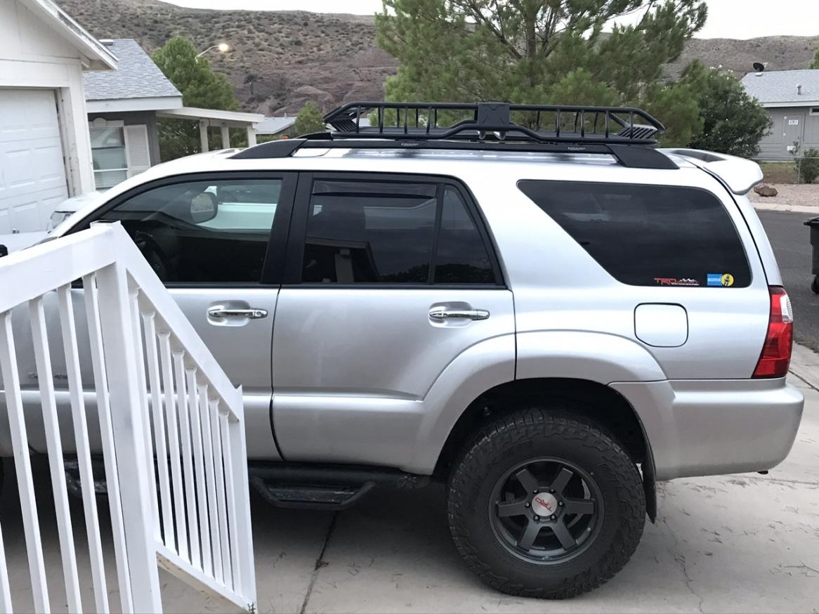

Got my XL Rhino rack roof basket in and put on. This rack will tide me over until I can swing the Victory roof rack and then the Rhino will be used on the Subaru. I made some mounts for my traction boards also. Had some inexpensive Amazon light mounts and went to the local Ace hardware and got some parts to mount them.
I planned on painting them black but hasn’t happened yet lol. May do it next days off. Now that I have the room on top I need to get a full sized matching wheel and tire for a spare.

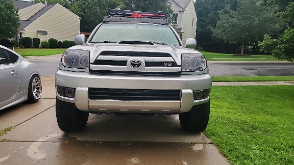

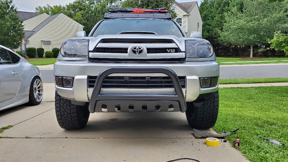

A week after installing my bullbar because I like the way it looks i decided that it was form and function over looks.. i removed the bull bar and also did a light trim on the front bumper in preparation for the lift going on hopefully next week.
Wish a took a bit more time but was weatger and sunlight limited... not 100% perfect but came out half decent and should give some decent clearance under full lock and flex.

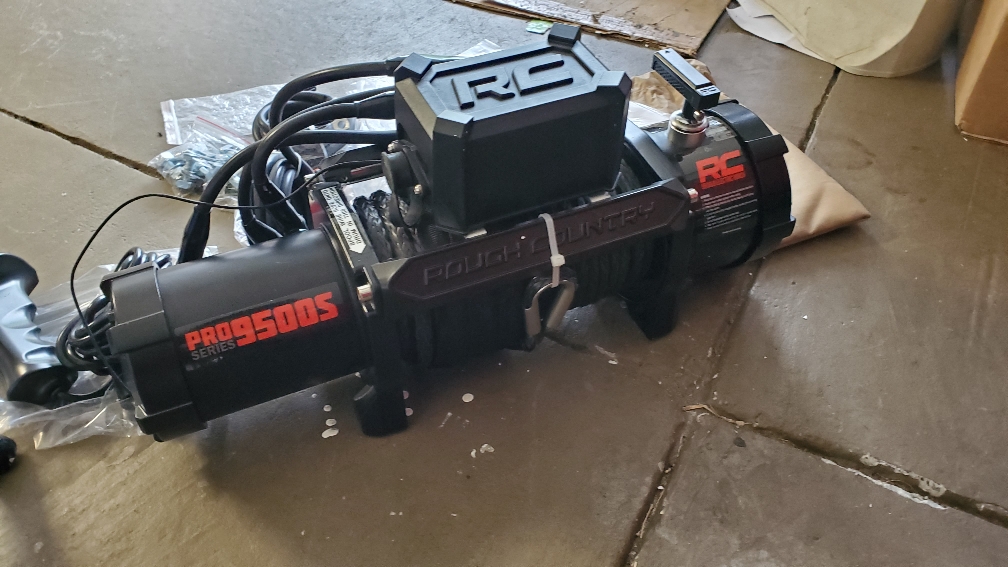

Also... since I really liked the bull bar look I may have a winch-mount bumper on the way... a cheap rough country winch is sitting in the garage already.. luckily the wife didn't see it delhver [emoji23]

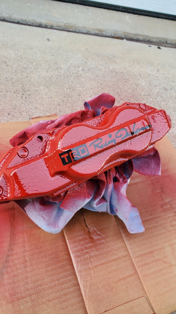

While I was at it I decided to upgrade to the 380mm front brakes, and obviously they need to be red with trd decals to go along with the rest of the theme.

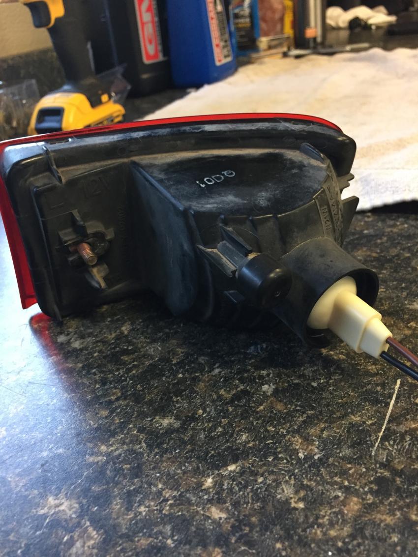

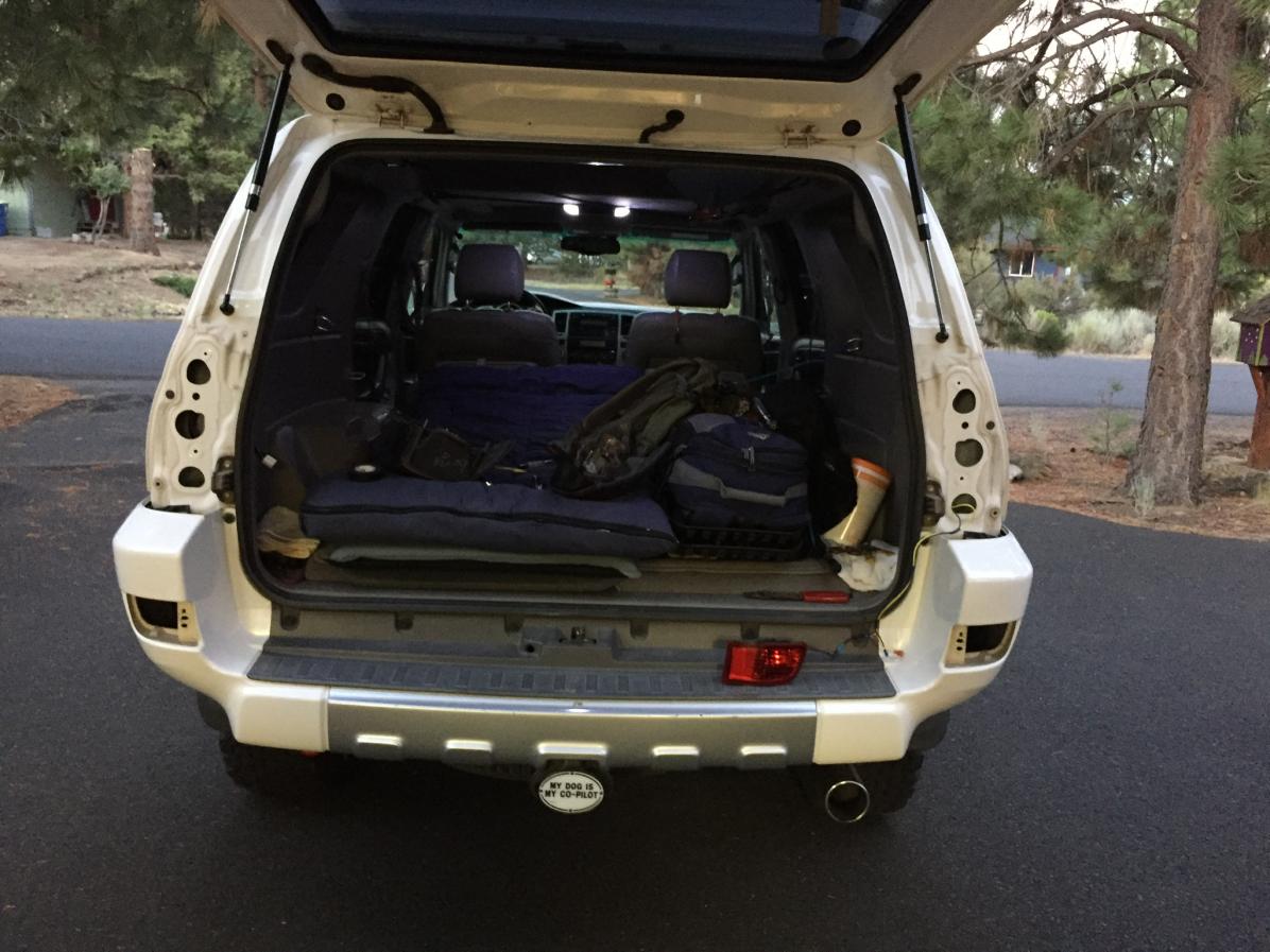

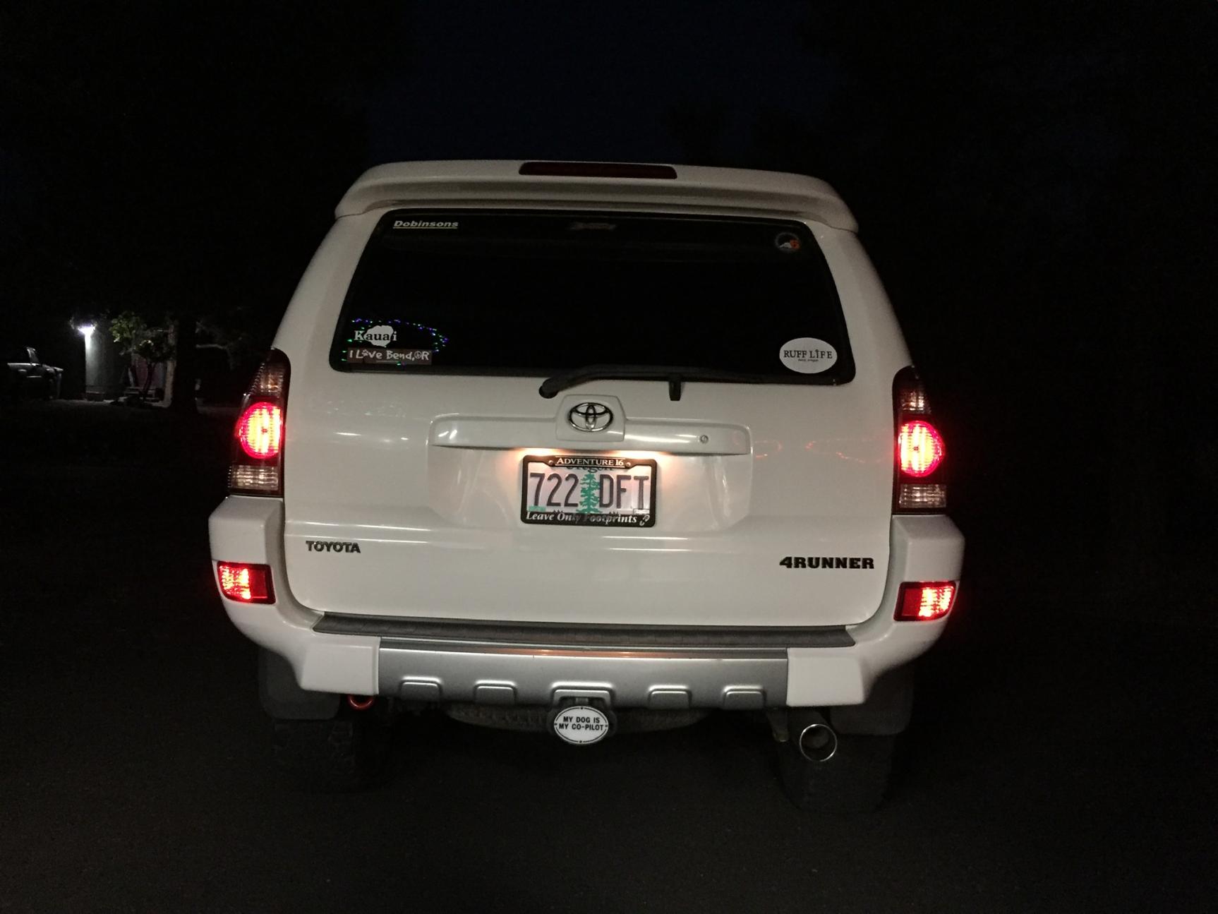

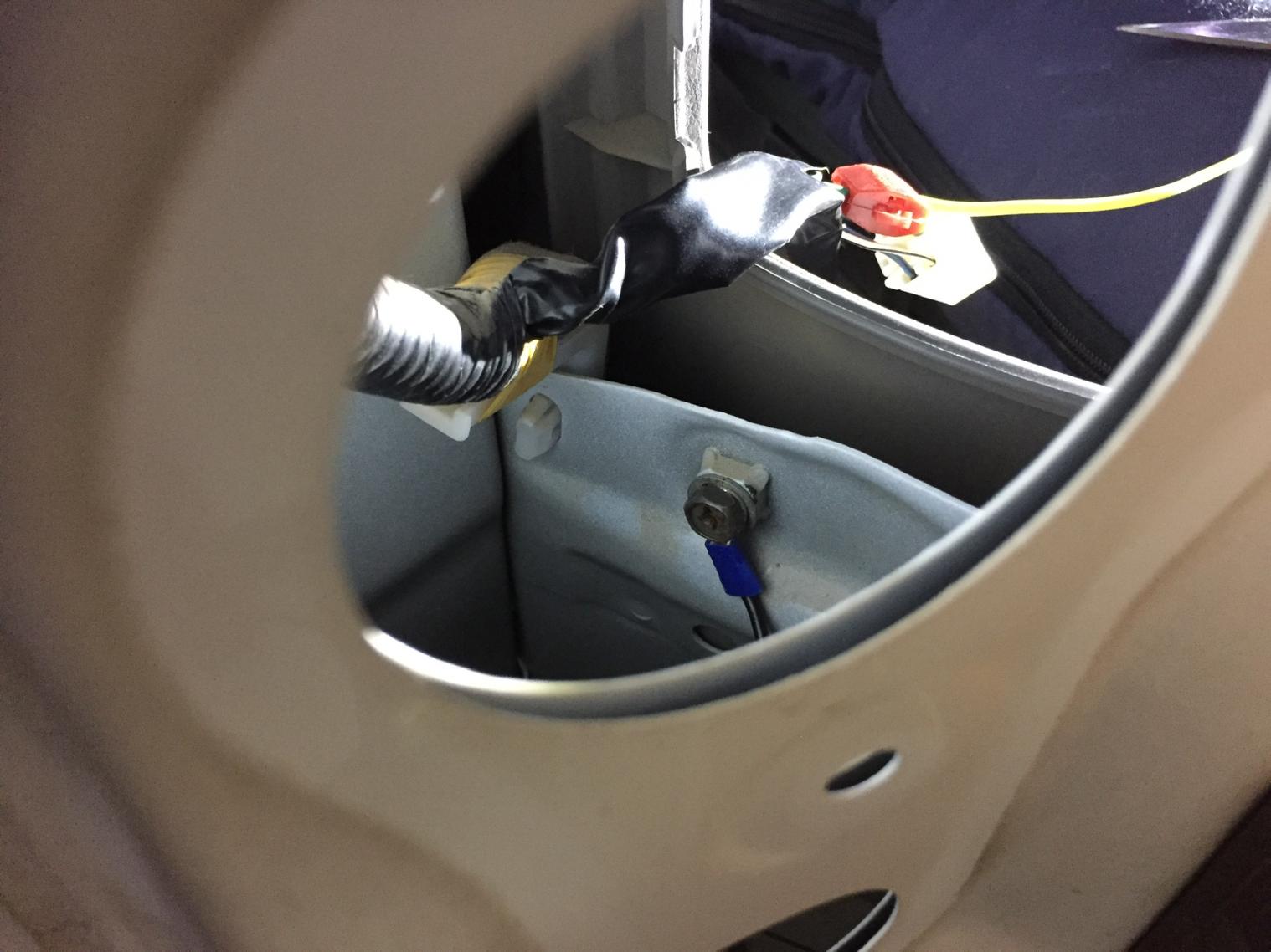

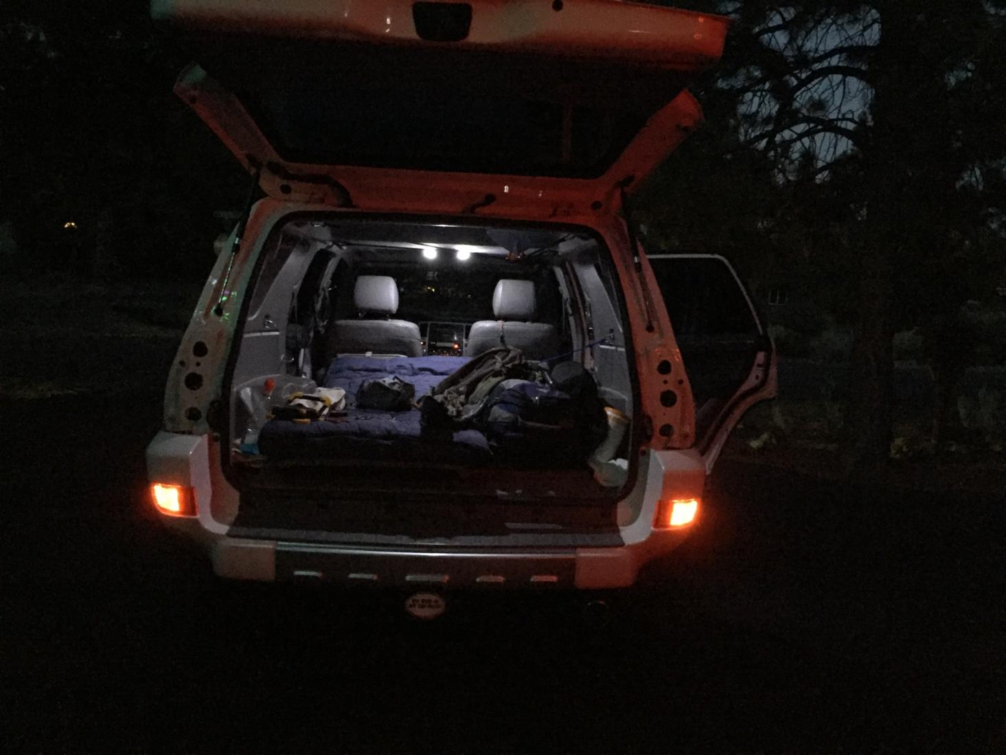

I did the rear bumper red lens with lights upgrade on my 03. Only took me 17 years, and 3 hours tonight to do it.
I went with T10 LED lights in a flexible socket that After trimming the socket, I left bumps in so that it pushes in firmly and the bumps keep it retained. I picked up the sockets at NAPA. My total investment in this upgrade, $9.98.
So with the T10 light they only illuminate as running lights. But I did go to the back of the tail lamp harness to connect, So if I decide to go with brake lights also I’ll just replace the socket and add an additional wire. Also in the photos you’ll see I used a ground that was a welded nut that I bolted too with a star washer.
The light output is similar to the regular running lights (also LED) and overall super happy having some extra tail lamp. Should have done this long ago.
Thanks again to all on this forum for their contributions to make this pretty straight forward for what I wanted to achieve.

I like this, do the stock rear bumper lens really have a a reflector, molded plastic for a bulb, dedicated ground location, and everything? I always assumed it was just a dummy cover. If so that's awesome and I may have to add this to the list of projects.
Yes. The rear bumper lens on the early 4th Gens have a housing with instructions on the back with directions to twist in the bulbs. But here in the US they capped where the bulb went.
I read about this on another post from years ago on this forum. Others did various processes of going into the trailer wiring and adding brake and turn lights. With bigger bulbs that some thought created to much heat in the little housing.
Just need to figure out which wire is power for running lights. I used a test prob and it was a green wire on both sides. When you look at the connector it was the middle of the 3 connectors on the side of the connector with 3. Hope that is clear. I dropped the two wires through the bottom taillamp whole, there is a substantial seal there.
The bumper lens housing is held on with 1 10mm nut.
I’m happy with my more simple approach of just running lights and smaller bulbs. Overall time well spent and a nice mod.

Awesome! I have an 05, so I have them back there. I always assumed it was a dummy lens with nothing really back there. Neat-o that its something I'll have to try, thanks for the tips. I want to learn some more about wiring, so this seems like a good place to start,
Good easy electrical project. If you don’t have one I would get a lighted test prob to verify connections. And then check your work as you go. IE find the power wire you want and check against a ground. Connect your wire and check again. Establish and connect your ground and check it and so on. If there is an issue where the test does not confirm then you know right were to look. Same with the light pig tail. But it in the housing add you connectors and check it against a power source. Make sure it lights.
If you do the whole install and a light doesn’t light up you won’t know where the fault is, will have to potentially go back and check everything.

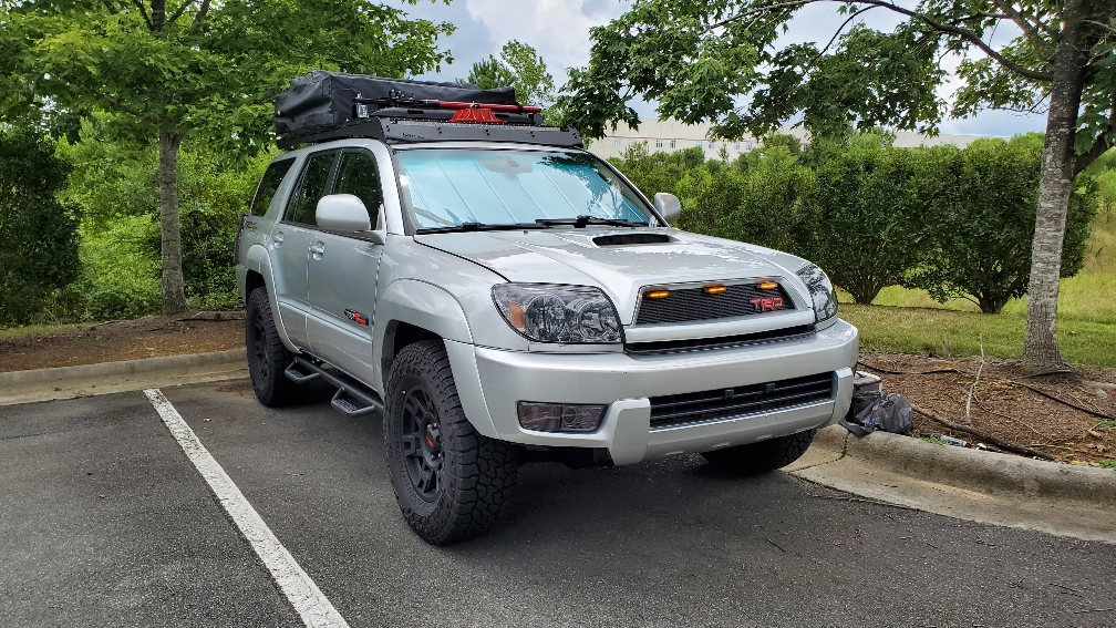

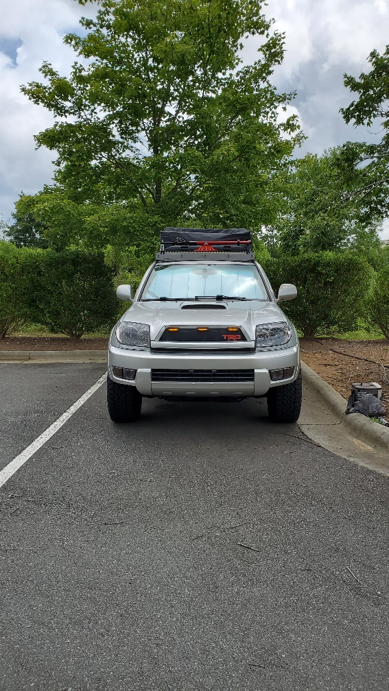

Finally finished my custom grill with raptor lights. Took way more time and work than I anticipated. Not 100 % perfect because I ran out of patience and the leds will probably get switched out soon to a more quality light, but overall came out half decent and goes well with the rest of the trd theme.
