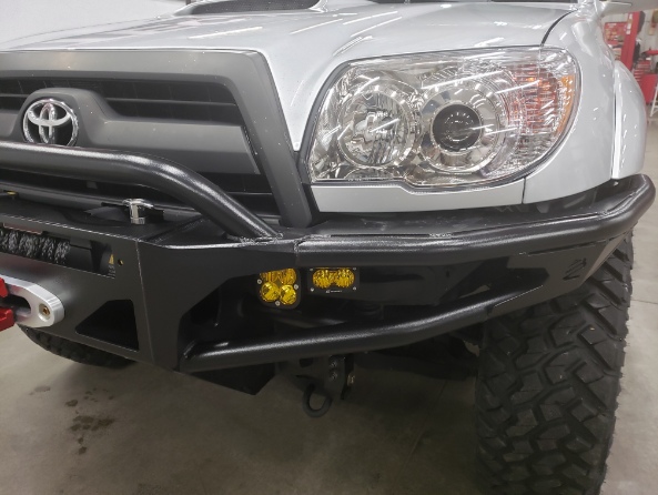

Finished off the bumper and went wheeling for once!

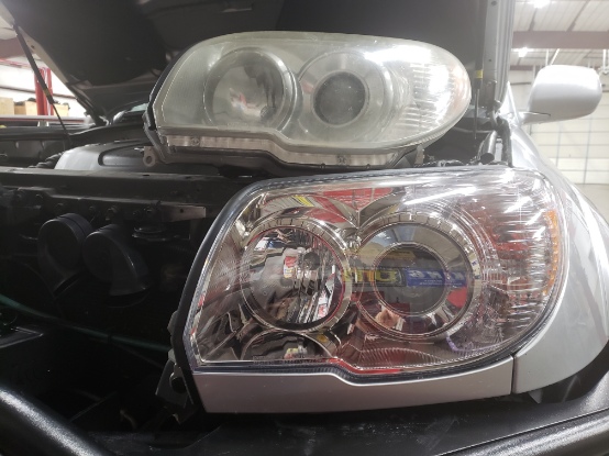

Today replace the old NASTY headlights, wired and fine tuned the Baja Designs Squadron Sport light, still need to wire up the S2 Sport lights.

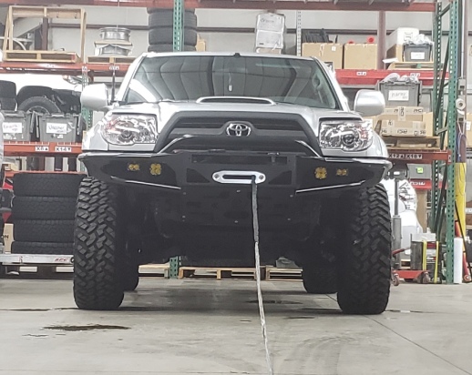

Trimmed down the wheel well liners for a better fit / look on the new bumper and respooled the winch line.
