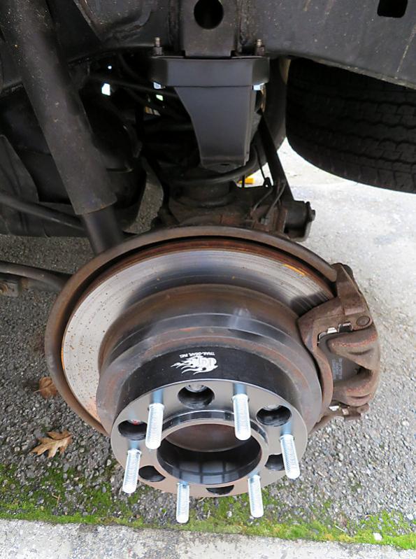

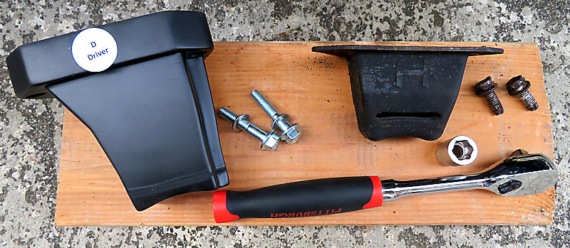

Installed rear DuroBumps and 1.5" TrailGear Spacers today. Sure helps to have the right tools... A new 12mm bolt extraction socket made quick work of the old, soft, rounded bump bolts. The new right angle drill and left-handed bits made quick work of one that snapped in half, still leaving sufficient threads in the OEM welded nut to use. Even a blind squirrel gets a nut once in a while.
Even got to break in a new creeper to satisfyingly rip out the loose, rattling muffler heat shield.
On to the snapped off front bump stop tomorrow.
Get 'er done!
:thumb:
