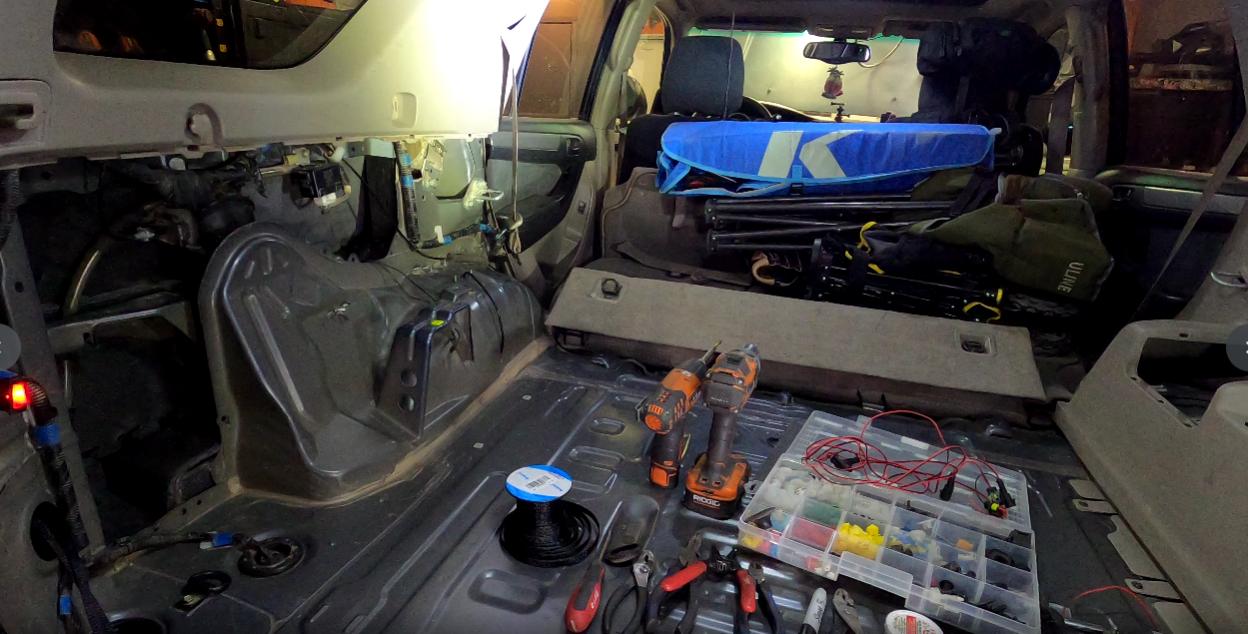

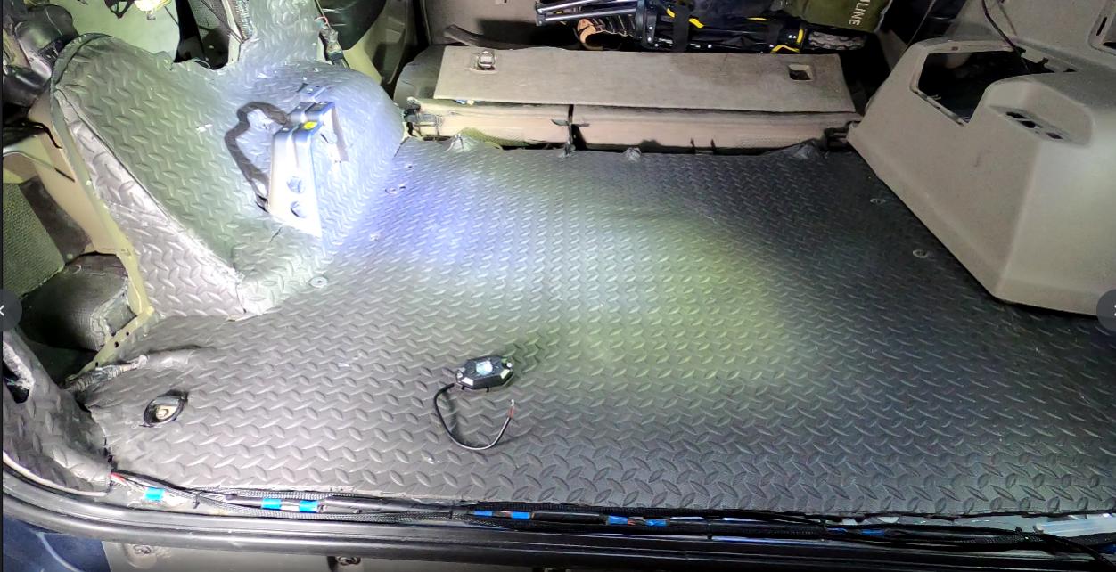

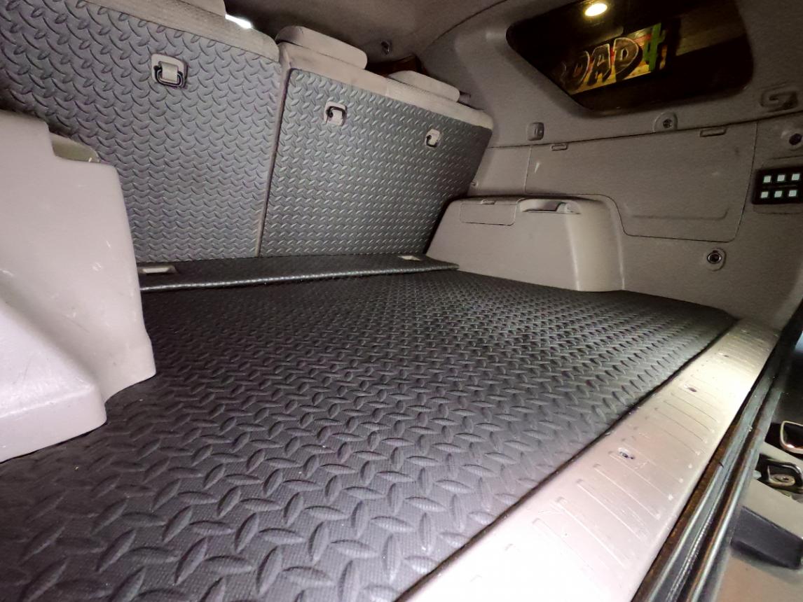

Ripped out the rear cargo interior ..

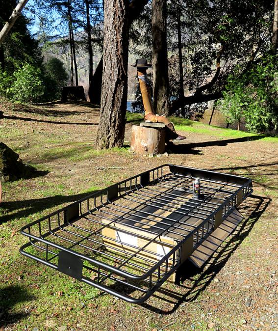

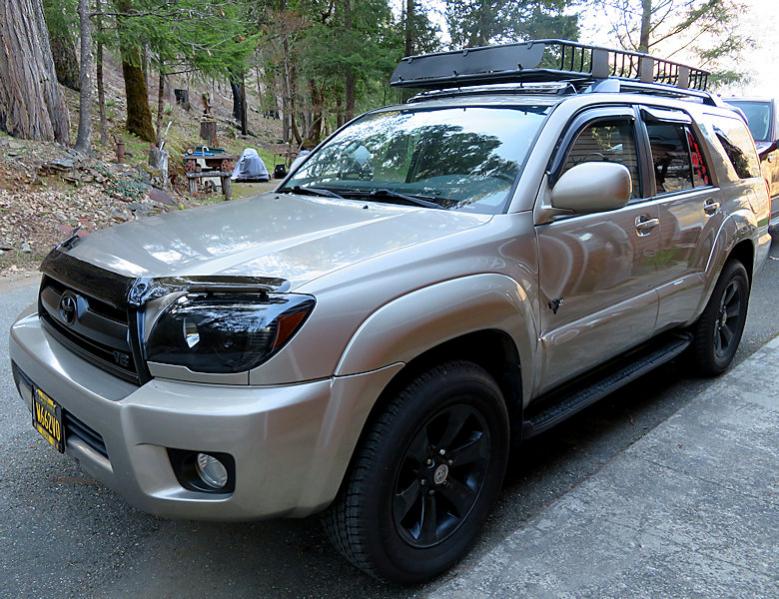

Today was National Cheap-Ass Roof Rack Day, don't ya know... :usa2:
So not to be left out, I put together this $200, 84"Lx39"W Arksen off of EBay. Gave it a couple o' coats of matte black Krylon to cover the branded windscreen, the silver nuts & bolts, and to match my grille, etc. Just needed somethin' quick to keep my hardshell fishin' kayak, inflatable river kayak, and kevlar canoe off the top o' the 4R for this Spring and Summer.
In my defense, the 4R's been guzzling cash like it was money since November.
That's my story and I'm stickin' to it.
:cowboy: :fish2:

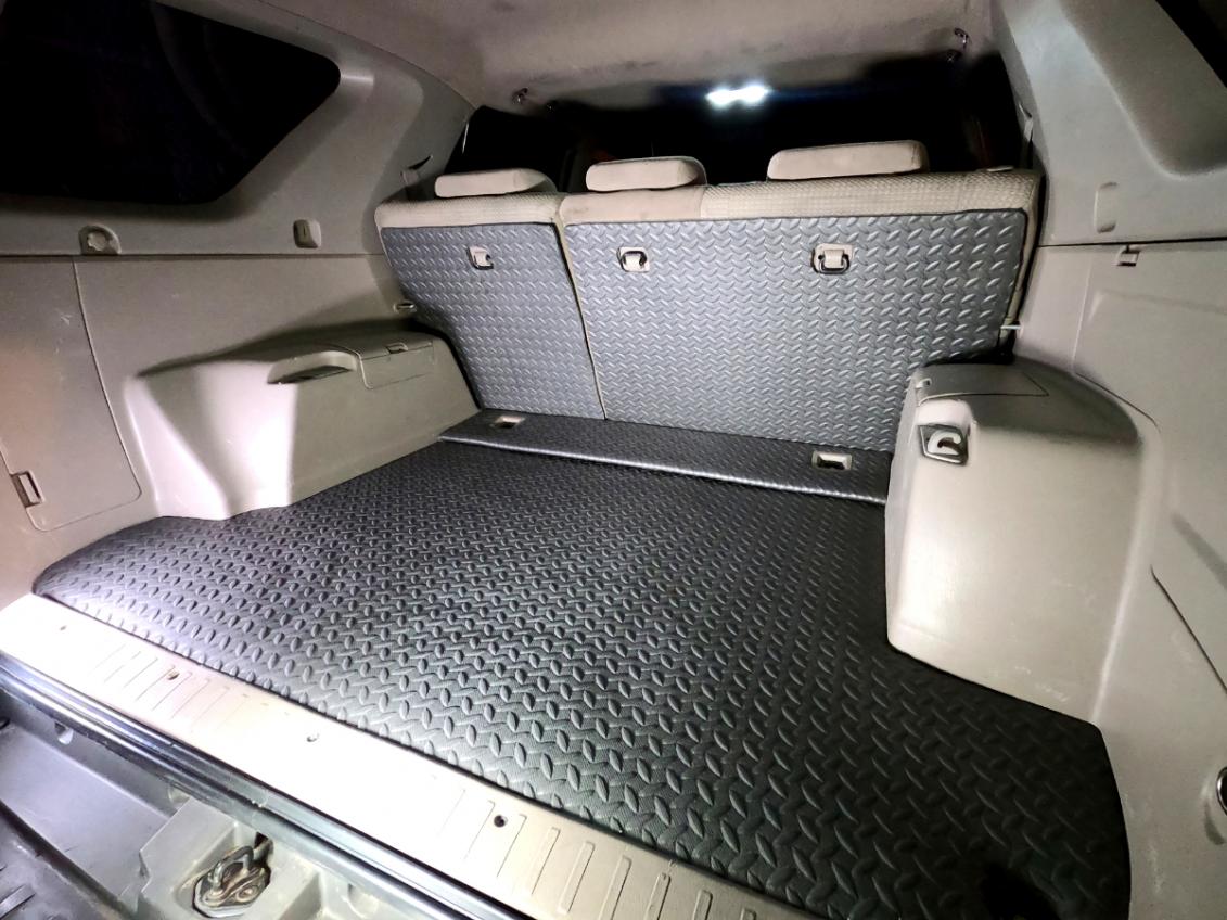

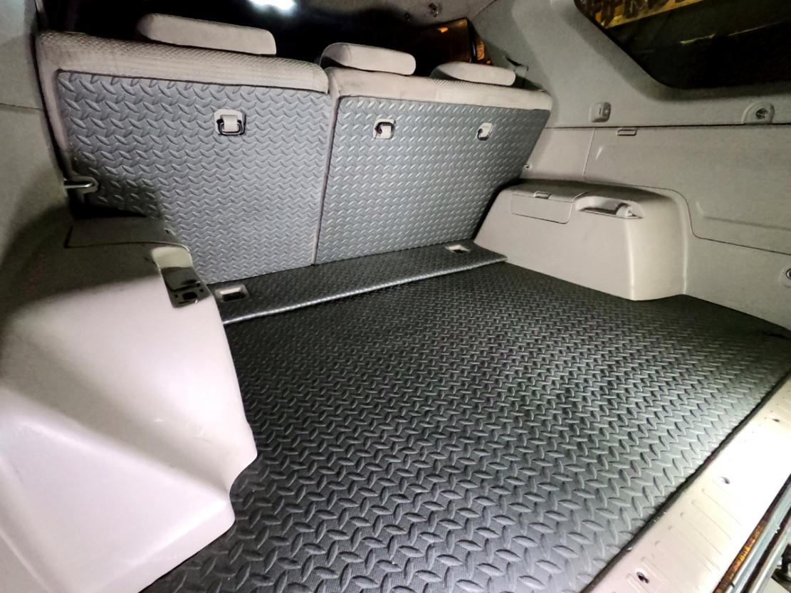

Is that foam/rubber? looks great!
yeah it is... i used 1/4" thick for the bottom layer which goes all the way up into the side panels to the windows then i added a second layer of 1/2" thick to the entire flooring area and topped it off with another layer of the 1/4" finish layer came out very dense ..super super quiet now and easy to clean and maintain cleanliness in the cargo area ..sweep it wipe it and done. spills of liquids and what not have no penetration and no staining. Im sure over time pulling things in and out would wear that layer off eventually but i can just yank the top layer out and replace it at the cost of $20 bucks. Its what is used (in gyms / weight rooms) bought by the roll 96"x48" x2 (1/4") and x1 (1/2")
The rock light(s) is what started the cargo area makeover...which was never part of the original plan until i started wiring up into the wheel wells and adding the 6 gang switch panel to the cargo area ...to discover my carpet was disgusting underneath and the sandbox that was below it ... so then it began!!
So as we speak im continuing with the same flooring all the way up to front no more carpet and all of the nastiness that comes with it along with the sandbox below it. After all the years of vacuuming it and what seemed to be clean and look great ...not so much.
