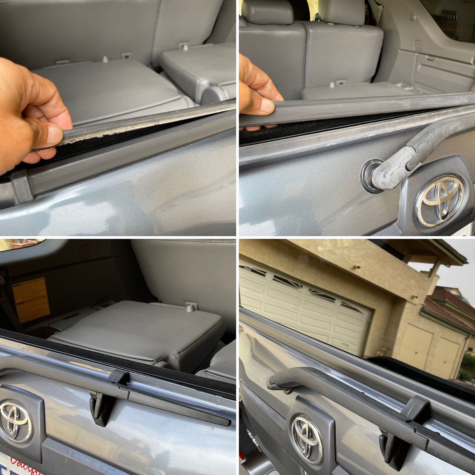

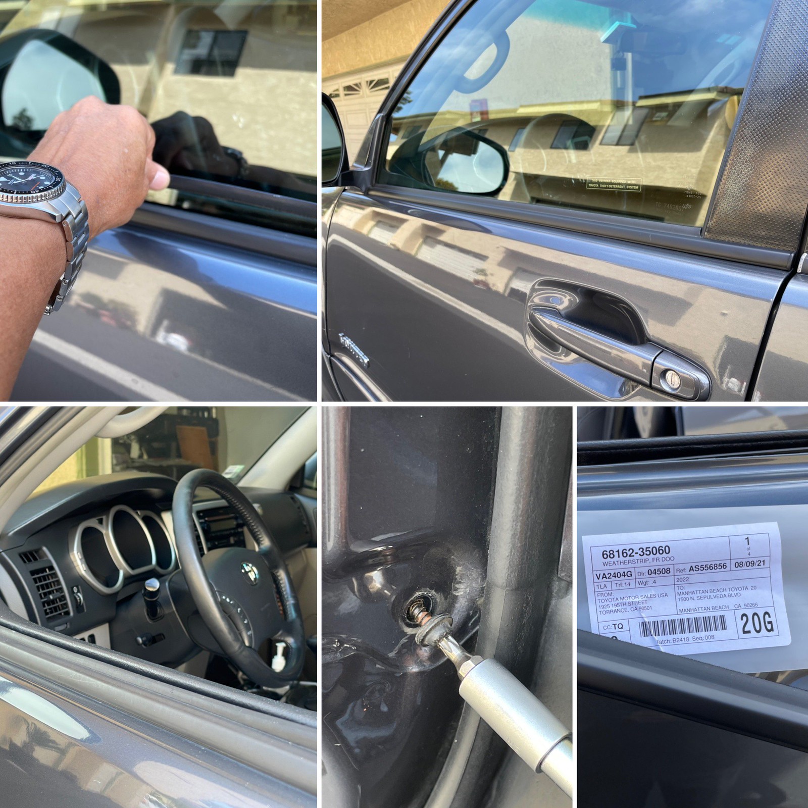

Changed my window weather seal all around - roll down window, snap out old seal, clean, replace new seal. For 4th gen 4Runner, for side windows, there’s a screw you need to unscrew before snapping out the seals. Just in time this coming winter.
Broken side window weather seal replaced with new (part number in photo). Note: for 4th generation 4Runner, there's a screw that holds the seal on the inside of the door.
Untitled by Ramon Flores, on Flickr
Broken rear window weather seal - roll down glass window, snap out old seal, clean, replace new seal, done.
part numbers?

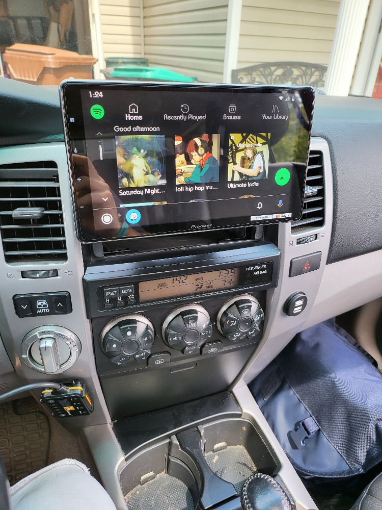

Installed a pioneer DMH-WT7600nex
Loving wireless Android auto but I'm still using the usbC it comes with for the fast charging without having to clog a 12v.
Gonna cnc cut a piece to fit in the 2nd din spot or get a buddy to 3d print a pocket

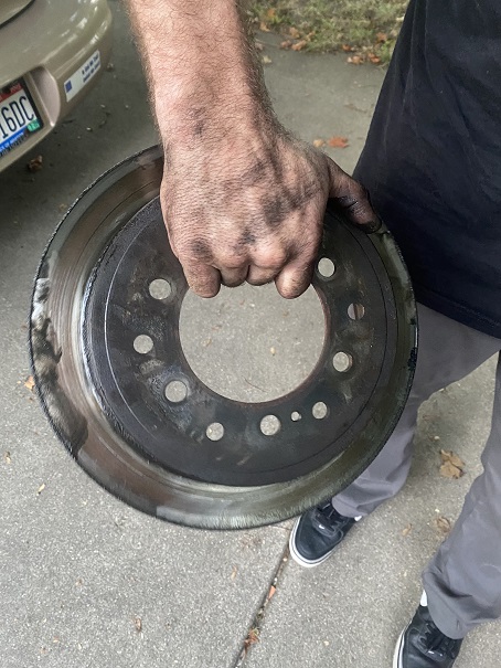

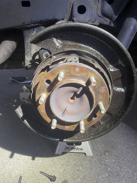

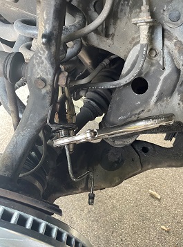

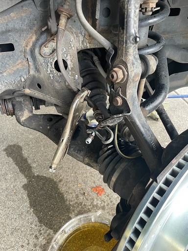

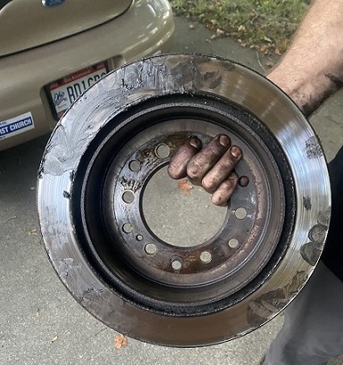

I originally started this quest to simply change rotors and pads all around as the RL pads were sticking & smoking some. No biggie, right?
Famous last words..
FL - frozen & hard line
FR - hard line - cracked & started leaking AS I REMOVED THE CALIPER!
RL - pads sticking & smoking
RR - completely soaked in diff fluid. Bad rear axle seal.
I haven't tallied the damage yet, but it's at least $500 easy as I got nice rotors & pads, front calipers & lines, grease, diff fluid, grease gun & grease, seal removal tool, and some other misc things I didn't have as I've been a bit of a nomad the last year.
Definitely be sure to know which size front rotors you have, that would have saved me 2 days :doh:

what is the depth setting you have, is it fully extended out or just sunken in stock setting, still debating if i should get the 8600 model. i did the print out and it looks fine.

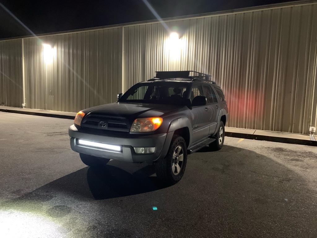

Finally mounted my light bar. Cut out the lower portion of the grill to hide it somewhat.
Next thing I’m gonna do is new rims and bigger tires. Possibly a little more lift as well. Anyone have any good ideas currently I’m running 5100s with 5th gen coils.

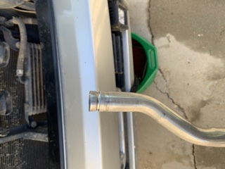

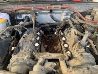

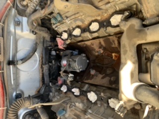

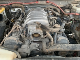

I replaced the starter on my 2UZ and it wasn’t as bad as it looked honestly. The intake was off in less then an hour. I got the bypass joint out of the way no problem. And of course the dealer gave me the wrong O-ring for water bypass pipe sub assy…and the closest dealer is about an hour away. Pretty tough to get to when your intake is off…other then that things went smoothly and she LIVES again!!
I need to replace the pesky bypass pipe O-ring on mine since it’s leaking but I’m thinking of doing the starter too. I don’t need a starter but I don’t want to be taking it back apart again in the near future.
Mine was also leaking but my starter was going bad. You could here the solenoid click on there would be a delay and sometimes she’d start most time the solenoid would just click back off. So I wanted to make sure both got done while I was in there.
