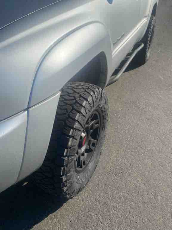

Christmas gift to myself.
New tires, spacers, sliders, radiator, lower control arms, and tie rod ends.
Maxxis razr at LT285/70/17
Spidertrax 1.25”
Calioffroad trail sliders
Denso radiator
OEM LCA and tie rod ends

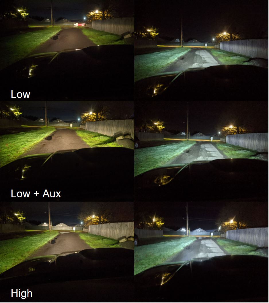

I changed my headlights to Sealight LEDs. This was a bundle off Amazon that included the Scoparc S1 hi/low and aux bulbs for $66. Pics are a comparison to 1 year old Sylvania SilverStars. They don't seem to be any brighter, just a different color. It is interesting which features get highlighted at different temps.

Those of ya’ll that have the spidertrax 1.25” spacers and run them on the front have you had any issues with wheel bearings or ball joints? I’d like to get me a pair. I believe that the trd wheels will widen the stance by 1” total (half inch each side) but 1.25” is a lot more of a lever on the front knuckle.
Been running Methods with 1.5" spacers up front for 40k miles without issues. If you get good bearings and torque them to spec, they should hold up just fine.

Ya, previously I had on 285/70 KO2s and only just recently put on the 305s but still haven't had issues.
What load range are you using? I will be bumping up to the 285/70/17 just like you had but am hesitant to go up in load range because the tires get heavy fast and being that i drive 86 miles a day minimum, I don’t want to cut MPG down.
It'll be no different than running lower offset wheels. Little more wear, but nothing crazy.
E range on the 285s and 305s. They are heavier for sure but the V8 handles them fine. The lower highway RPM might actually get better mpg haha
