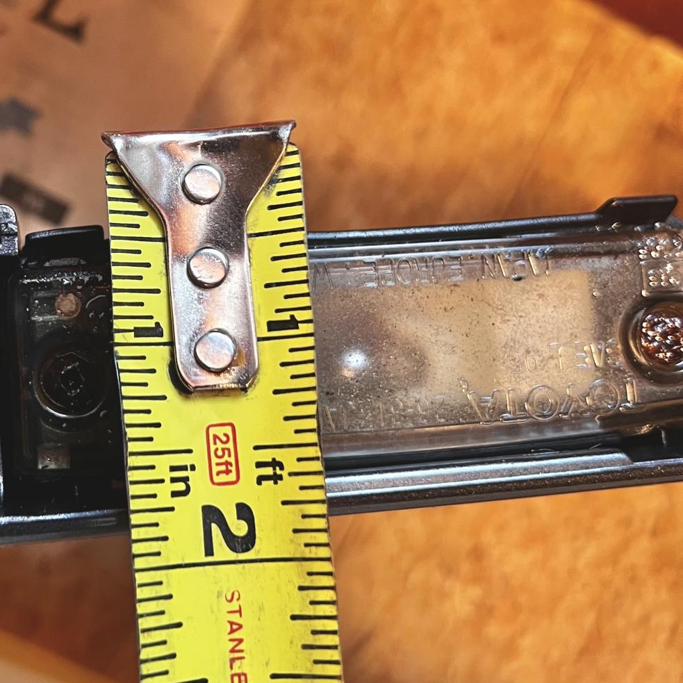

Thought I had a turn signal out due to hyperflash, then saw a suggestion on the forum to be sure the bulb was seated. It had worked a little loose and re-installing it solved the problem. In the process, I rediscovered that Toyota thoughtfully provided bulb specifications near the housings. This example covers the headlights:
And this is for the turn signals/DRL & parking lamps (top line is partially scraped, it says 1156NA):
I think the same info is present in the back as well but I didn't take pics.

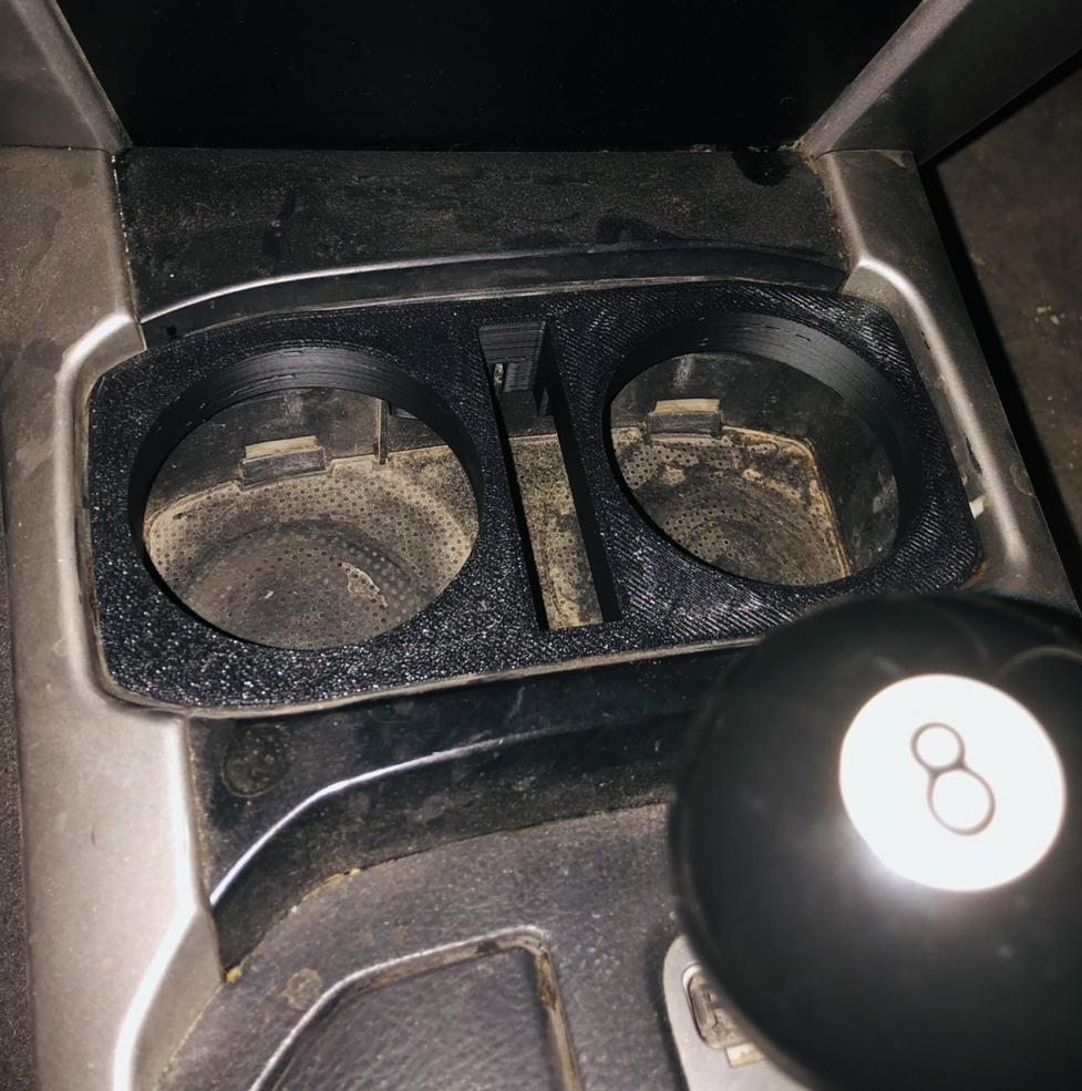

Got this yesterday but had a chance to road test this cup holder insert today on a short drive to and from the park and ride.

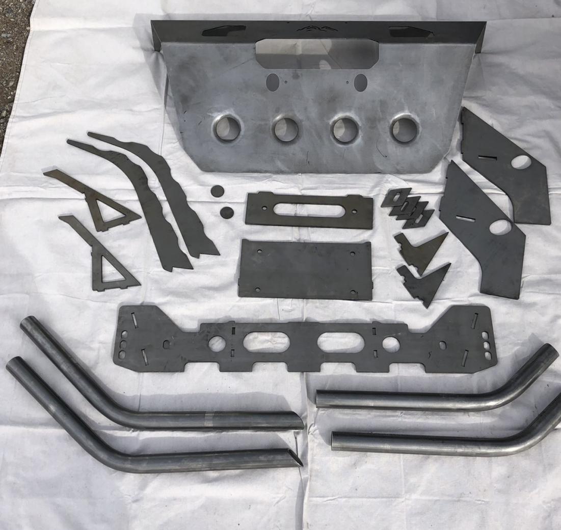

Also got to un-box my weld together bumper kit from True North Fabrications that was on my porch when I got home today.

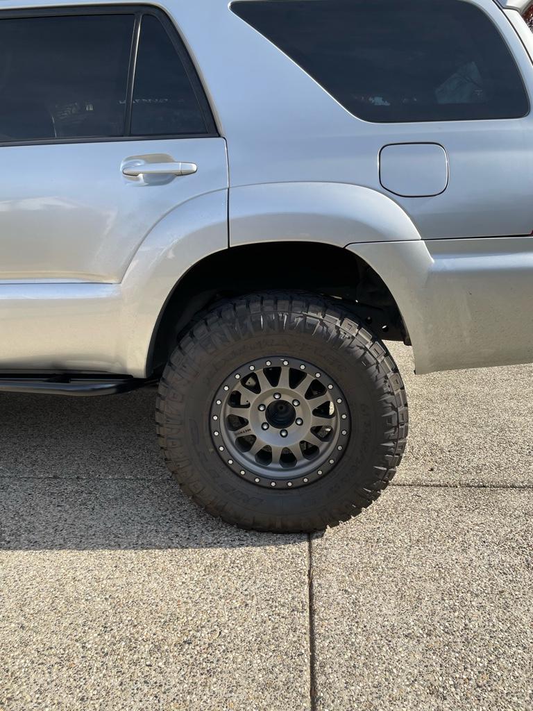

305s rubbed the rear bumper cover so I decided to do some trimming today. Took a template of the front of the fender well and copied it to the rear section, much better!

Also got to un-box my weld together bumper kit from True North/SRQ that was on my porch when I got home today.
What bumper did you get? I’m trying to figure out what I want to do for a front bumper.

I went with the True North Fabrications DIY kit. I was originally going to get the Coastal Off-road kit but their price went up when the True North kit went on Black Friday sale. Hopefully I can get this put together soon as I’m working 50-60 hour weeks for a little while longer.

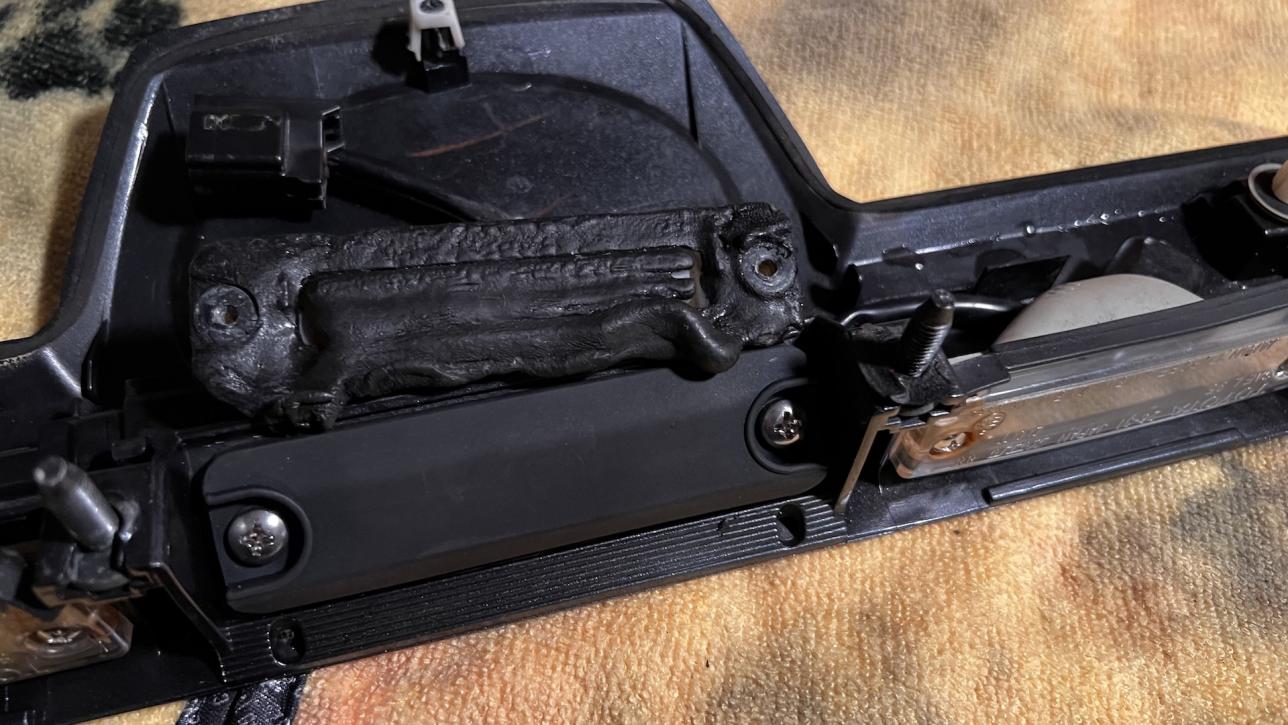

New to me 08 Limited 4WD. First thing I had to fix is the rear hatch release button. Mine was absolutely melted away and now with subzero temps it was basically unusable. The screws for the button and as well for the license plate lights were all rusted out and stripped. See second pic...
Hit em with the wd40 and then extracted them and replaced with all new stainless hardware. I know when I eventually go to replace the license plate bulbs I'll be glad I did this when it was off the truck. Plus it looks way better and the button is back to normal now.
