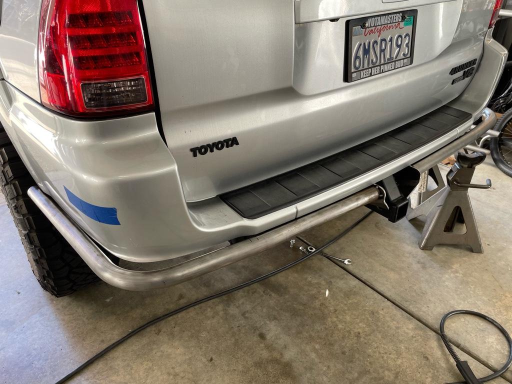

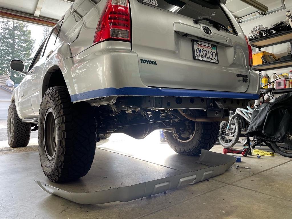

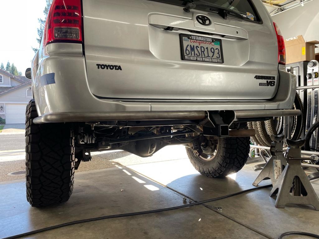

Prepping for the tube rear bumper [emoji1873]
about to do something similar. my appointment is on the 11th of next month! I was thinking of doing some small loops on the sides of the bumper maybe.
Yup that's what I'm doing too, small hoops on the sides, simple round tube all the way around.
nice man! post a pic when you get it done and i'll do the same. I also have some baja s1 flush mounts that i'll install while he has the bumper off. right under that flat line on the rear bumper.

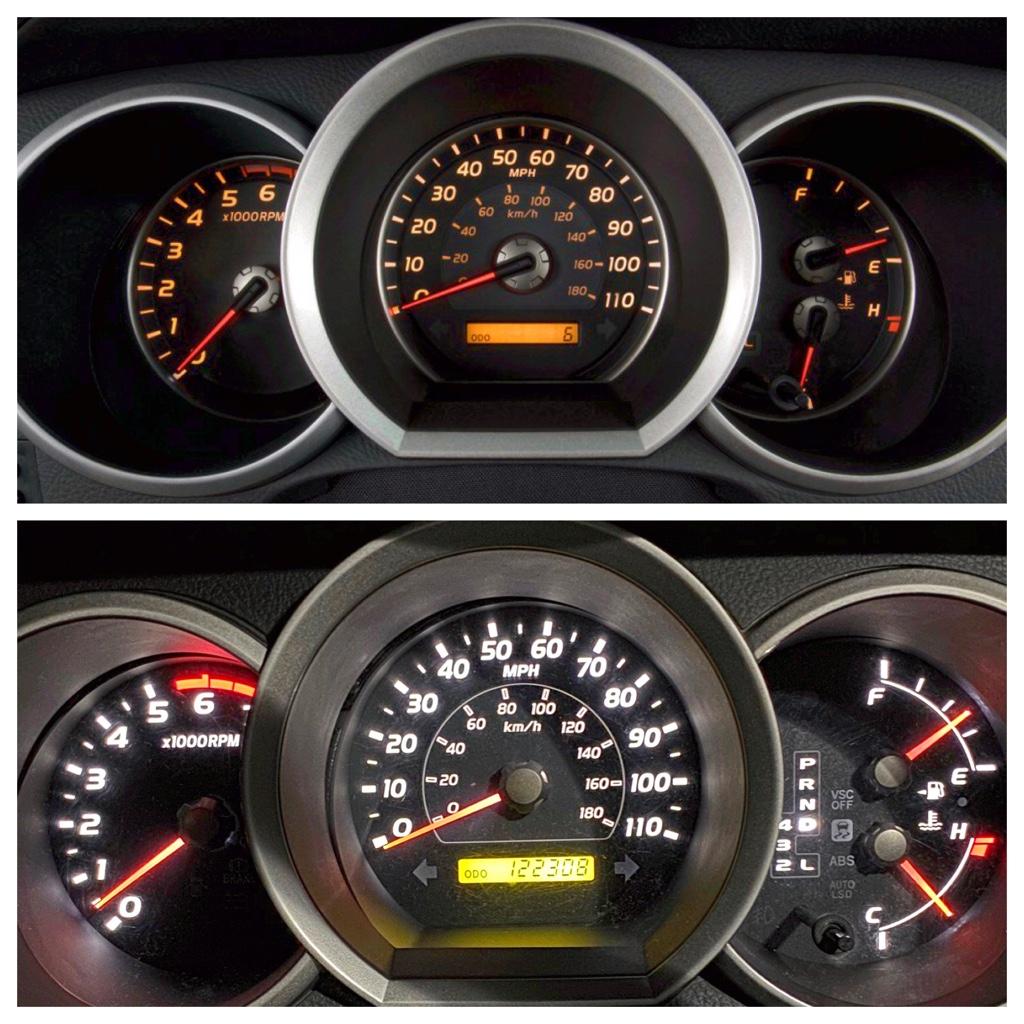

Upgraded the dash cluster LEDs to give a more modern look.
Before/After
I added a little white chalk over the odometer bulbs hoping to dim those down a little. That did work but it also made it a little yellower in hue. Which isn’t bothering me.

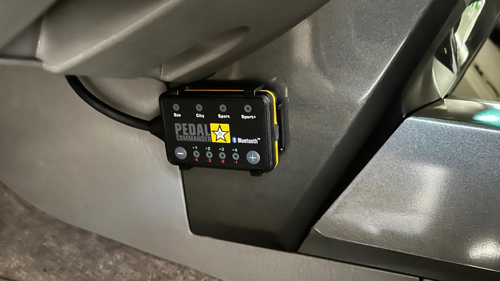

Added the Pedal Commander. Driving it in Sport 3 and loving it. 4Runner feels so much more responsive when hitting the throttle and it has greatly improved the driving experience.

I have been looking at doing this myself, I’m assuming the LEDs were unable to dim via the dash control? Was it too bright?
I was worried i would lose the dimming feature too and much to my surprise they are still dimmable just like before. I was even more shocked to learn that the original bulbs are also LED, just amber hue instead of white.
They are def brighter than the stock bulbs but I wouldnt say its distracting, since it can still be dimmed its a non-issue really. You can still set it to where you like.
There are videos on youtube of the install.
I’m too new to DM, is there a list of what you used? I searched for like a comprehensive list in the previous threads, I could be blind, but I wasn’t able to find one. If it’s not a bother would you be able to post a link of which video you used?
Here's the link to the video that explains it all.
4TH Gen 4Runner Dash LED Swap PT 1 | Climate Control Swap | Interior Light LED Swap - YouTube

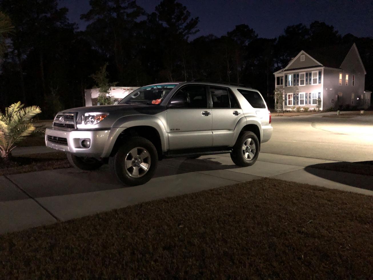

Tackled a lot on the Runner this past weekend.
  • New front Koyo Wheel Bearings.
  • New CV Knuckle Seals
  • Rebooted both CV Axles
  • Threw on Toytec/Bilstein front coil overs (3" of lift)
  • Rear 1.5" Daystar Spacer (Waiting on rear Bilstein 5100s in the mail)
  • New brake pads all around
  • Oil & Filter Change
  • Trasnmission Drain & Fill
  • Replaced the melted rear hatch button
In total it took 2 guys 2 days & 2 cases of Natty.
Not a bad way to spend a weekend.
