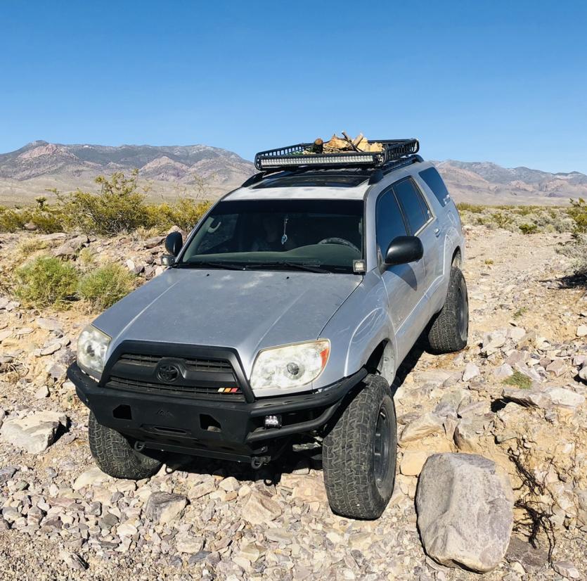

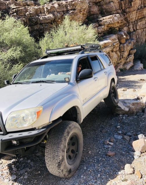

Didn’t have a chance to post last night but…Ran a bunch of trails that I hadn’t before and a few that I had. Part of the trail is remnants of the 4WP Desert Showdown race course. Saw some wild horses and burros, checked out some local petroglyphs and a few springs. Also checked out some abandoned cabins. Got the Mrs. behind the wheel for a while to navigate some areas that had washed out in a flash flood last year.

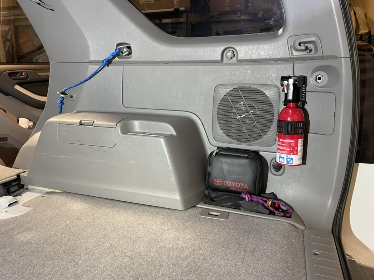

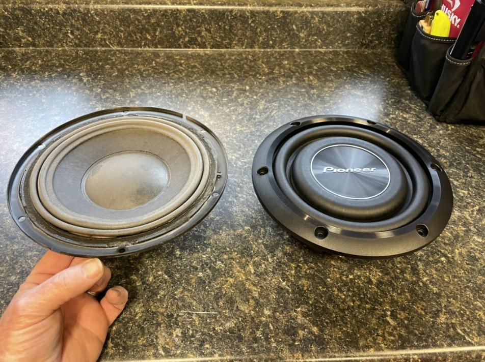

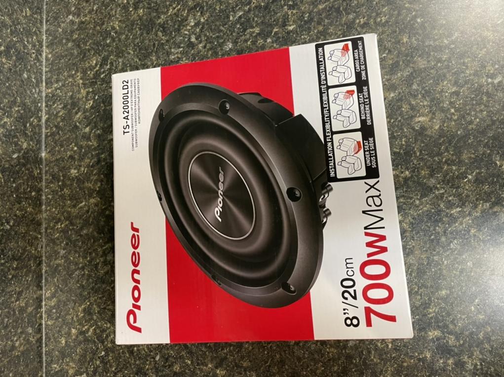

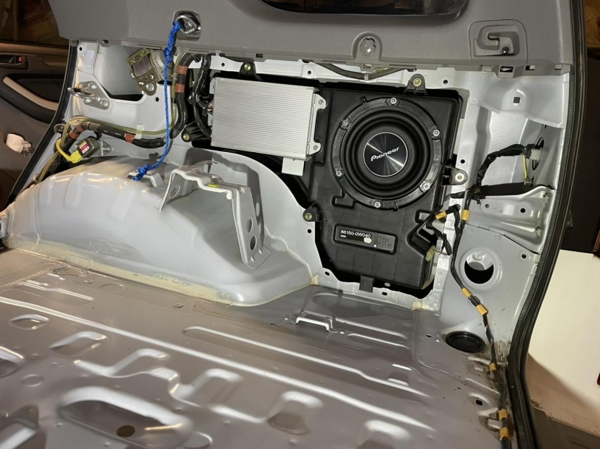

Subwoofer replacement
I had an annoying rattle coming from the subwoofer I decided to deal with. I’m the original owner of an 03 limited with the 10 speaker JBL system.
I’m really happy with the system. And being that I’ve added the GTA kit to connect my Apple device via Bluetooth to the original system, as well a dedicated GPS install that includes a backup camera I see no reason to move from the factory system. Also knowing that it is all at 2ohms. Any changes are going to require a complete rebuild of the audio.
So I decided to just find a plug and play upgrade on the sub. And via this site I found a recommendation and went with it. I replaced the sub with a Pioneer TS A2000 LD2
Couldn't have been easier. Used original screw mounting holes, just cut off wiring connection plugs. Stripped the wire and added some solder to wire ends to make a more secure connection and hooked them up. Red is positive on 1 side and black is positive on the other side. Bing bang and all back to get again and rocking to tunes.
When I want to test the thump I play a live recording of Eagles Hotel California that has a deep drum opening.

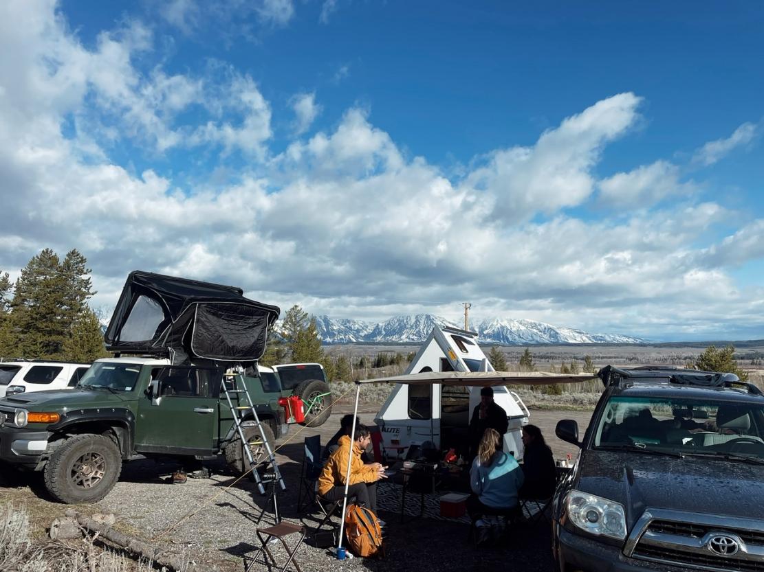

I painted and installed a rear recovery point on the passenger side since I cut my exhaust tip off. I have one from a forum member here and the other side is from overlandcustomdesigns.com which I believe is a member of t4r.org as well.
Got to test the Napa awning and it worked pretty well in the Montana/Wyoming wind.

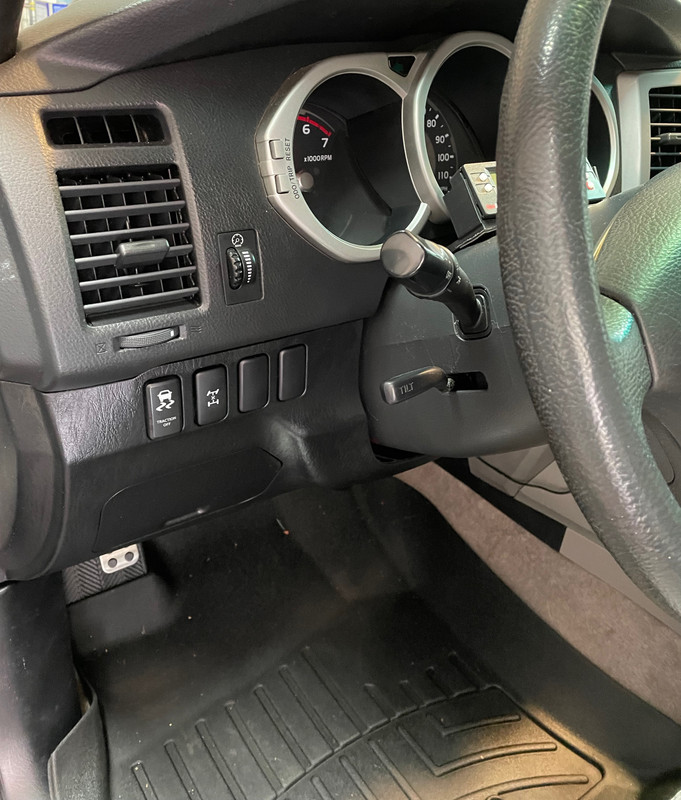

Got my driver's side lower dashboard dyed/painted last night and reinstalled today. Looks so much better!
One of the side benefits of doing this was finally removing the air sensor that's below the ignition. It was completely covered in dust and couldn't have been functioning very well. I just thoroughly blasted it with MAF cleaner and it looked brand new. :thumb:

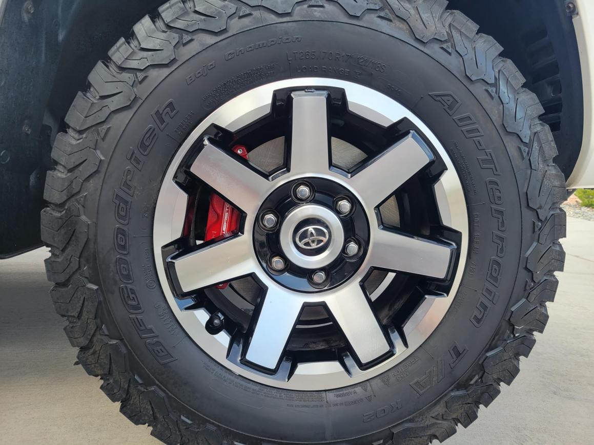

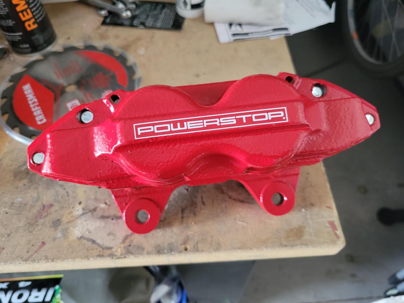

Well, I knocked out what I started and ended up having to correct last week...started with new EBC brake rotors, pads, SS lines and new fluid...ordered wrong sized rotors (319mm but needed 338mm) and found I had two seized calipers...I received my new DBA rotors and pads in a couple days and the 5th gen Powerstop calipers came in Friday...went fast so I threw in new Icon shocks in the rear too.. today was a good day...

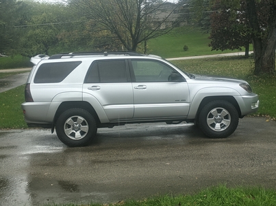

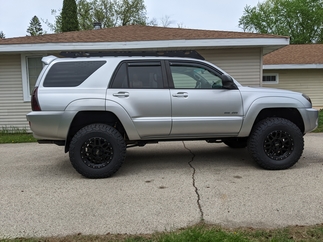

Combination of 2 weekend's worth of work, but changed a cv axle, installed some Overland Custom Designs sway bar links, installed OME heavy springs and shocks front and rear as well as OME upper control arms, new Rock Trix wheels, 33" BFG KO2s and a Sherpa Princeton rack.

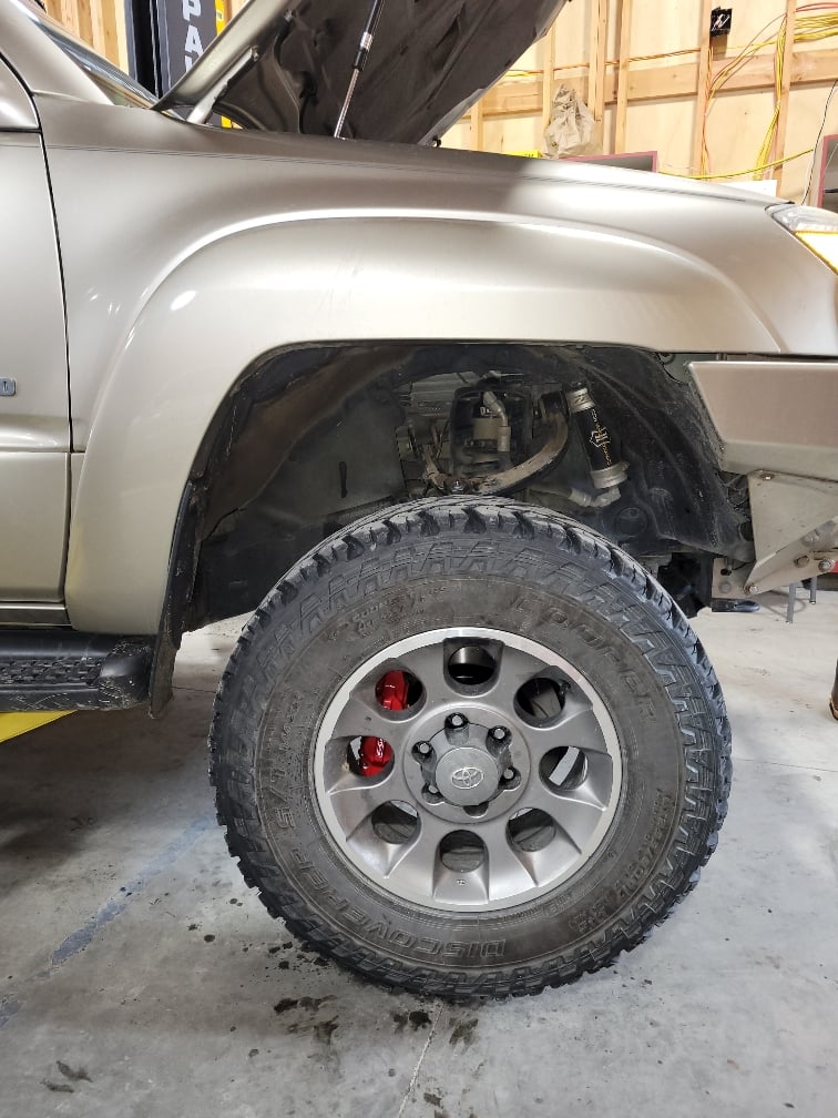

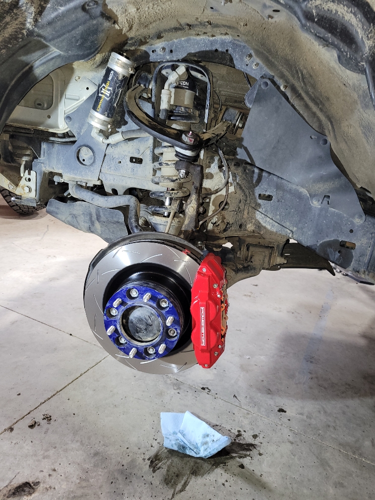

Finally upgraded to 5th gen calipers and rotors and added new pads and hoses.
Is there any longer term reviews of this upgrade? My friend manages a shop and he says he gets 5th gen 4runners all the time with front caliper issues.

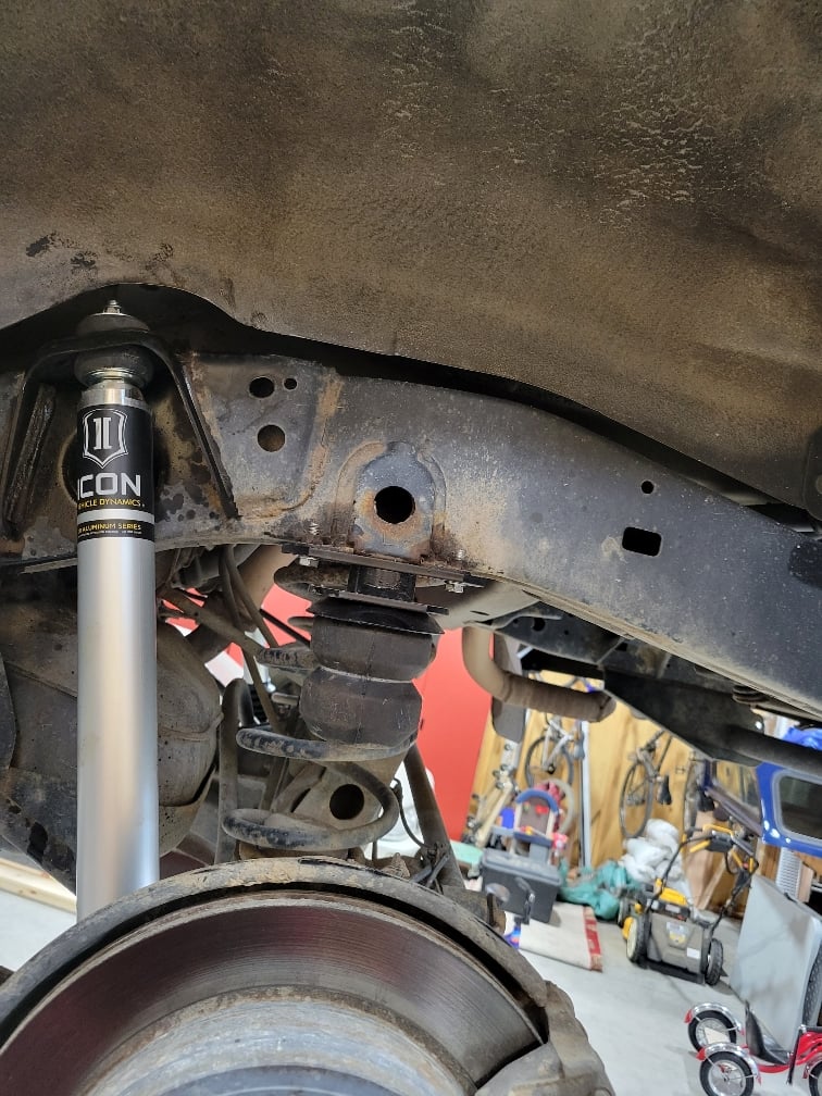

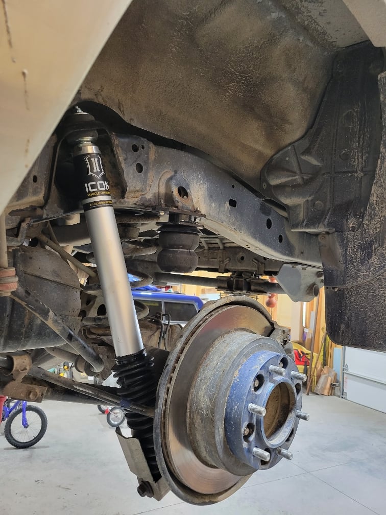

Sent from my SM-G991U using Tapatalk
Do you have part numbers for the pads, calipers and rotors? need to upgrade brakes soon. Thanks
Here's what I just installed...
Rotors: DBA-DBA42736S
Pads: DBA-DB1482SD
**Rotors and Pads purchased through Buybrakes.com...got them in 2 days from Reno, NV...
Stainless Steel Brake Lines: Stoptech 950.44007
Calipers: Power Stop S6278 Brake Caliper(s) I actually had GREAT luck buying them through Amazon...take that with a grain of salt...

That looks way good. Do you have pictures of the whole interior? How difficult is this to do?
Pads: DBA-DB1482SD
