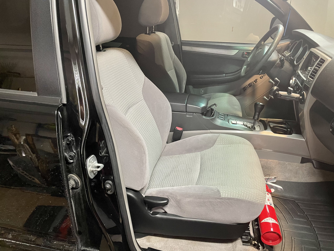

That looks way good. Do you have pictures of the whole interior? How difficult is this to do?

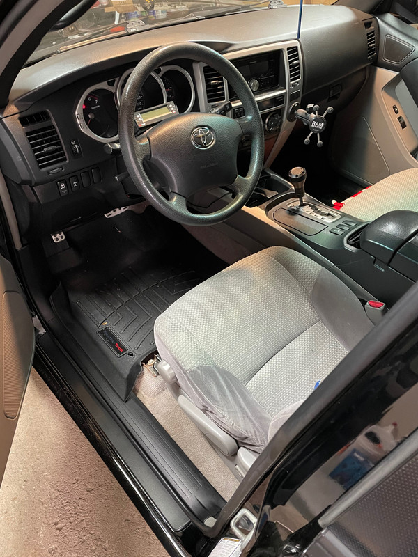

Thanks! Here's some photos of the driver's side and from the passenger side. The rear is relatively unchanged still besides the door sills I dyed across the entire vehicle.
I wouldn't say it's difficult but it is a major commitment and you need to be okay with the interior being two-tone for a period of time. The hardest part is really just figuring out how to remove the trim pieces. Some are easy, some are more involved.
If you prep each piece you shouldn't really have any issues once they're removed. I wash and dry each piece and then I do a coat of plastic adhesion promotor followed immediately with the first coat of the dye. The first coat should barely cover. I let dry for half an hour then do the second coat. For small pieces you should get pretty good coverage after two coats and I just do another for good measure. Larger, more curved pieces will require at least 4 coats I find. I've gone through 3 cans and have 5 left. I may need a few more depending on how the back goes.
The dye (duplicolor matte black) is fantastic, it doesn't leave any streaks or marks. It looks as close to what would've come from the factory.
There are a few pieces I've encountered that can't be removed though. Namely the small edge piece next to the glovebox. It's actually an unwrapped part of the top dashboard. I am going to try and brush apply the dye in this area and see how it holds up. I don't see how else you would be able to spray it even with masking. I would recommend really taking a look at what needs to be removed and attempt to remove a few pieces. If it proves too much effort for you, the last thing you want to do is start and not be able to finish. Also have a clear goal of what you want the end result to be. Do you want black carpet too? What about the headliner and seat belts?
So while it might only be a 3/10 in terms of the physical act of painting the pieces, the commitment required to finish the job is easily a 9/10. I'd also budget at least $200 for supplies because you go through quite a bit of dye and adhesion promotor.
Next I'd like to tackle the doors and where the seat controls are on the side of the seats in preparation for getting black Clazzio seat covers.
Hope that helps! I'm happy to answer any other questions and I'll be posting more updates to the progress as it's made.

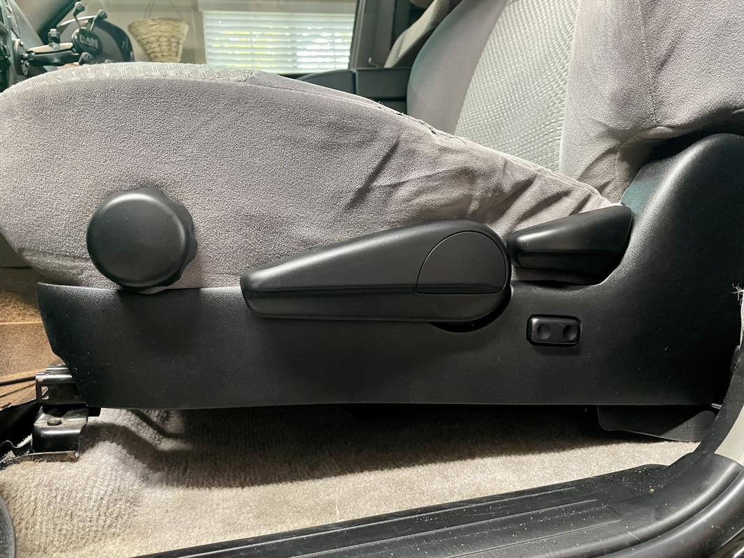

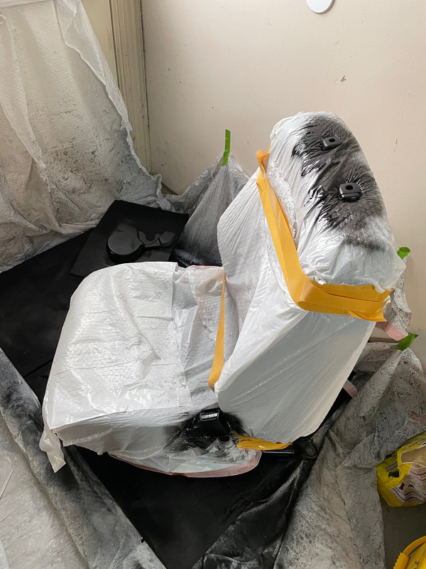

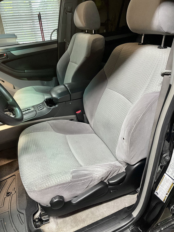

Front Seat Trim Blackout
This weekend I tackled dyeing my front seat trim black. I thought these would be time intensive and they certainly were! I started on Friday and had them both reinstalled Sunday afternoon.
The hardest part was disassembly and just figuring out how to remove each of the controls and side panels. The panels facing you when you open the door aren't too difficult but the panel that goes against the center console is tricky to remove with the space provided. It can be removed without removing the seat but I ended up removing the seats anyway and found it's easier to just remove it once the seat is out.
You technically could do a 95% job without removing the seats if you just remove the seatbelt receiver but the wire routing under the seat is more complicated than just disconnecting the main connectors so I just left the receiver attached. If you don't remove the seat you won't be able to dye the trim that holds the headrests on. It's a small detail but when I install my seat covers I didn't want that spot to contrast visually.
Once all the controls and panels are removed I dyed them like I did any other part. Wash, adhesion promotor, then 3-4 coats of dye. For the parts on the seat I couldn't wash I wiped them down thoroughly with denatured alcohol.
To mask the seats I just ripped open a few garbage bags and did some sloppy tape work just to keep things in place. For the headrest trim I poked two small holes in the plastic and stretched it just enough to fit over the trim and tucked the rest underneath so it was tight. This worked really well and I didn't have any overspray. I just used painters tape on the seatbelt receiver to keep the button red and stuffed some paper towel in the receiver to not get dye into the actual mechanics.
Overall, I'm really happy with how they came out. The finish is amazing and while it looks a little weird with the gray seats, now when I order my seat covers I can just install and enjoy the transformation. It's a big relief having them finished and while the seats were removed I was actually rewarded with a 2 peso coin I found! :trophy:
Next I'll probably start on the door panels or the last piece of gray trim around the center console. I believe you have to mostly remove the center console to access this piece though.

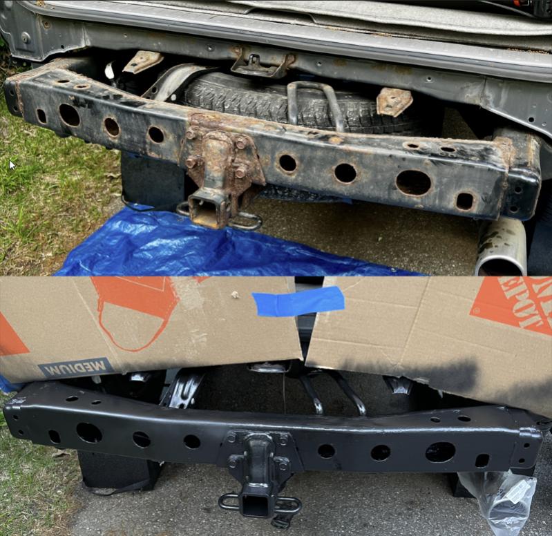

Started the rust removal process this weekend. Wanted to be begin with the rear bumper as access would be easy and allow me to test all my new tools and converters/paints. Worked amazing and I'm super happy with the results. Can't wait to make the rest of the frame look like this.
Forgot to take photos inside the frame but it was super crusty. Way worse than the outside. Loosened up all the rust inside then flushed it out with a hose. Probably should have used a power washer for more power but the results I got afterwards looked fine.
EDIT: Process
Steel wire brush and wire wheel on a drill for light rust
Die grinder with some roloc rust/paint removing discs for the heavy spots
Degrease with water/dish soap
Apply thick coat of Corroseal, wait 15 mins and hit spots that are gray/brown still
Come in with Rustoleum next for 2 coats with a few hours of drying in between
Finish with 2 coats RP 342
I coated the inside of the frame as well best I could.

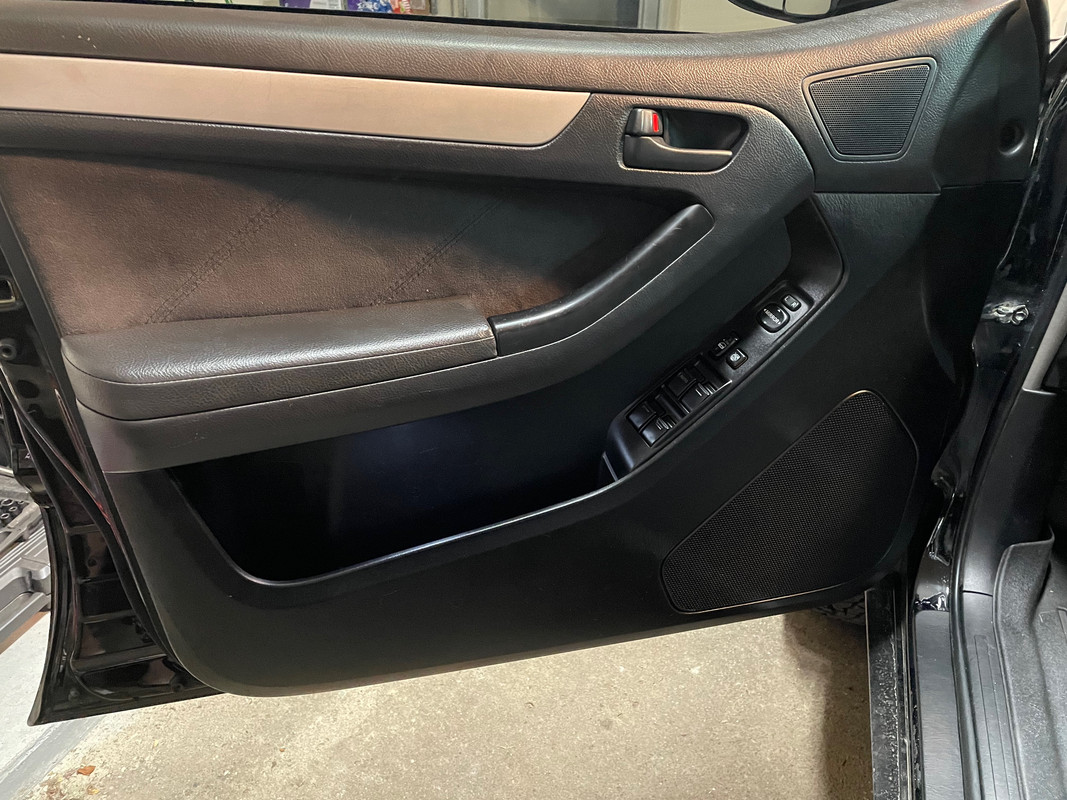

Black Door Panels
I got the front two door panels dyed this weekend. This time the masking was the most difficult part. I had a tough time finding a tape that would adhere to the vinyl properly. I eventually settled on aluminum duct tape.
These really add a lot to my blackout efforts. They're noticeable from outside the car looking through the window and from the driver's seat they really darken the interior a bit.
Clazzio seat covers are on order w/ 6-8 week lead time. Carpet dye solution has been decided on so just need to decide on timing for that.

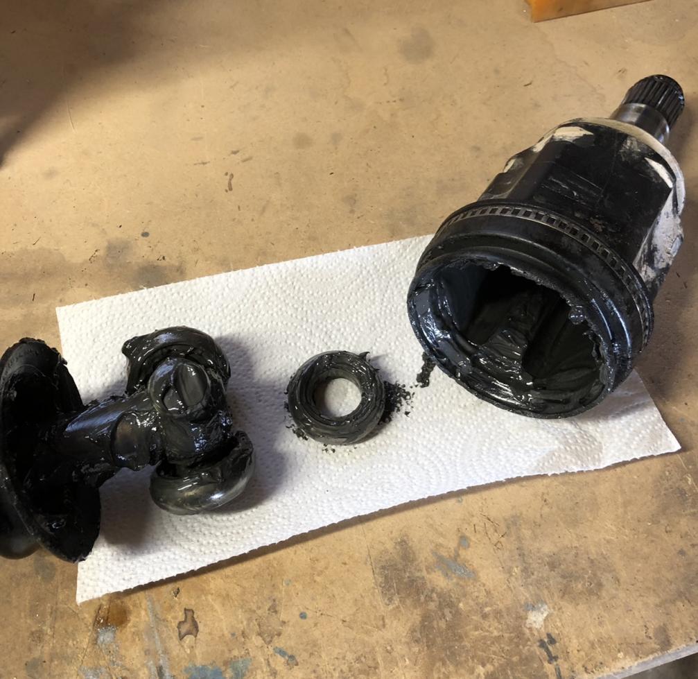

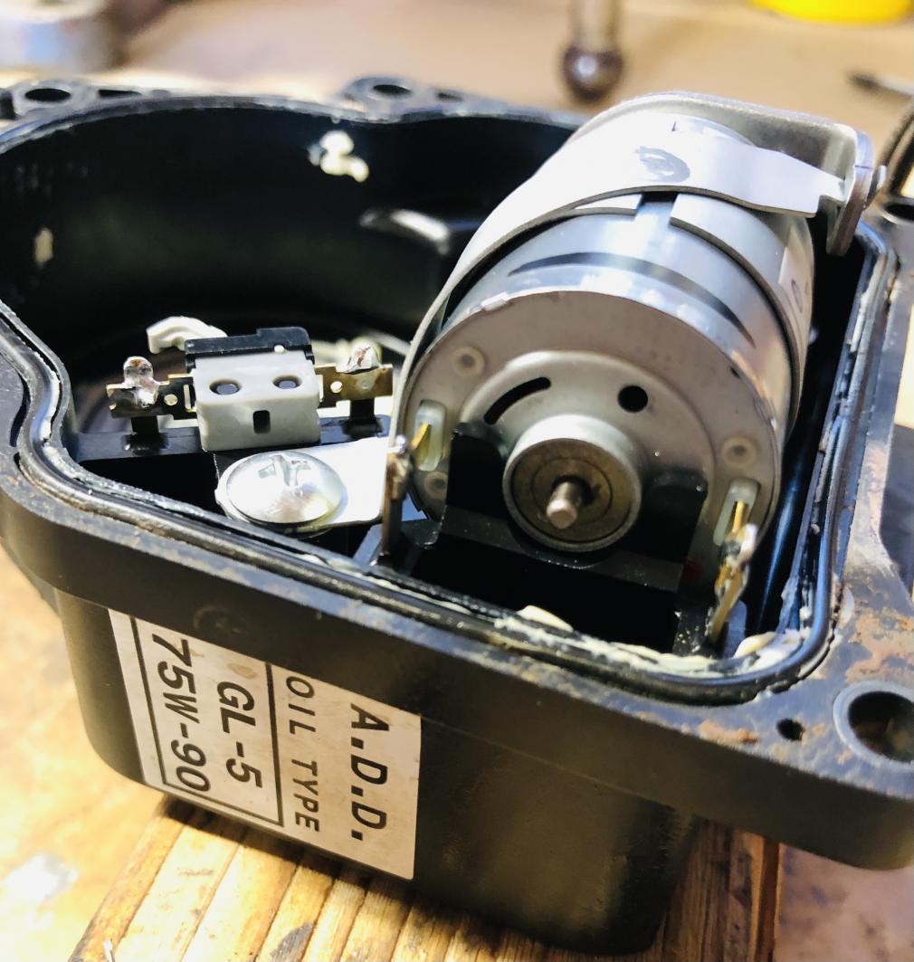

After all that I found my 4hi and diff lock lights flashing during a test drive. After much research I pulled the A.D.D actuator off and opened it up. I soldered the connections at the motor and the micro switch and problem seems to be solved.
Used this video: Toyota Tacoma | No 4wd Fix | 2wd / 4wd Mode Malfunction Fix | (2017 Tacoma) - YouTube
