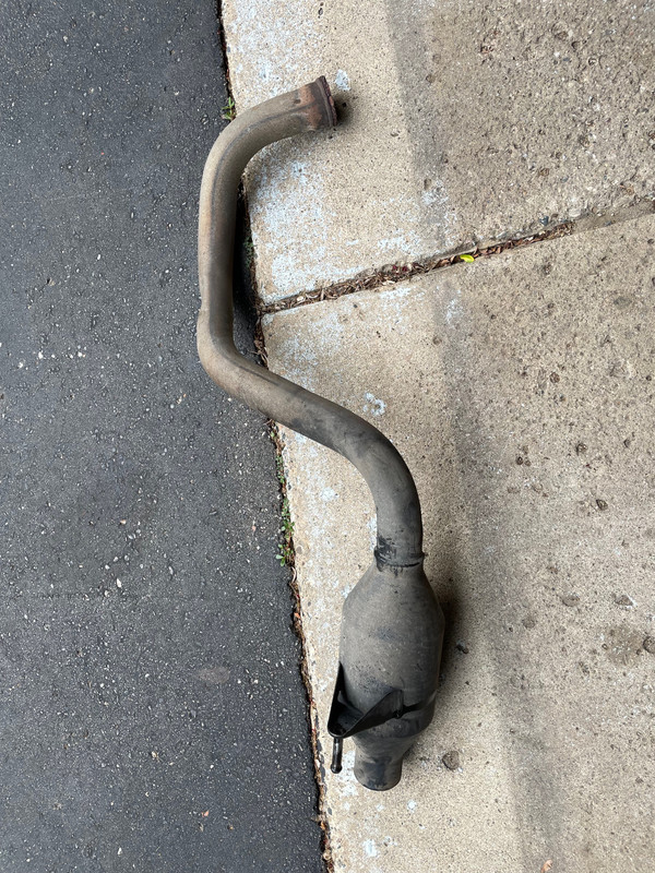

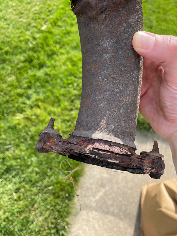

Well, it looks like I'm getting a new exhaust! Was driving on the highway when I started feeling a clunking sound, go to look under the truck and the joint at the end of the muffler had completely blown apart.
Look at what's left of the bolts! Gotta love Michigan! You people on the West coast and down South don't know how good you have it!
Not too bummed honestly. Happy it wasn't a wheel bearing and now I have an excuse to get my exhaust to side exit behind the rear tires.

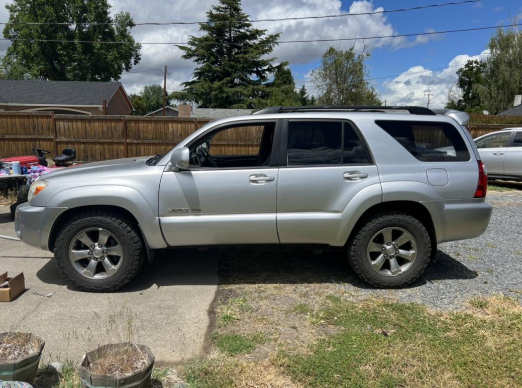

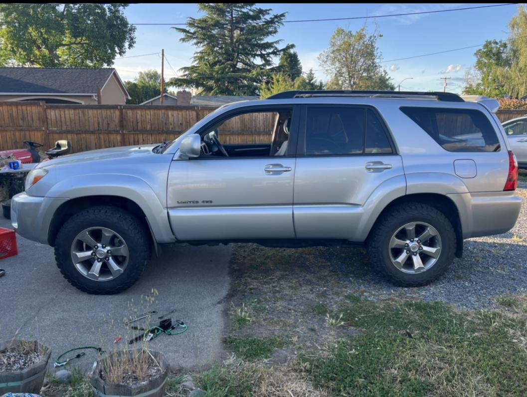

I’ve been sitting on installing my leveling kit from Daystar for about 9 months. Today, the first day of Summer for this teacher, was spent getting a little more closely acquainted with my 4th gen.
I was a bit worried about installing the leveling kit as my 4th gen still has its xreas setup. While it was a bit of a fiasco to maneuver the strut between the upper and lower control arms and keeping it tethered with the xreas line.
Love the side exit look. Any idea what you are gonna go with for a muffler? I just picked up a super 10… gonna be loud lol.
I was also looking at the Super 10! That or the 40 Series is what I'm leaning towards. I'll post when I get everything squared away!
I'm putting a super 10 on this weekend if you want me to give you a review before you commit! I'm a little nervous but I think itill be okay...:gun4:
Are you happy you did it? This is something I've been wanting to do.
