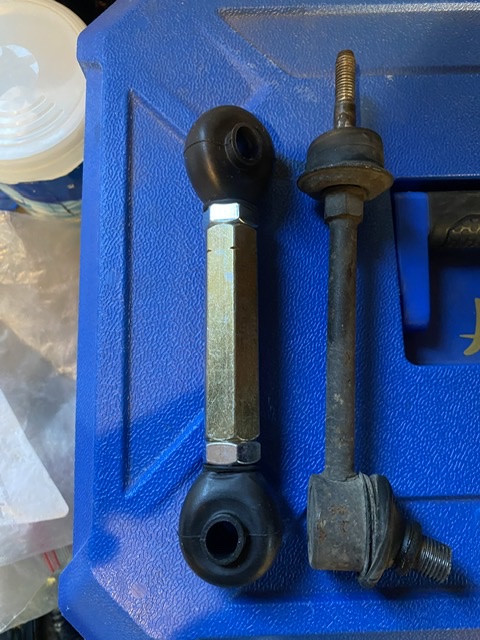

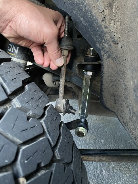

I installed extended rear sway bar links from OCD. Anyone have any experience with these? Noisy after a while or with regular maintenance are they ok? Seems to ride much better than stock which were way out of wack.

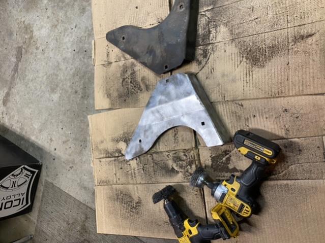

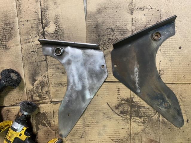

I bought a set of total chaos LCA skids used and stripped them down of rust and paint. I also handled the bolts that had a little surface rust as well. Will get around to painting and installing them tomorrow.
Photos of work in progress

Also here are a few photos of the OCD rear sway bar links from the other day. The side by side are the fronts vs the rear but same girth. I will get around to installing the fronts in the next few days.

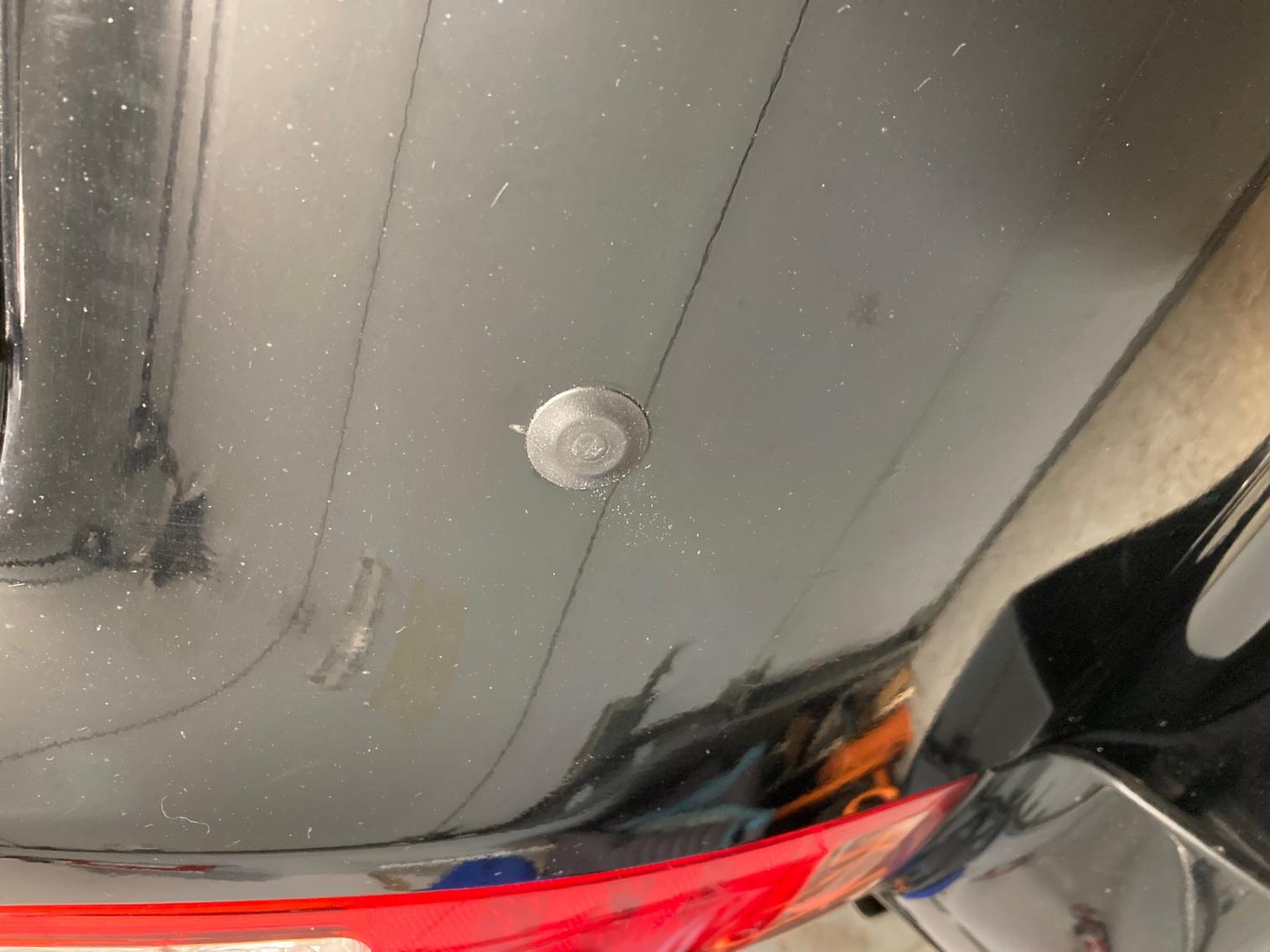

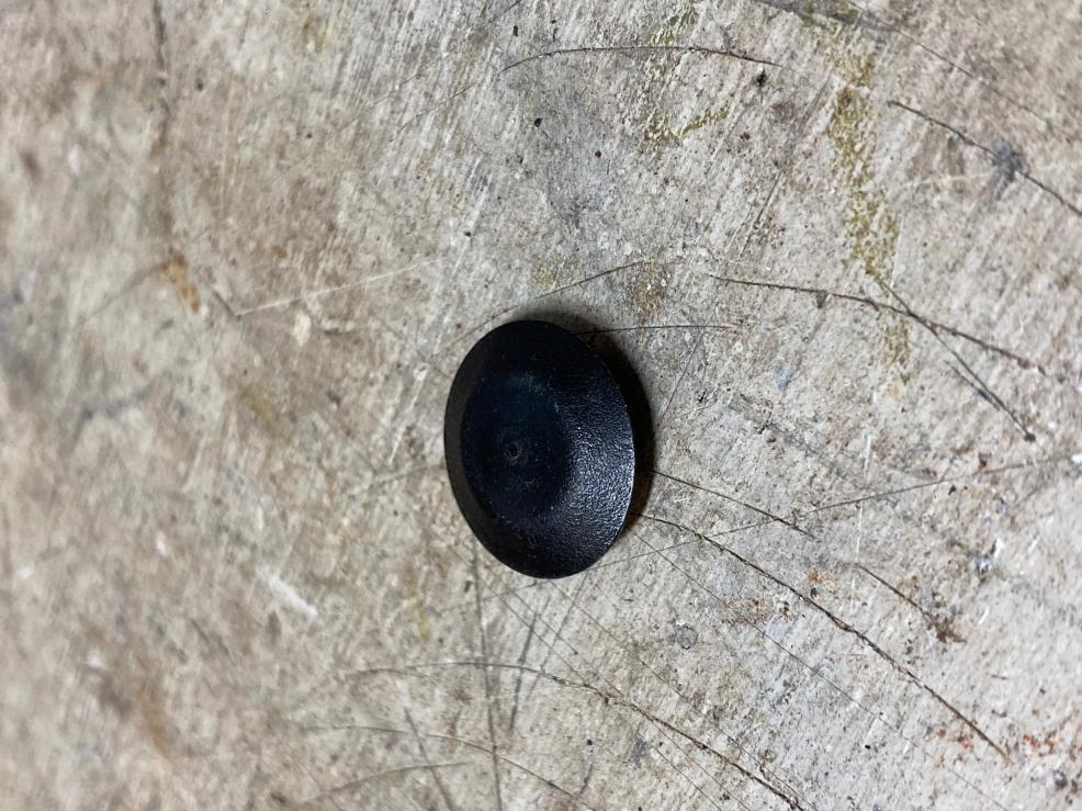

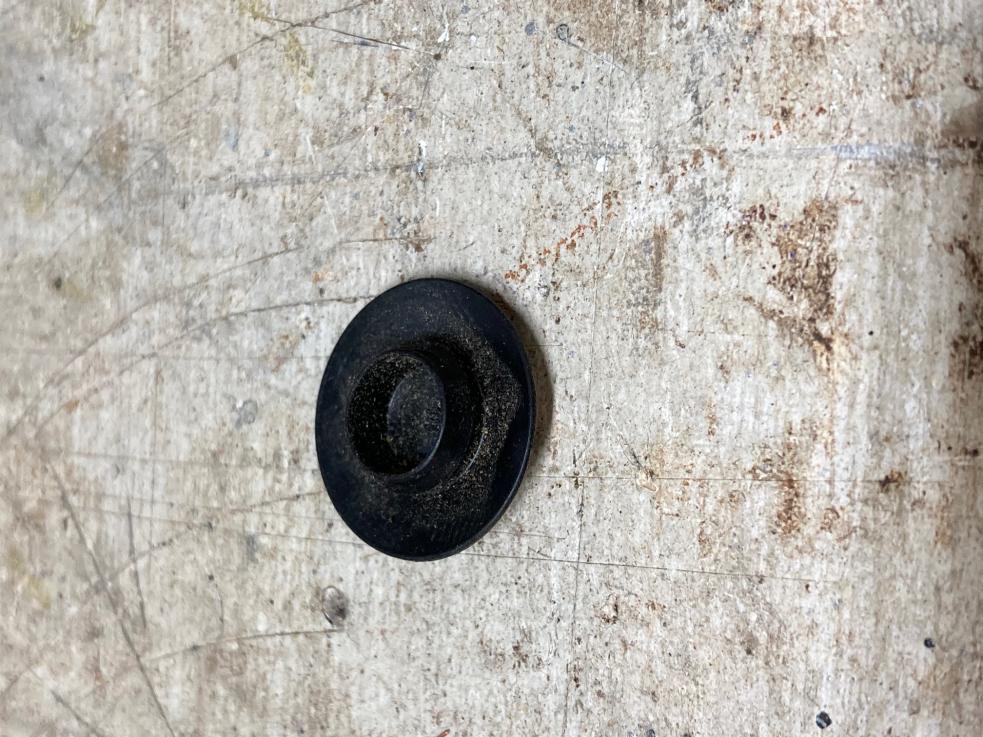

Redneck repaired a rust spot on my back hatch yesterday. Left of the license plate i had pencil sized spot of rust. Last year i ground it down with a dremmel and removed the rust. The spot reappeared under the repair with more rust so I ground it back some more. I was well below the sheet metal thickness and still had solid steel. Im going to have look inside the interior cove and see it is a spot weld in that location. Anyway, last week I see the rust return a second time. Pulled out my 1/2” rotobroach bit and cut a hole in the rear door and punched out the rust spot. Painted the exposed edges with primer, black paint and after it cured, plugged it with a panel plug with some clear silicone. Considering its black on black, I guess it looks okay. I just cant justify sinking bunch of money into a truck with 230,000 miles on it. So it’ll have to do until I need a whole new used back door
