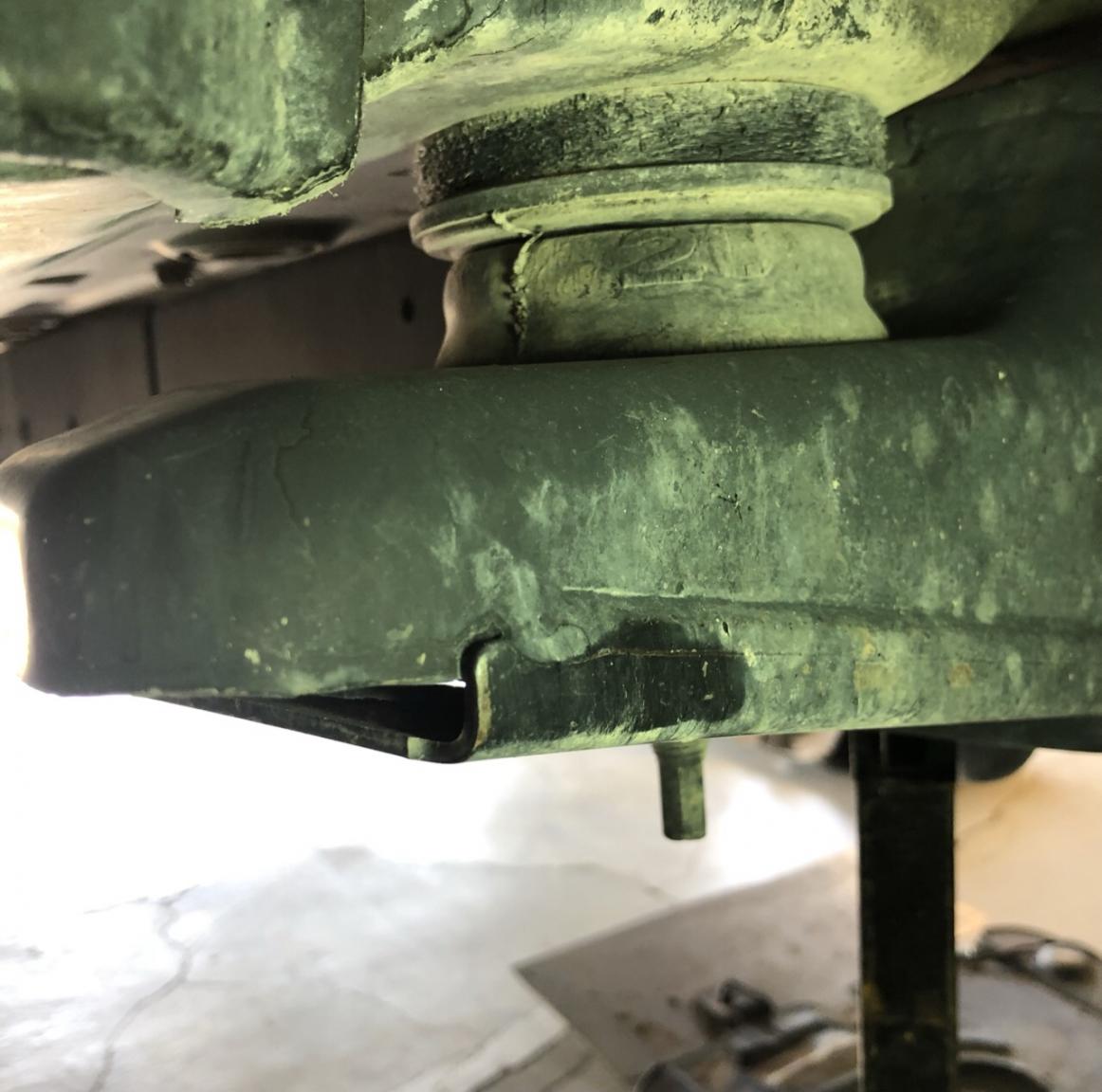

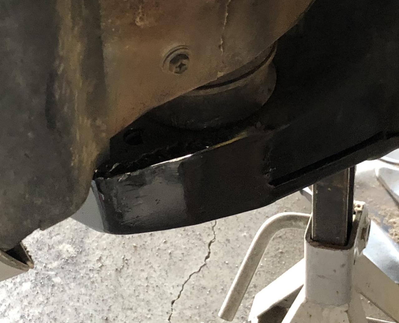

I replaced the front caliper pins then cleaned and reinstalled the pads with disc brake quiet. I developed a nasty noise from my driver side brake in the middle of a trail yesterday and couldn’t find anything wrong except some weird scarring on the outside face of the rotor. It almost sounded like a rock in between the backing plate and rotor. I cut the trip short due to the noise and limped it home. All seems fine but I’m not convinced it was due to worn out pins. Might be time to upgrade to 338mm SE rotors. I also did a body mount chop on the passenger side. The last two times out the tire rubbed that mount but never really hit it before.

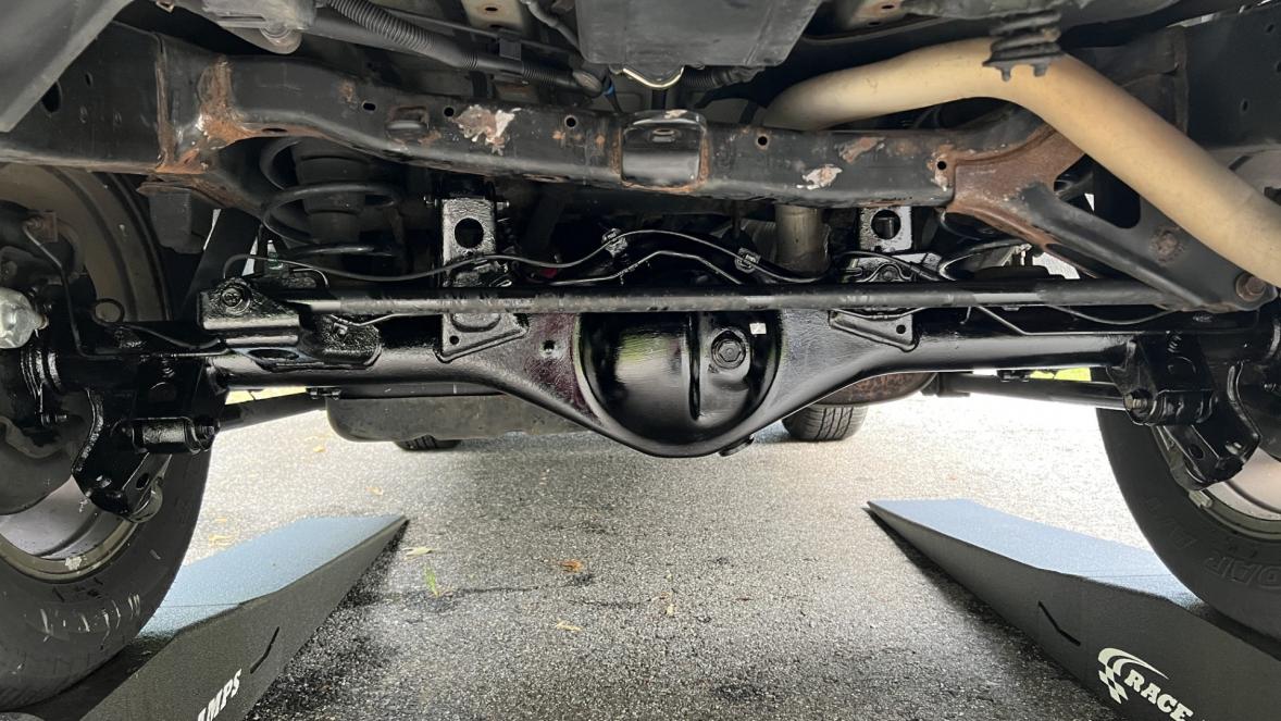

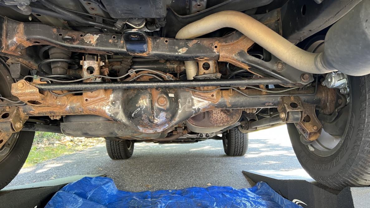

Worked on the rear axle this weekend, pretty happy with the result. This is only after the Corroseal coat. Still needs Rustoleum and RP342 top coats. With that being said I'm never buying a vehicle that lived in the salt belt again!

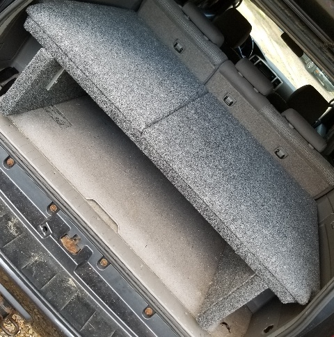

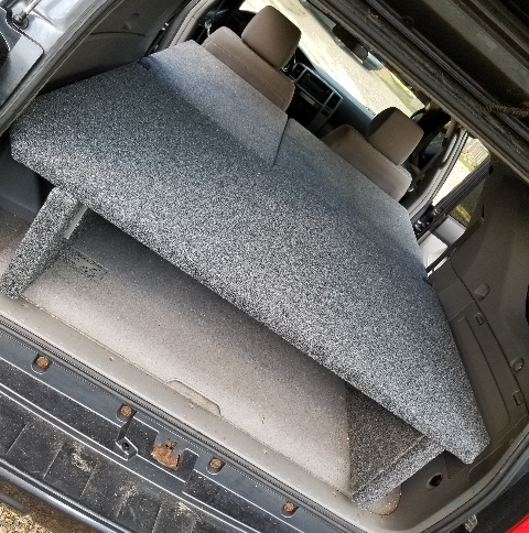

Finally got my DD shelf installed and then built a bigger shelf / sleeper platform for the back. It all comes out in 5 minutes to go back to stock with the DD, or can use the shelf for work. Can use any combination of seat up or down as well. Fits a full size mattress.

That DD shelf seems familiar somehow… ;-)
Glad you got it sorted out.

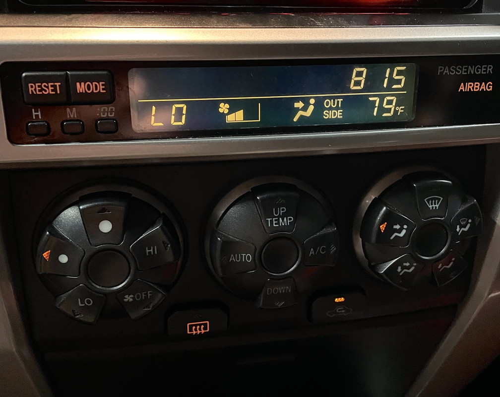

Climate Display Inversion
Installed the reverse polarity kit for the climate display as part of my interior blackout project. Not sure if the kits are still being sold but I found them through my searching on the forums.
The install isn't too difficult. There's two new LED's to install that need to be grounded. Then you have to remove the original display film and replace it with the polarizing film. The polarizing film needs to be oriented properly to give you a "black" display. The LED's with the ground wire are a bit delicate so I had to test the display a few times before fully reinstalling as removing the main harness had the tendency to make one side of the display go out. With some patience it worked out well.
Unfortunately I broke the lower storage cubby below the display in the process. The little tabs on the bottom that allow it to rotate down broke off so you have to really force the cubby out now. Only replacements I can find on eBay include the entire dash bezel so I don't exactly want to spend so much for one piece. If anyone has an extra, hit me up!
