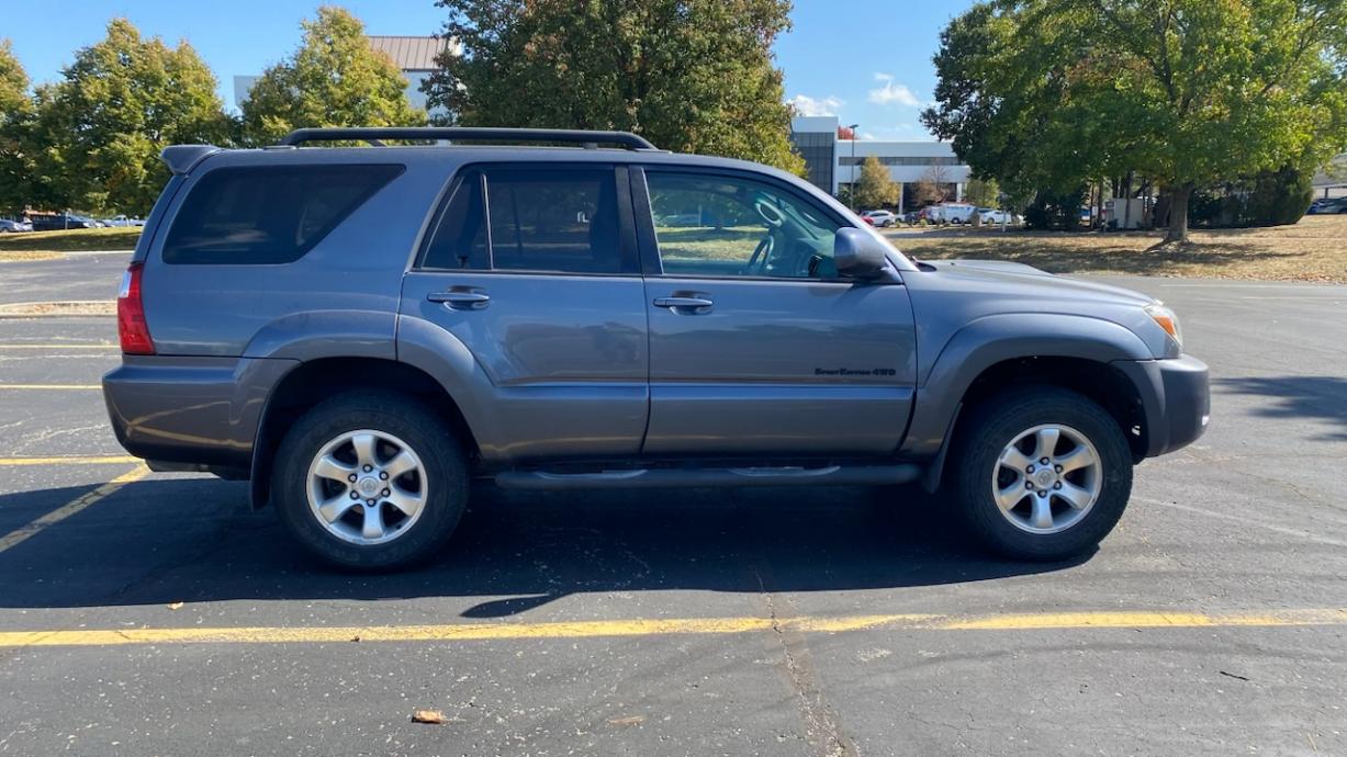

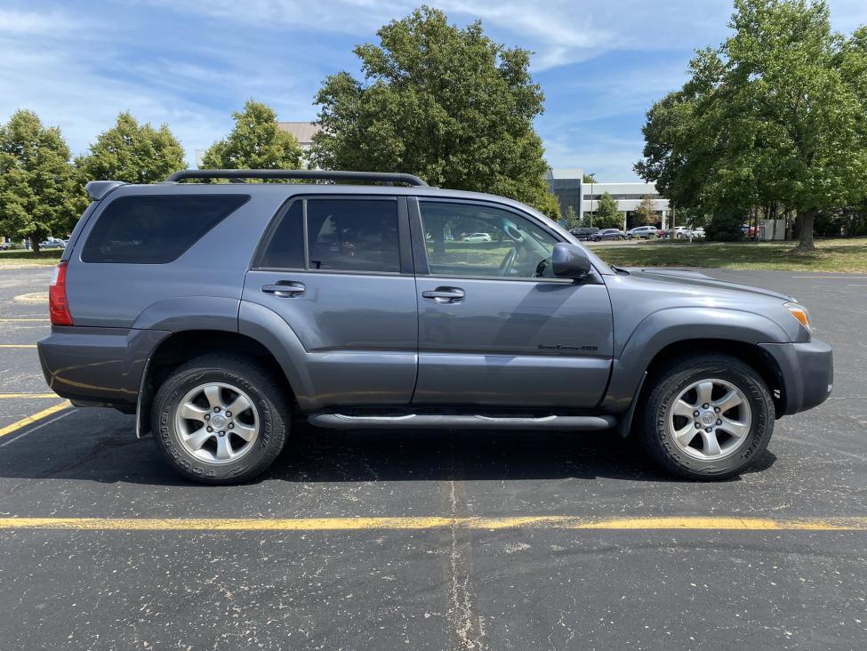

Finally got around to doing the 06-09 grille and headlight conversion. Took a lot longer than I was anticipating, but so worth it. Looks like a completely different vehicle now!
Before:
New versus old headlight:
New versus old grille:
And the final result!

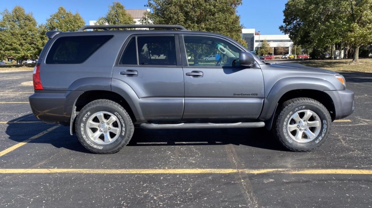

Leveling kit installed. Before and after pictures below. New tires going on tomorrow and wanted to get this done before that. Leveling kit is Icon Vehicle Dynamics, new tires will be Cooper AT3 4S in 265/70/17. Now I’m debating on removing the side steps because they look like they have a Carolina squat. I will update this post after new tires are on.
Added photo after the tires were mounted. I LOVE the new look. Zero rubbing.
Before:
really looks nice, so you didnt need to change the hood for the headlight assy swap?
No, didn't need to change the hood. The 06-09 grille bolts right up to the hood, and the 06-09 headlights have the same geometry and mounting points.
The filler trim below the headlights needed to be changed and the bumper needed to be trimmed to get the grille to fit. Other than that, it's a pretty easy swap.
