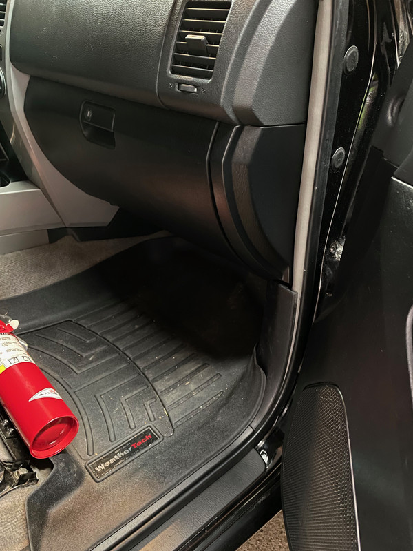

Glovebox Blackout (Complete)

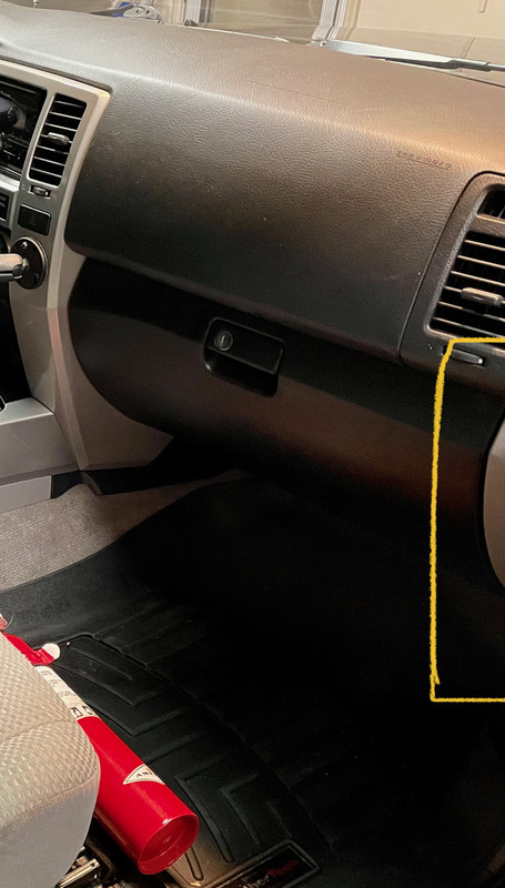

Finally got around to painting the side piece of the glovebox that tucks into the passenger door. Unfortunately this piece is part of the entire dash panel and to my knowledge can't be removed without major disassembly.
I taped the area off the best I could and use plastic bags to cover the door and interior from overspray. It went smoother than expected and the end result looks a lot better than it used to! I don't have a great photo of the before but in the highlighted area you can see the visual inconsistency.

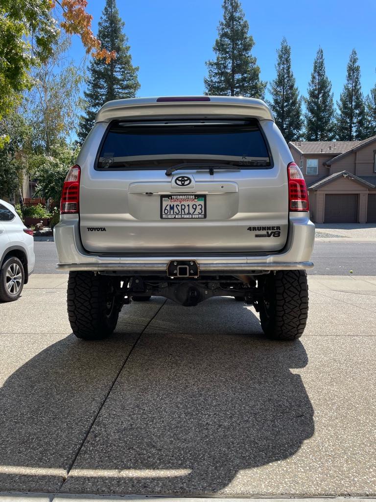

Got some more done on the new bumper. Decided I like when tube sits right below plastic instead of outside of it like my CAD model. Very difficult making good looking rear bumpers on these trucks!
Almost finished with the rear. Just need to hit with RP342 and then spray the frame and inside with Fluid Film.

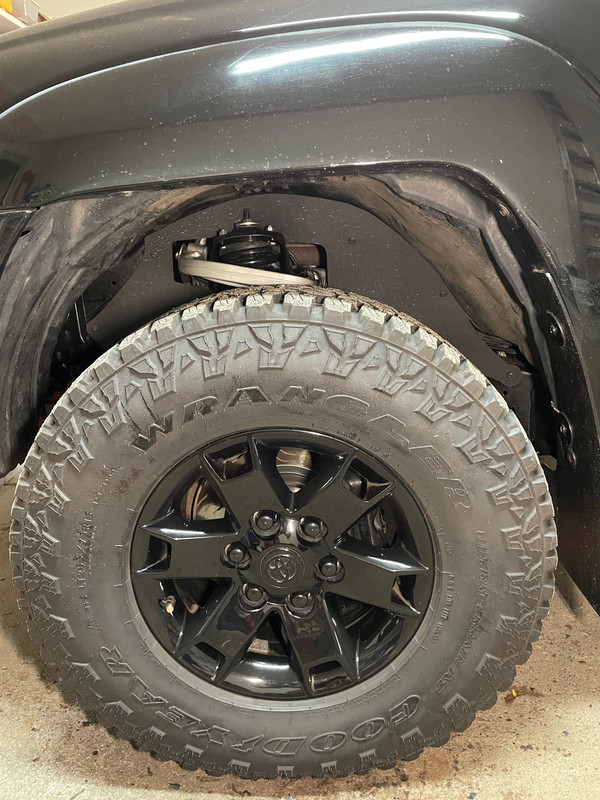

I got my new suspension installed last weekend. Overall the install went okay.
The front was relatively easy but I have a tendency to try removing as little as possible and wasting time trying to make it work when it'd just be easier to remove more. For example, the steering tie rod needs to be disconnected and the sway bar removed (or at least rotated out of the way). I also found the battery needed to be removed to get the UCA bolt out.
Luckily none of the bolts gave me too much trouble or needed to be drilled out! :whoo:
The rear actually gave me more issues. I had read the Moog springs for the FJ won't fit the perch on the 4Runner so I ordered ACDelco springs in hopes it was a Moog-specific thing but it was not. The perch on the 4Runner is almost egg-shaped and the aftermarket FJ springs narrow down too much to properly seat. I ended up grinding down the perch as much as I could to remove any buildup or rust that may be hanging it up but I was never able to get them to seat as well as the OEM springs. I got the end of the springs to rest at the stop so there's really no way they can fall out. They just barely don't fit so when driving it I made sure to hit some rough patches to use the weight of the vehicle to seat them. It rides well, no weird sounds or harshness so I'm not overly concerned. But I would've spent the extra money for proper springs to save myself the time.

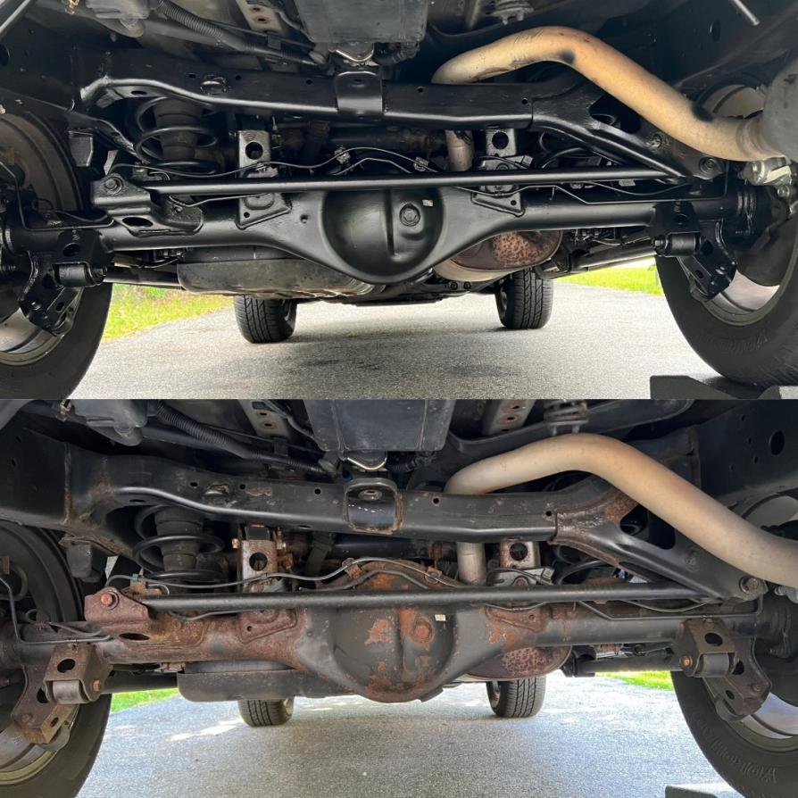

Overall the job took me from 10am to just after 10pm to wrap up. I also used the opportunity to grind and coat my frame and freshen things up. It just didn't feel right putting such nice parts in the crusty wheel wells!
I got the vehicle aligned and unfortunately my LCA bolts are seized so they were unable to adjust my caster. That was the one adjustment I was hoping for so I could clear my front mudflaps better but alas, there's more work to be done! Next summer I will have to plan on replacing my LCA's, CV axles, and bump stops.
Measurements before (top of tire to fender):
Front: 4"
Rear: 7.5"
Measurements after:
Front: 6.5" (7" before settling)
Rear: 9"
I got more rear lift than I was expecting so the rake is still a bit more than I wanted but the overall height is so much better I don't really mind. Once I get 33" tires it'll be perfect. It's cool to park next to a 5th gen and be taller than it and to be level with full-size trucks on the road. The handling hasn't changed too much which is to be expected just swapping OEM-spec FJ parts but one of my rear shocks had completely failed so I've noticed a lot more stability and the vehicle is much more controlled on rough terrain. Bumps don't rattle the whole vehicle and linger anymore.

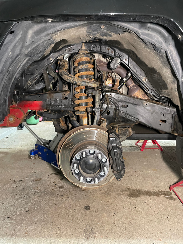

Before

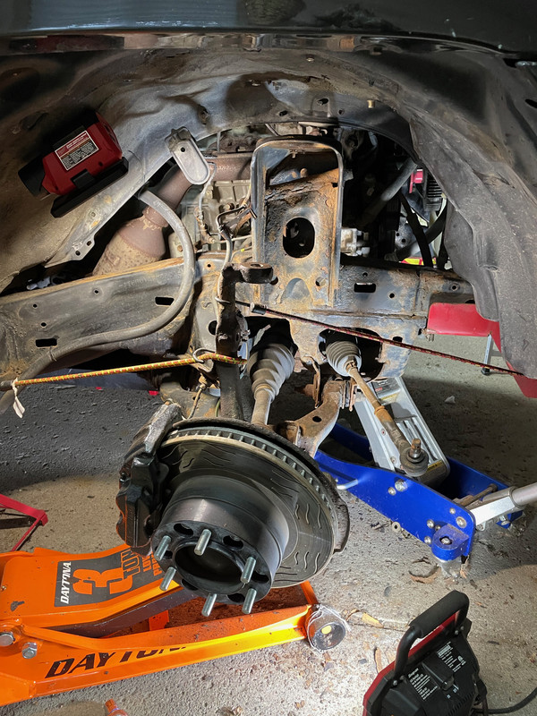

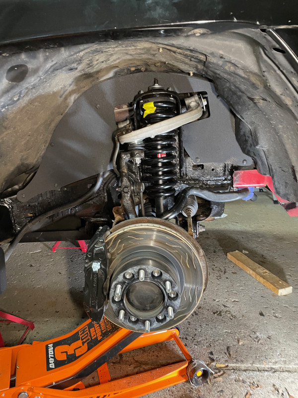

During

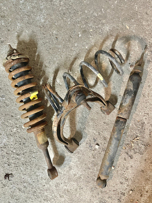

Old 230K mile components
UCA visible from the wheel well

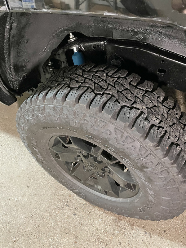

Bilstein poking out the rear wheel well
Clay bar, strip wash and ceramic coated.

Before
During
Thanks! I'd like to add more protection around the sides but probably just leave it for now. Plus there isn't much room to land a tube on top hah
Love the rear tube armor but are you concerned about moisture collecting at the meeting point since the tube is so snug to the bumper?
