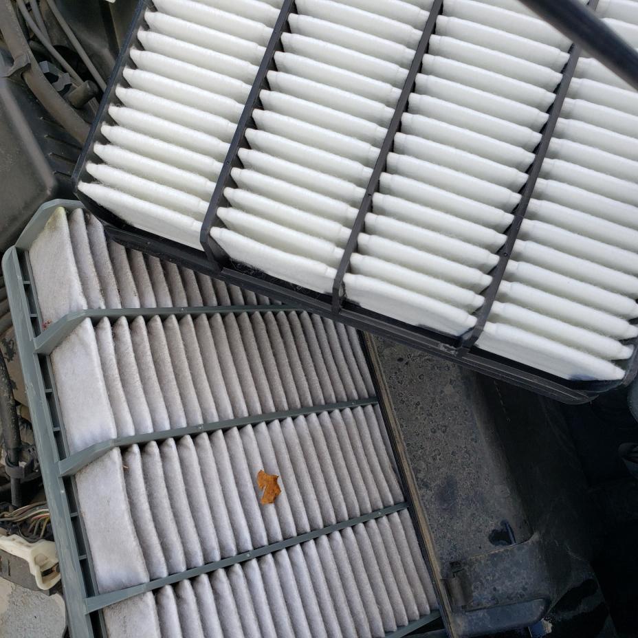

air filter photo
Following the Jiffy oil change I renewed the air filter. It was high time too.

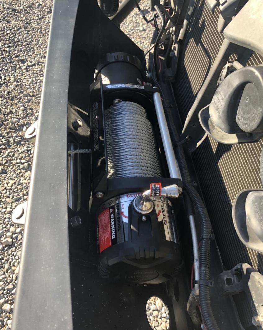

Started my winch install. Decided that since I don’t have my recovery/frame tie-ins that I’d go on a trail run instead:D
Did you have to relocate control box? I think we have the same winch and bumper now. Glad to see it all fits lol.
The control box doesn’t seem to clear the hood release, at least on my initial test fit. I plan on mounting it back in front of the radiator. I haven’t decided on a spot yet exactly. Maybe below the horns. I also need to clearance the opening behind the fair lead because the cable seems to drag along the bottom opening edge. I have the Smittybilt xrc gen 2 9500.
Thanks bro, these are great tips to look out for. I have the same winch have all the stuff to switch over to synthetic. Factor 55 stuff.
I think the Hawse fair lead for synthetic rope might fit better on this bumper. The fair lead that came with the winch is massive lol.
Yeah I just looked at your build thread again and saw the last post. That thing is pretty bulky huh? Hopefully everything goes smooth that day. I will be posting in here when done for sure.
