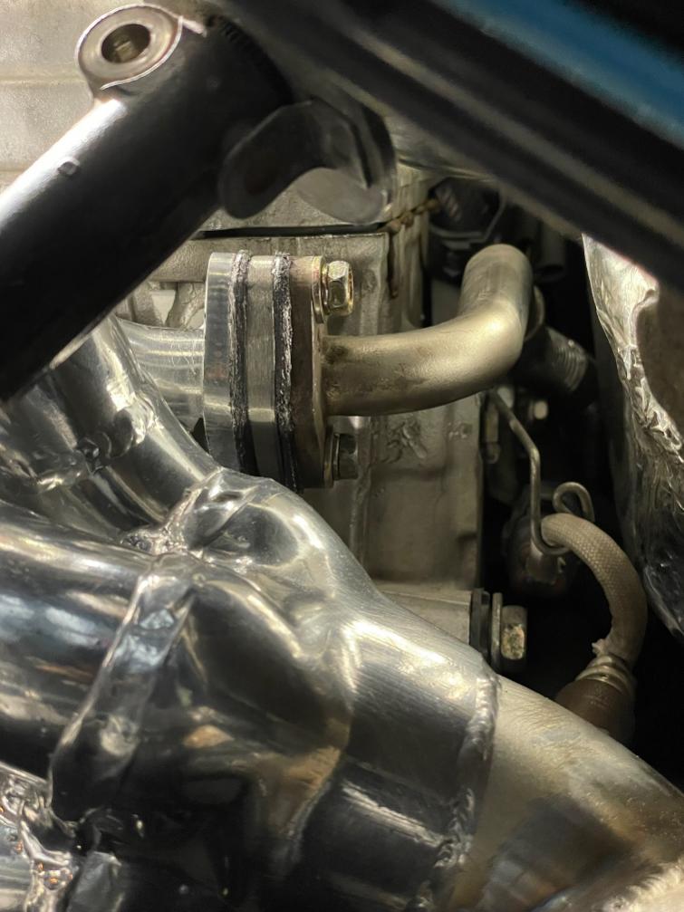

As sweet as they look, the driver side air injection tube is about 3/4” too short. Wtf! Hopefully URD can make it right. Already had to pay for a rental car for a week (sucks not having an extra car)

Kind of doubt it. Going to try going directly to Thorley since this should be covered under the 5 year workmanship warranty. Plus they are in CA so if they have it in stock, it should get here pretty quick.

I was a bit off on that 3/4" measurement, it's actually more like 3/8" but still no where close to being able to bolt that connection up. I don't think this is a common thing and I hope Thorley can make it right as my only car is down for the count.

Yeah same. DT got back to me yesterday and said they'll have a solution today at the latest. Glad they are on top of it. And really missing having a 3rd vehicle at the moment lol

Man this DT header install has been a rough one. Biggest takeaway is to not do a project this big without having another car to drive daily lol. Rental car for 2 weeks added $500 to the bill on these :nono:
Also be prepared for anything, I bought stainless MIG flux core wire off Amazon which turned out to be the wrong answer. Ended up TIG welding the cats on. Not sure what I would have done without having the TIG handy. Also spent way too much time making jigs to mock up and weld the new ones that I never ended up using because the jigs did not line up with the DT header and OEM cat. Instructions state to remove both OEM manifolds, cut the cats off, bolt everything back up then tack weld the headers to the cats. I should have done this from the start.
Don't count on the EGR tube flange being in the right spot from DT. Mine is 3/8" further away from the OEM air injection tube so I had to come up with a way to take up the gap. 2 new Remflex gaskets and a custom made stainless spacer and longer bolts is what I came up with. See attached. Because the flange sat 3/8" further away, that meant I also had that much less room to put the rear most nut on the header to head connection. That stud got removed in favor of an M10x1.25 Toyota bolt I had laying around :nono:
