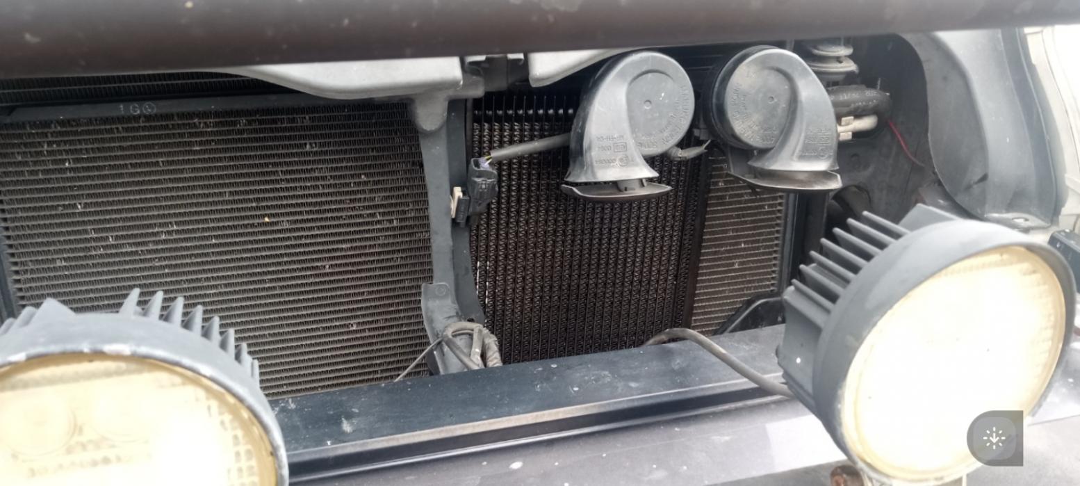

Added a transmission cooler using this link as a guide.. Transmission Cooler Installation, 2006 4.0L
Even with new fluid, radiator and cap, the radiator gets a little hot when towing over mountain passes even at 25mph. I might also consider a higher pressure cap if the cooler doesn't solve the issue.
Went to AutoZone and got the biggest generic one for about 80 or 90 bucks. It comes with just enough hose to route the bottom exit to the cooler back to the original line going to the transmission. Zipper ties through the AC fins seem to hold it nicely (and crooked because I don't care).

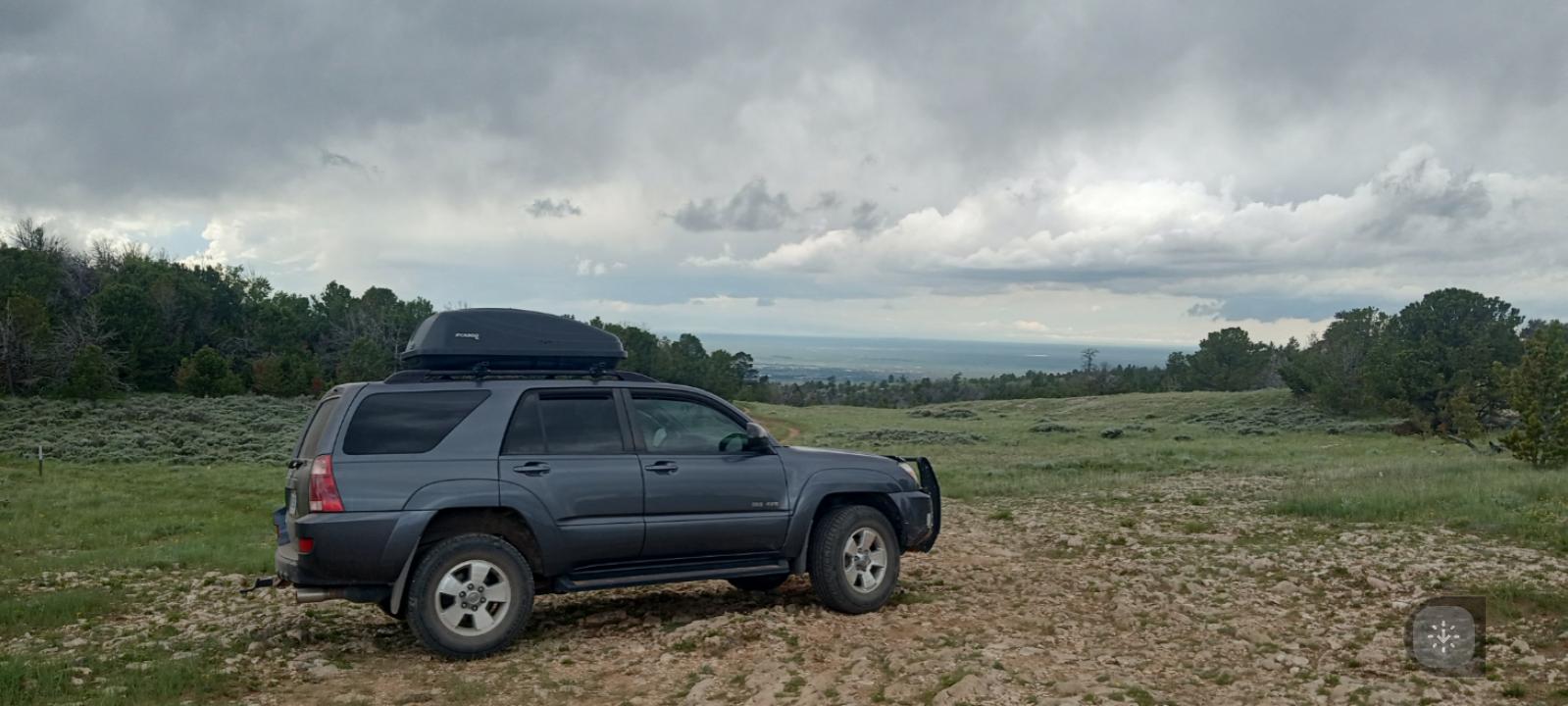

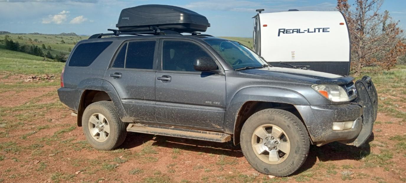

Put 29 miles on forest roads near Larime, WY.
Got to use differential lock a few times and needed it going up sandy, uneven step spots. Crossed a creek and decided to call it a day after realizing I was out of cellphone range and the rocks were getting damage size.
Mostly stock with 1" Daystar rear lift for the camper and kyb quickstruts up front

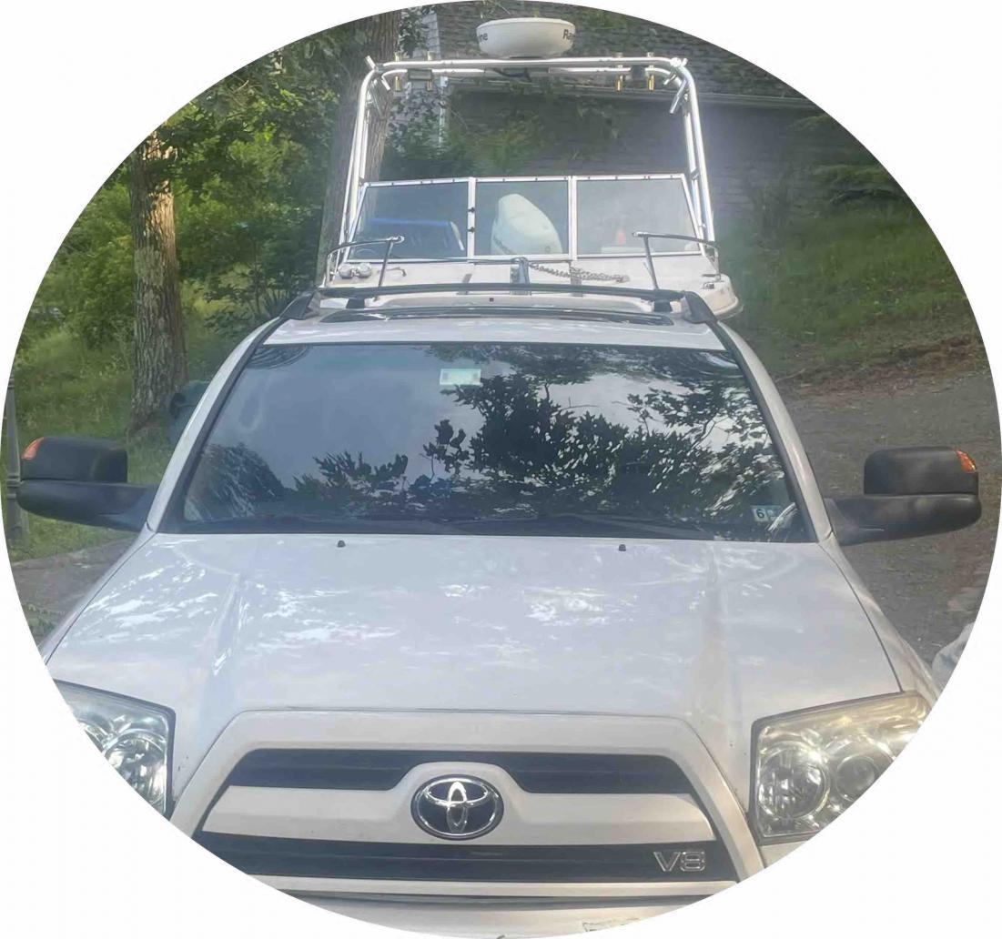

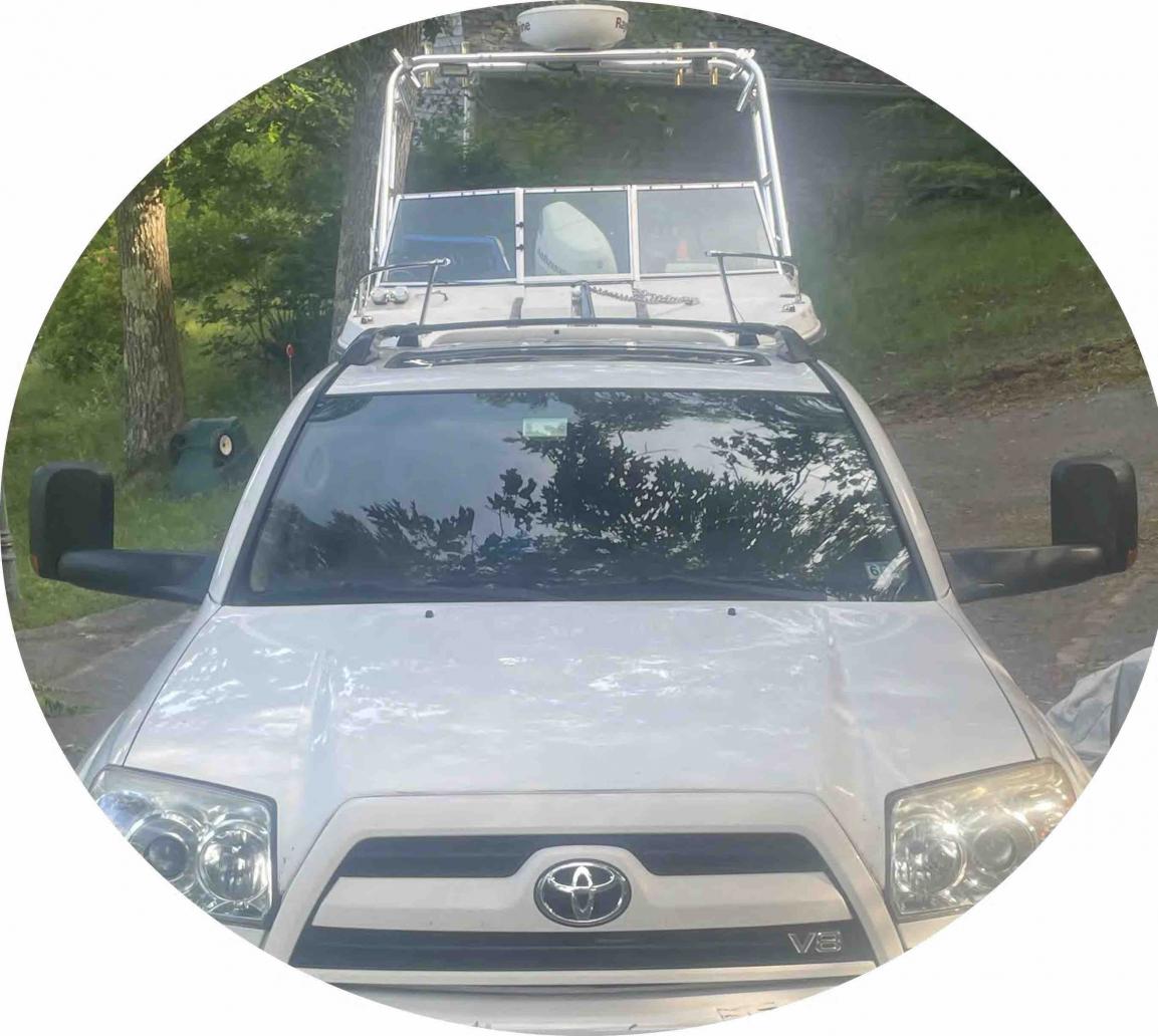

I added tow mirrors designed for a Tacoma.
I had to mark and drill new holes for the 3 studs that hold the mirror on and use an angle grinder to shorten the studs. I'm very happy since I can now SEE while backing up with the boat attached!
First photo is with the mirrors up for tow mode. Second photo is down for "regular" mode.

am a lil intriguied by your bush bars, did you mod the original design?..would you mind posting a full face on shot of the truck?
