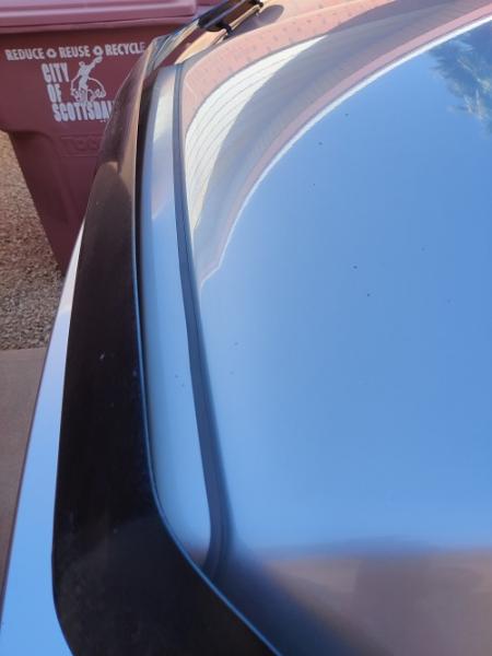

I replaced the "seal" that goes in between the hood and grill. It was really falling apart and vibrating a bit.
Would post a pic, but it's not allowing it! :shrug:
You can try with Imgur: The magic of the Internet, it's a common one.
I'd love to see yours as I ordered the part for my grille project but I'm not quite sure how it's supposed to sit as I never had one.
The grill has to come off and there are 8 nuts to remove. Remove old seal and clean the area well. The seal itself is well engineered to install easily. There is a groove marking the center of it so no measuring is needed. It has a peel off backing which is cut at the center. You push the seal over the lip of the grill into it's groove about two inches at a time and THEN pull off the backing the same amount. Press that section down for good adherence. DON'T pull off the backing all at once. It is VERY sticky and can't be worked with. Keep doing two inch sections.
**The picture was too big so I had to downsize it. That's why it wouldn't upload.**
