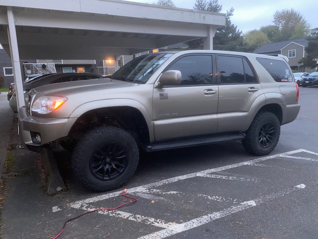

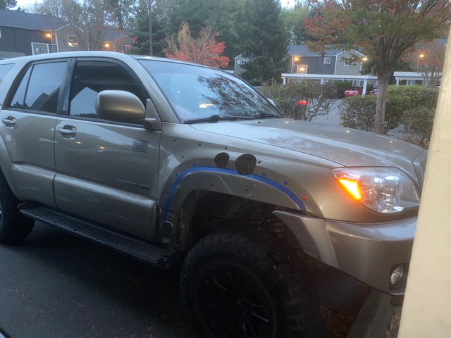

Trimming the front fenders to fit the 35's i have (to be installed in 3 days). BMC is getting done in two days and snorkel will have to be mated to a Cold air intake that doesn't even remotely allow compatibility.
Should be fun!

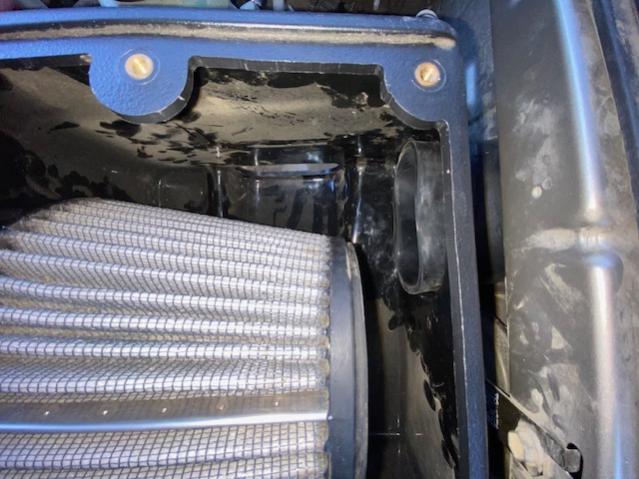

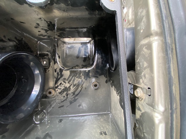

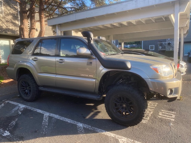

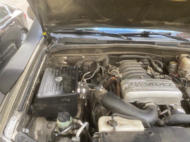

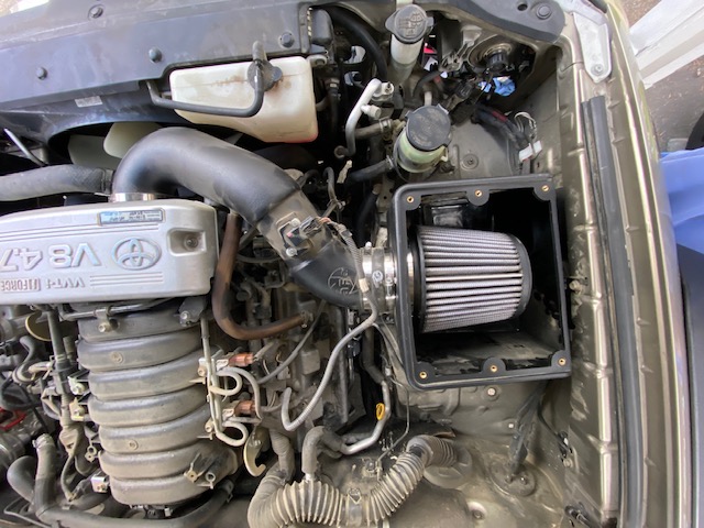

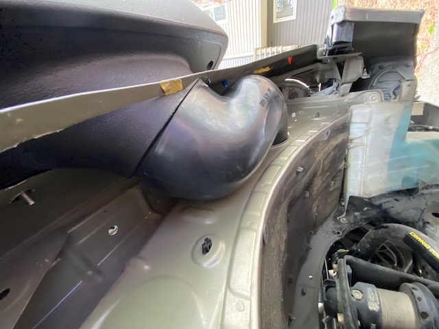

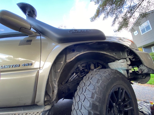

Update since i think this is relevant and i cant post yet. Today i finished removing and trimming both front fenders about 2-3" and mated the safari snorkel to my Afe ProdryS cold air intake. safari snorkel rubber piping fit right into the inlet for the CAI, what luck haha.
Feel free to judge and make observations, I've only seen one write up of how to do this on an FJ cruiser.
Looks good. You might want to relocate your washer fluid tank. Those 35's are going to rub on it
Planning on doing that within the next few days. Benefit of living in the northwest is never needing fluid 9 months out of the year, so a smaller tank will be just fine. There's always something else to do lol
lol.....it is never ending but fun. Look forward to seeing your new tires on the truck

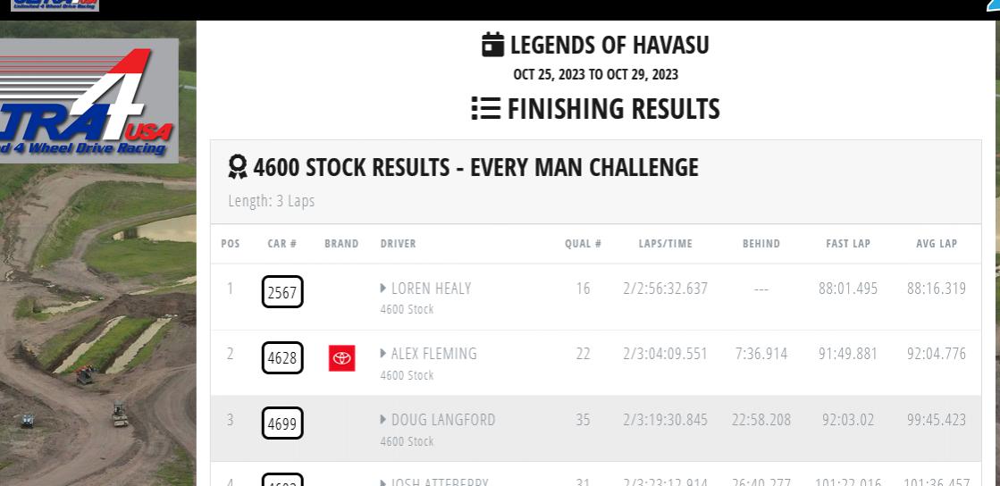

If you're [MENTION=413201]SherpaEquipmentCo[/MENTION]
You got a podum finish! Congrats Boys!!
