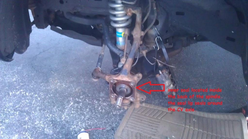

Replaced my driver side wheel bearing today. Took a few hours because of no power/air tools and a seized rotor which took an hour and a half in itself lol. Going to do the other one this weekend which should take 1/4 of the time this one took.
Did you change the inner seal in the spindle. It needs to be replaced with the new hub bearing to prevent debris entering the bearing area from the CV axle side of the spindle/hub assembly. (arrow indicating location)
No I did not. I ordered the fully assembled hub/bearing assembly that supposedly included all seals and everything and just threw it on.
