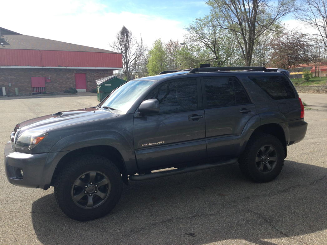

Finally got to put on t4r.org sticker...thx momo!

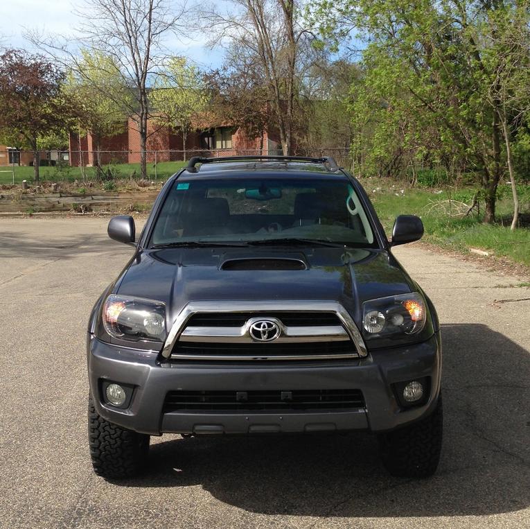

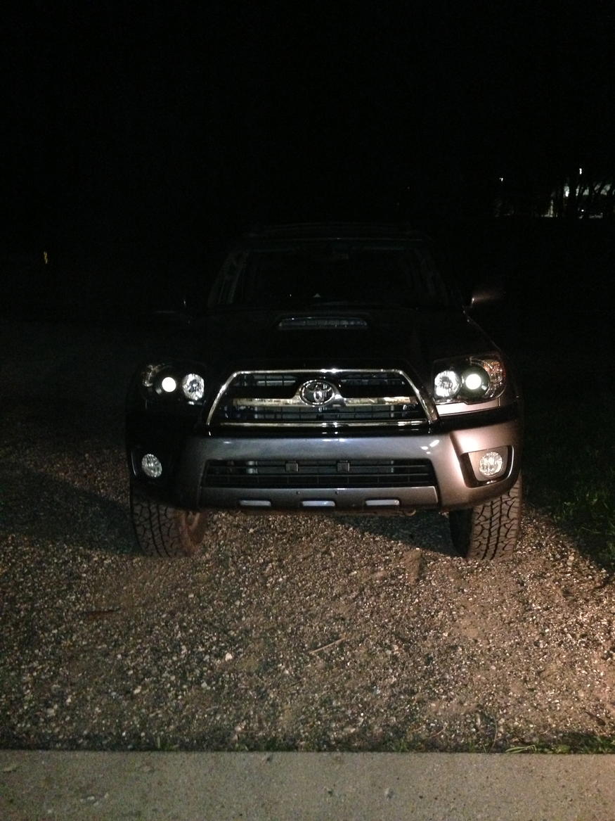

Anyone consider Lamin-x-ing both the fog and the turn signal? That way they would match. I think that would look kinda cool, at least it seems cool-looking in my head.

It really doesn't affect your vision at all. It just makes it easier for other drivers to see you
that's not true, yellow light makes it easier to see in fog and snowy conditions because the light doesn't reflect off of the moisture in the air as much making it easier to see further.

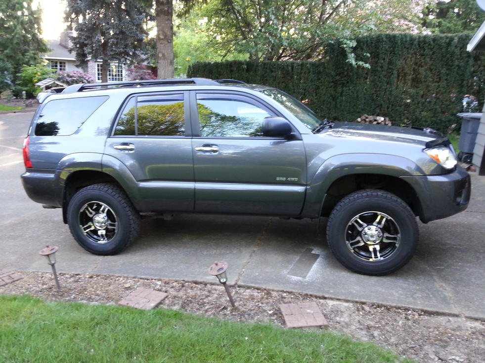

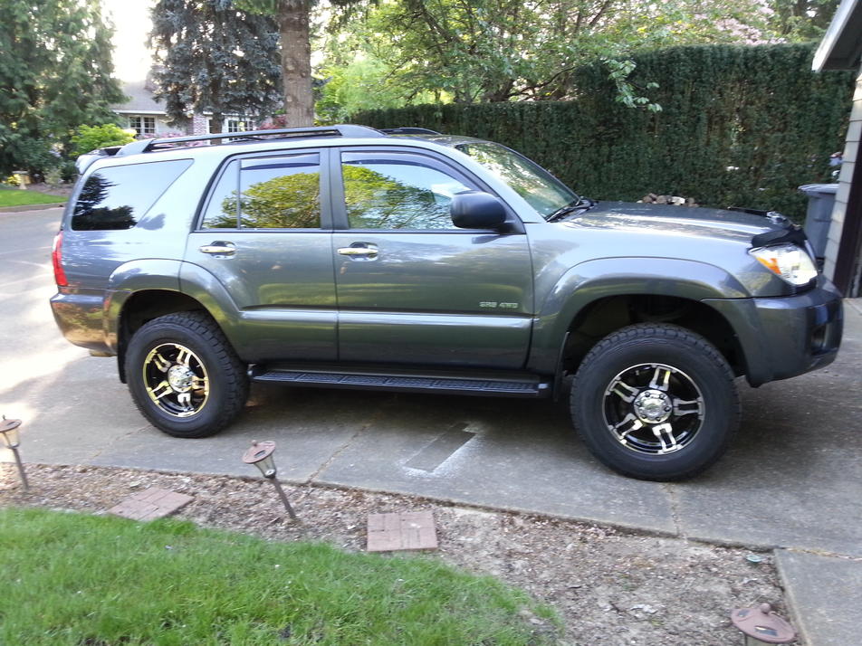

I finally pulled my running boards off.... they were nice keeping crap off the side of the truck, but that's it.

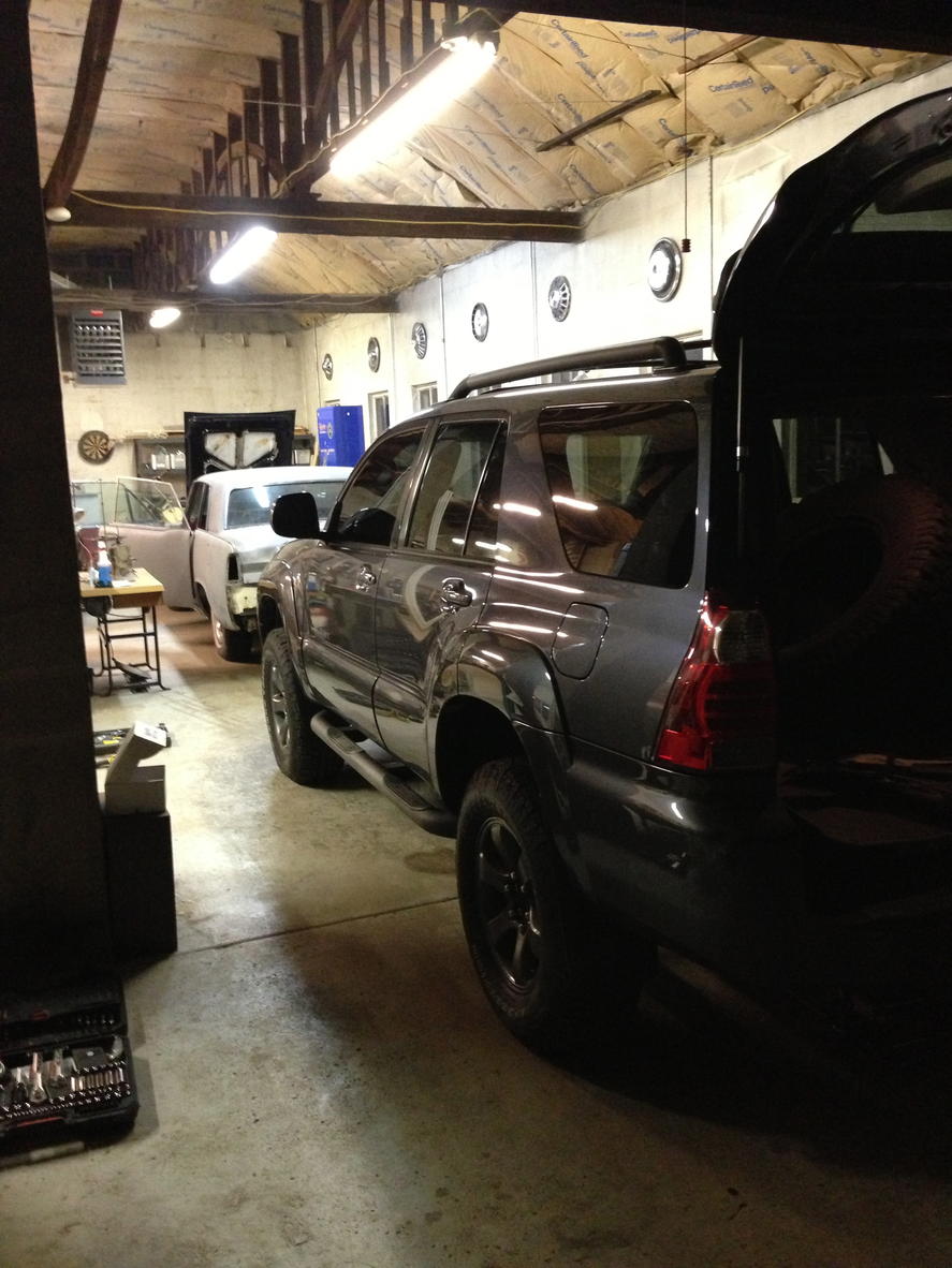

swapped out my bilsteins for tokkiko trekmasters from sonoran steel today. 3rd gen upper rear shock mount is inconvenient at best.

Not today, but this weekend: Daystar, Spidertrax, tires, tint and finally finished the headlights.
