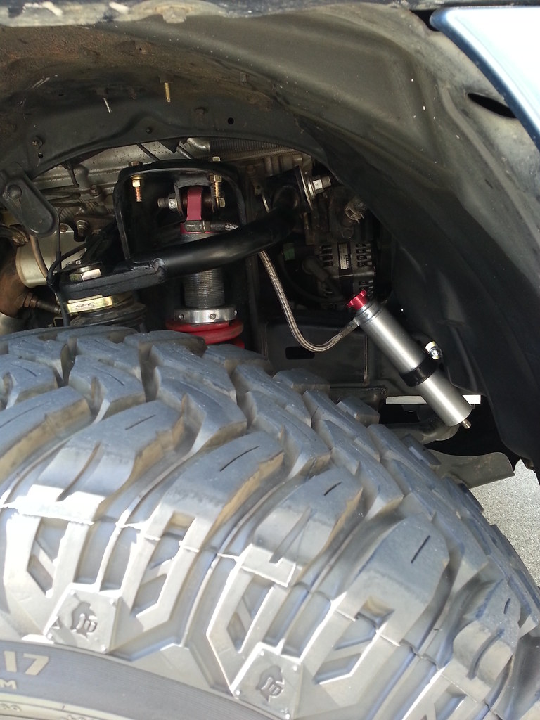

What rate springs do you have up front? I think mine are only 600# with a V8, but the stiff valving makes up for the light coils. I've thought about stepping up to heavier coils myself just to lesson the preload on mine but aren't willing to do so at the cost of a harsher ride. Your fronts are 2.5" or 2.0" (forgive me for not looking). Getting your custom valved will be the way to go. Might be a little PITA but worth it in the end.
I believe mine are 550 or 600 springs but i could be wrong. I have a good preload on them and they finally maintain height. They're 2.0s but i have adjustable resi for soft/stiff ride. I have it fully soft right now and it floats over everything even with mad preload.
Holy pre-load, them hoes are cranked!! When I installed mine, I was able to get 3" of lift with only about 9/16" of thread showing. After my bumper and shock rebuild I cranked them up to 1". I've got about 4" of suspension and 1" body lift (5" total).
Hell with that adjuster it should ride however you want it no? Those are nice.
haha RIGHT?! its hard to believe these were on a Tacoma and were preset at 3" when he shipped them to me! I had to crank at least a few threads to get to my height im at now. At least they ride super soft and have low miles on them. I cant complain for $500
