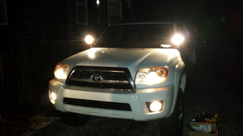

Ditch Lights
I finished up this project finally!

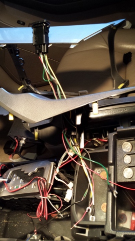

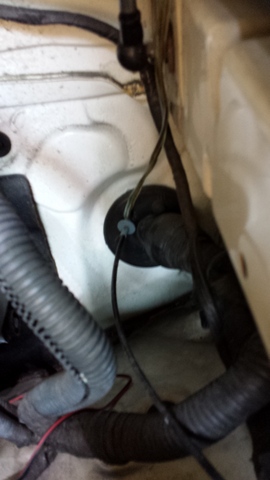

I fed wires through the firewall where the hood release cable passes through.

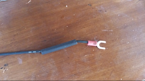

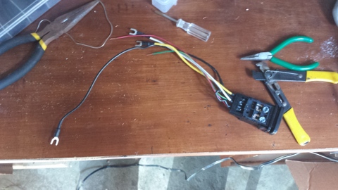

Made my wiring harness for the FJ Fog light switches. Crimped, soldered, and shrunk wrap everything:
A good reference for the switches is here:
http://www.toyota-4runner.org/4th-gen-t4rs/138349-fj-foglight-switch-wiring.html
and here:
http://www.toyota-4runner.org/4th-gen-t4rs/79263-fj-aux-light-switch-wiring.html

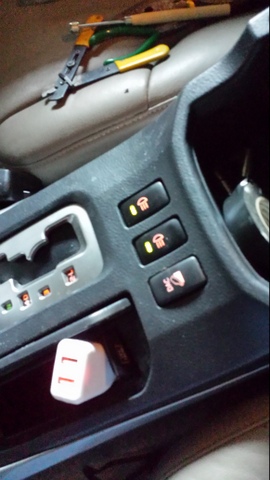

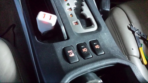

Here is the center switch going in, outboard (passenger) is already in here.

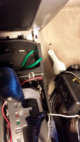

I took Constant 12V from the lighter socket. I took illumination 12V from the cup holder illumination (pictured just below the green pliers). I chose not to create any logic to tie these into my High Beams, I do not plan on using these on the road.
Here is the night illumination in action!

Ditch Light, continued.
Just to prove that the "on" light works too!

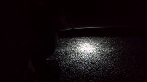

Since I was going to wire two switches (to have scalability in case a bumper happens), I decided to hook up some cheapo rock lights. $6 bucks on amazon, and they get the job done!

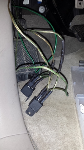

Here are my relays after just being hooked up. I used some old speaker wire I had from an old stereo install in my 944.
CBI Ditch Brackets, KC Daylighters ($100, prime-able on amazon)
Crappy picture of my rock lights in action too!
Hope you like it! :becky:

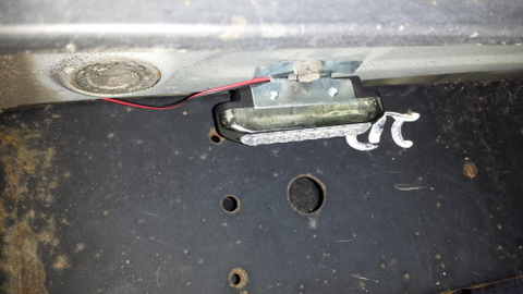

Any more close up pics of how it mounts to the car?
IMG00438-20110329-1731.jpg~original
That isn't my pic, but you get the idea. There are 4 little screws on the mount and it basically wraps around the edge of the tailgate. It's a neat little mount. I can post more tomorrow if that doesn't quite clear it up
