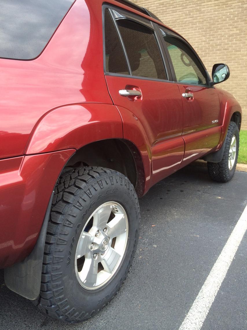

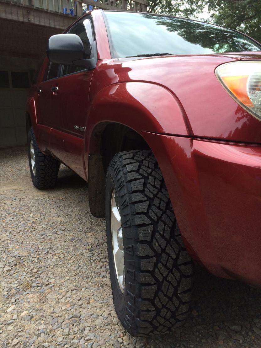

Installed GY Duratrac today.drove 100+ miles today to break them in:). As quiet as the Bfg long trails!!! Absolutely blown away by lack of hum or roar. Amazing. Also, I went with 255 instead of 265. Had noticed "walk" with spacers and the 265s. However that was gone with the narrower 255s.
Very happy so far.

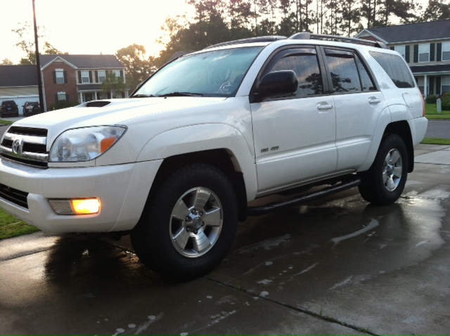

Pics of the Terra Grapplers installed? I'm going to be running this size but haven't chosen the tire yet.
My apologies for the delay, didn't see the quote notification until now. I can say I am LOVING the tires though!!

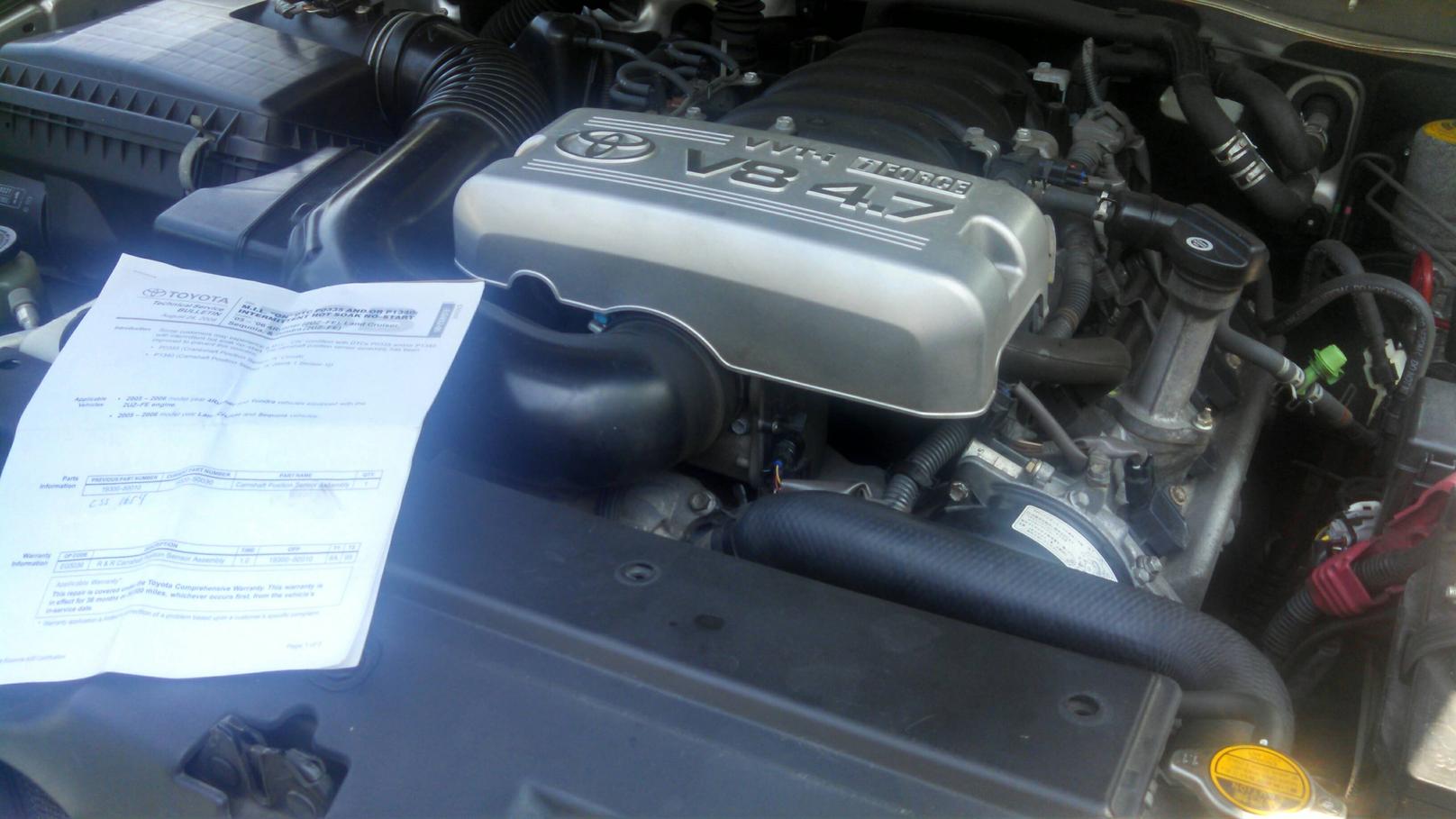

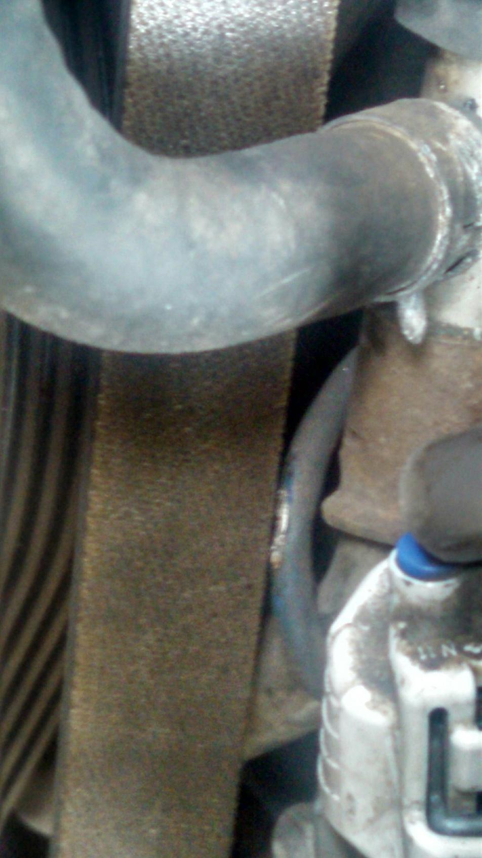

Todays fun:
I was preparing to tackle the camshaft position sensor issue my truck was having today..As I Began taking stuff apart, I notice a wire hidden behind the adapter to the throttle body and covered partially by an oil cooler line..
This wire was the plug to THE CPS. It was being cut in half slowly by the serpentine belt and shorting out the sensor. well the only reason the wire was exposed is because the shop who did by timing belt did put the sensor wire incorrectly into the wire loom behind the oil cooler lines.
I went to the shop, showed the manager and he admitted total fault and he is taking care of the part and labor charge. It was an obvious mistake however its a mistake that if I didn't see would have cost me $300 just for the part.

At least he owned up and took care of it
