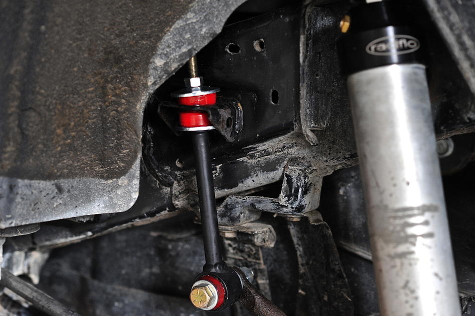

Extended Rear Sway Bar End Links installed
Been wanting to get to this for a while now; waited and waited for some adjustable end links from Red Eye Fab but after initially looking like it was going to happen... emails began to disappear into the void so I found some for the FJ at Summit Racing (Part # SJA-SBE702) thanks to JD914. (Cost ~ $63.00)

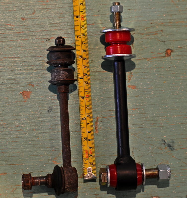

They appear pretty well made although the sleeve that goes inside the lower poly bushing is rolled steel with an open seam running the length of it so I worry that it could deform inside the bushing when stressed and then fail. I'll keep an eye on that.

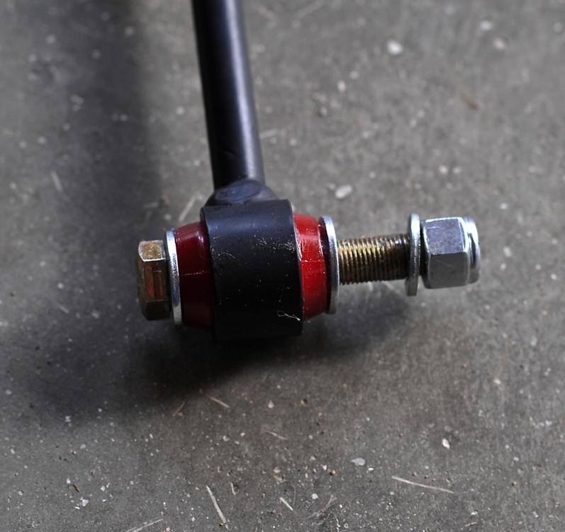

There was also a washer missing that I felt should be part of the kit. This is the washer that I positioned between the lock nut and the sway bar. That part is going to move a fair bit so there should be a washer there or else the sway bar is just grinding away on the nut.
Summit Racing has a poly bushing lube that is clear and really viscous that is used to keep things quiet. Its pretty cool stuff but it doesn't want to come off so careful.

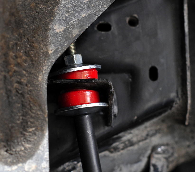

I did not need to do any drilling; the 1/2" lower stud fit perfectly into the existing hole in the sway bar.

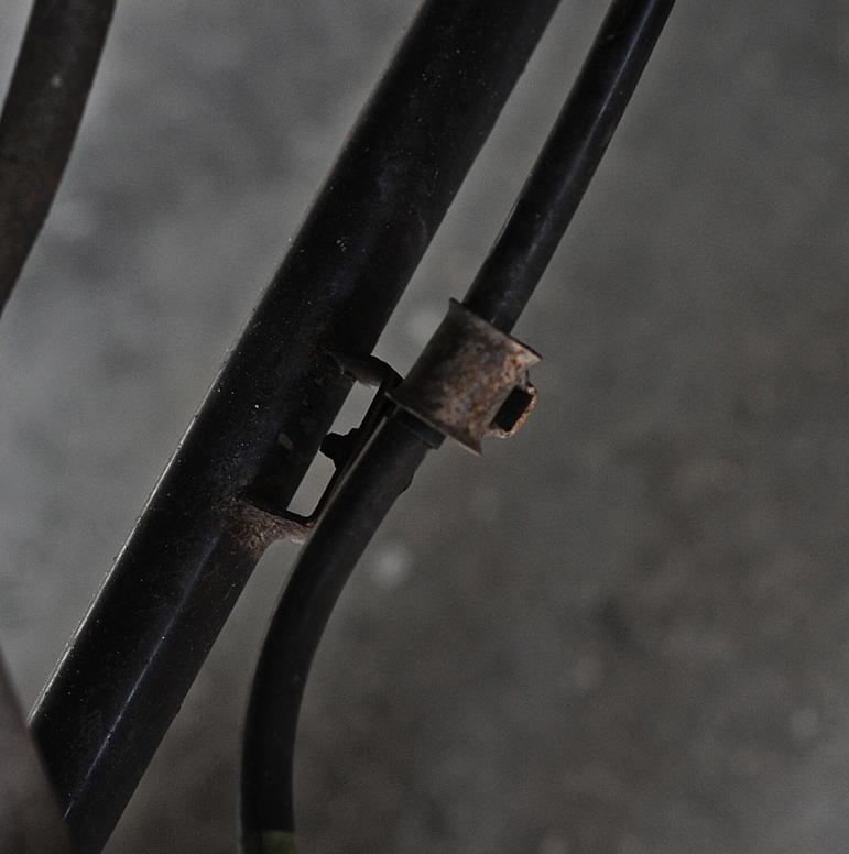

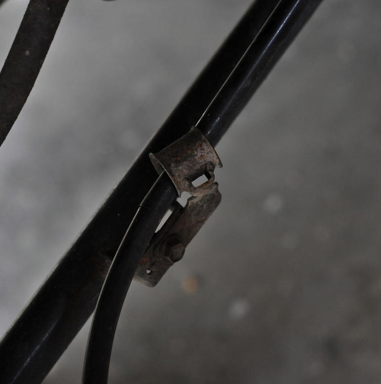

I relocated the brake lines outboard by bending the existing brackets; this worked fine and no clearance issues.
You do need to pick up those two 1/2 inch washers.

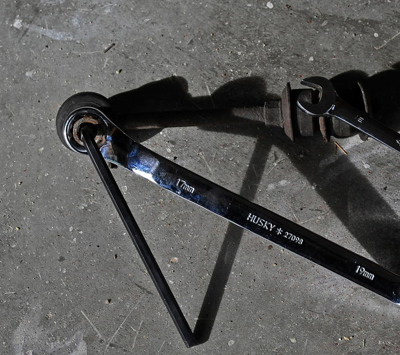

Need to have a 6mm allen key to prevent the OEM stud from turning as you remove the bolt that secures it.
The old and the new:
The missing washer is the last one on the right:
Use a 6mm allen key and 17mm box ratchet to remove lower nut:
Brake line repositioned outboard by carefully bending existing bracket:
Before:
and after:
Potential wear issue due to lower poly washer being a bit too big:
Final product:
Before:
and after:
Final product:
