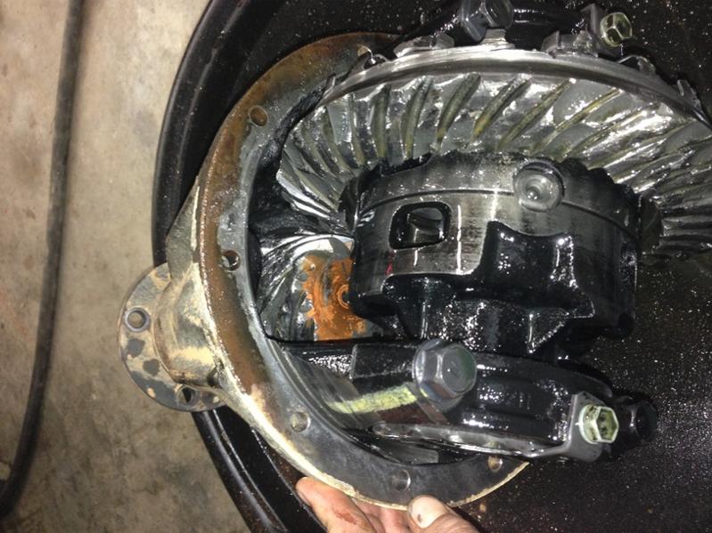

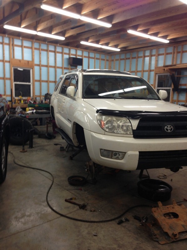

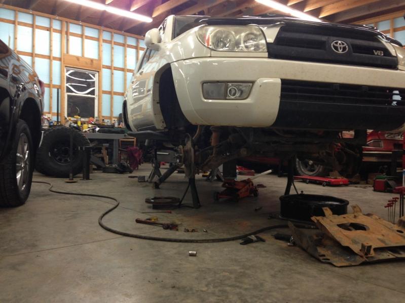

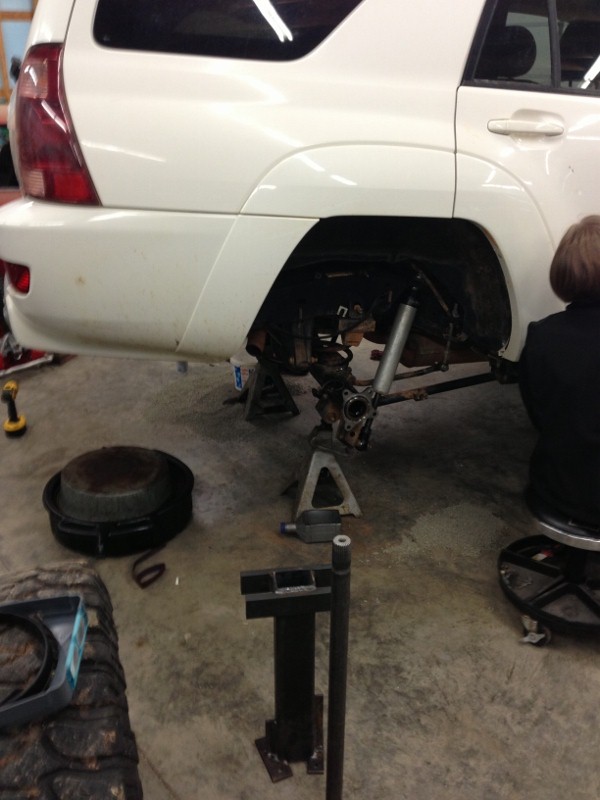

working on complete dis-assembly of front and rear axles to make room for Air lockers and 4:56 gears... an well the other day i should have posted the last pic showing what i did then which was destroy the rear ring an pinion gears :surfer:

is that rust? if so is it supposed to be there in the last pic?
the carrier housing has rust build up where it seats to the axle housing. but the orange color seen on the pinion is remains of the marker paint used to insure proper gear engagement.
i will say it's likely water that got into my axle over various off-road trips and one nasty mud bog competition that caused it to bite the dust. I'll be running lucas 85/140 non synthetic gear oil in my new carriers it doesn't break down under heat like synthetics that toyota recommend do. but then again I don't drive in the toyota recommended way lol..
