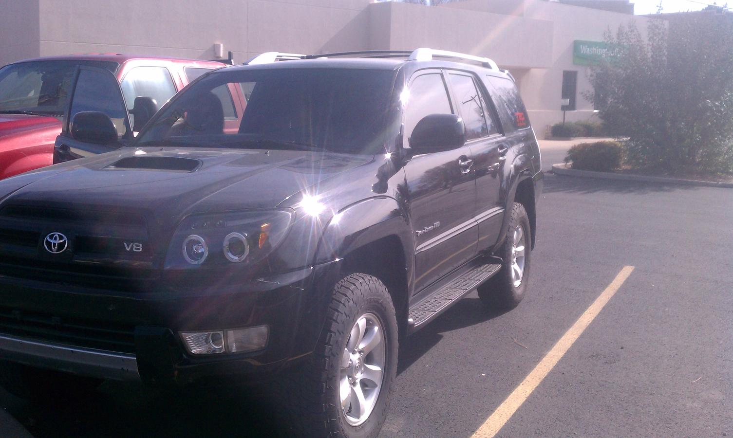

Before...
2012-10-24_17-46-24_934_zps31d53f3b.jpg~original
After...
2012-11-19_15-55-34_731_zps12c4cbf1.jpg~original
Wow looks great JD, nice work :banana:

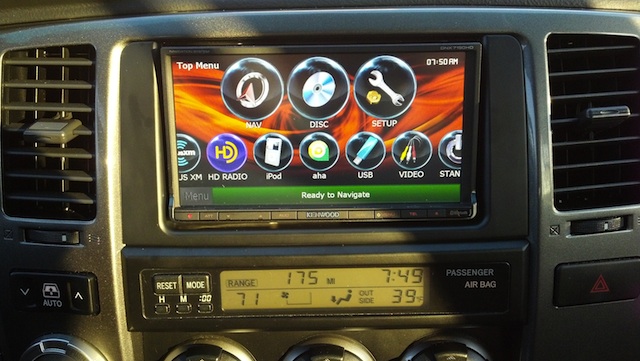

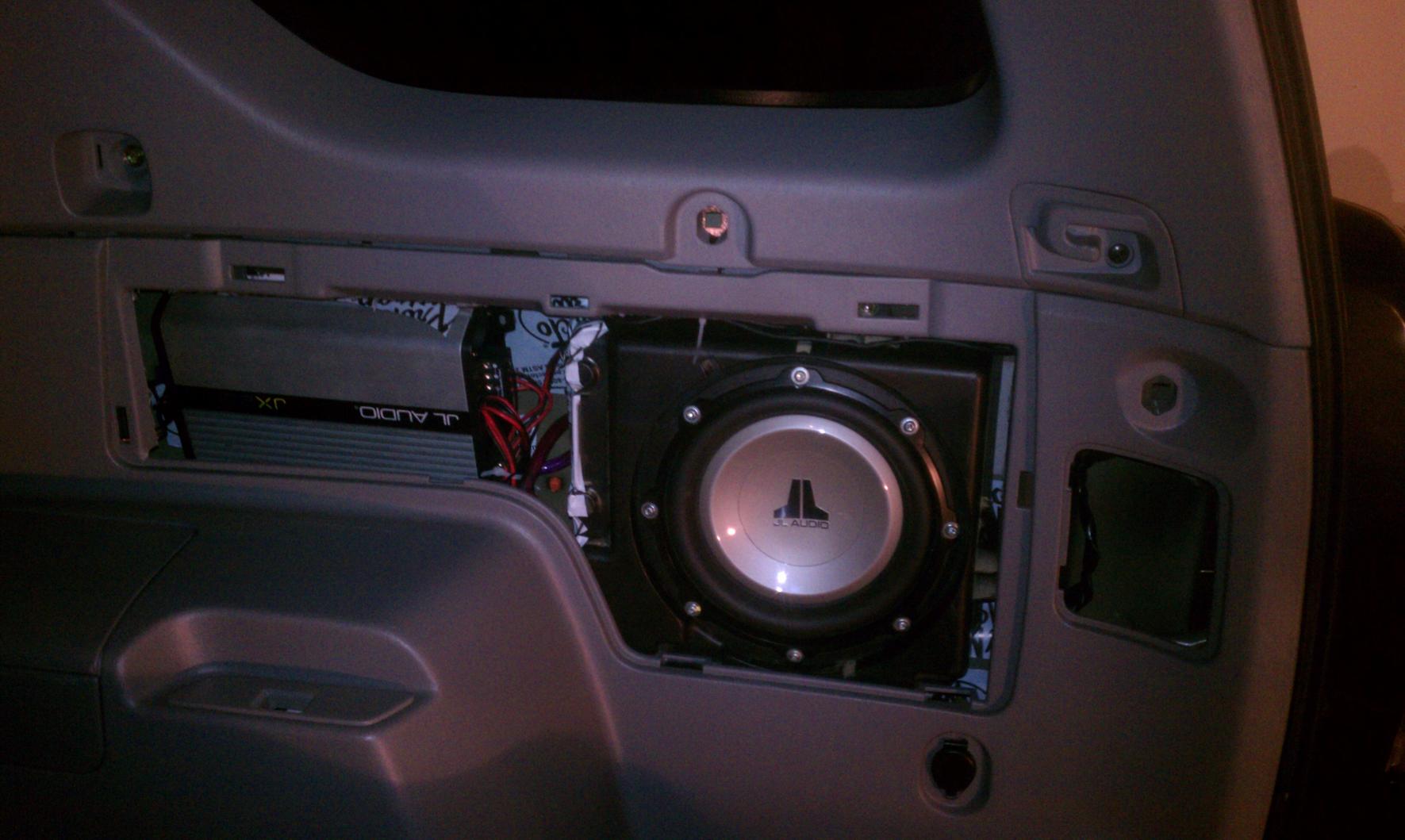

After buying my 2004 from a fellow member, I needed to do the 100,000 mile maintenance and decided to upgrade a few other things....including but not limited to :
1. JL AMP & Sub install utilizing JBL enclosure - I added this to a NON JBL 4runner FYI - used a prior members notes and pics and it seems to work fine.
2. Kenwood DNX 5120 with IPOD cable from a fellow member
3. PAC SWC module, to regain use of my SW control buttons - eBay
3. Bluetooth SW buttons from Tacomaworld Member

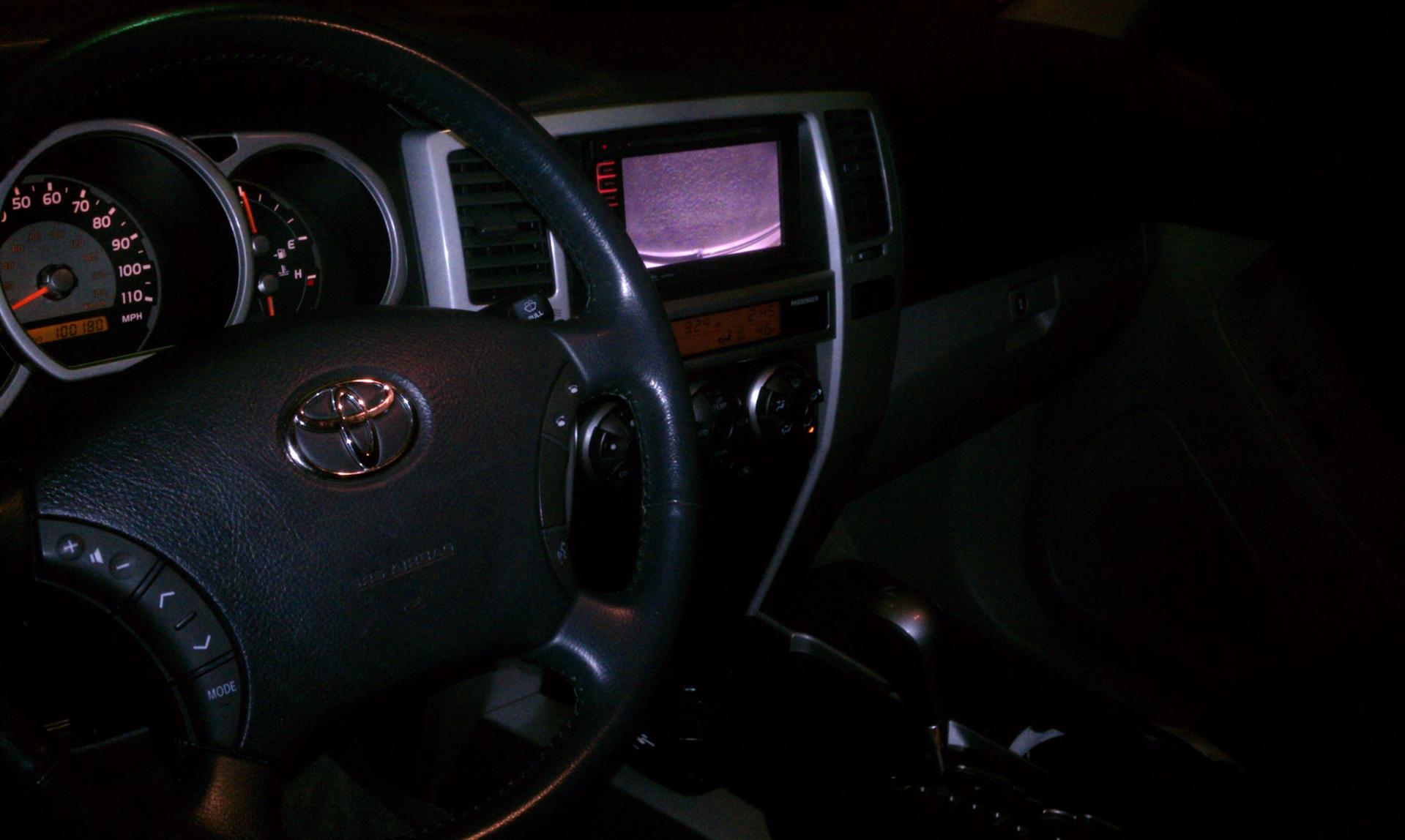

4. BOYO rear license plate camera - eBay
5. Limo tint with JRD Decals
6. Water pump, pulleys, timing belt etc. changed -eBay OEM Kit used, dealer installed parts.
7. Replaced the spark plugs with OEM Denso's - toyotapartscheap.com
8. Replaced front & rear brakes with OEM pads
9. Projector headlights and blacked out tail lights - eBay
10. Checked diff's & transfer fluid - Like new
12. Replaced Air Filters - OEM filters - toyotapartscheap.com\
Next is Katzins with heaters, Bluetooth module to actually program my new buttons, and Icon suspension & eventually a hidden front winch...stay tuned.

Awesome I guess my enclosure made it with good time! nice job yo!
