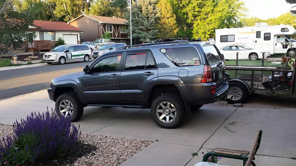

Installed Icon uniball UCAs and went up from the 1st to the 2nd notch on the Bilsteins. Taking measurements after work to see how much height was gained.
What springs are you running? I was thinking about going up a notch too, how hard was it to change? I was thinking I could just remove the UCA and hook up the spring compressors and compress it enough to take the clip out and move it up a notch.
I'm running the Toytec springs. I was happy with the previous height but my Shrockworks bumper should be coming soon and I wanted to go up a notch in preparation for that.
I thought it would be that simple also but it was not. I removed the assembly from the vehicle and used 2 spring compressors. I thought I would be able to compress, adjust the snap ring for the perch, release compression and be finished. No sir. You will have to compress, remove the hat on top of the spring, then remove the spring and adjust the snap ring. Reassemble and reinstall. It's not difficult but it's tedious. I don't plan on adjusting mine ever again unless my bumper really drags the front end down.
Thanks the info! I was worried about that. Looks like I'll be waiting until I get new UCA to tackle this job again.

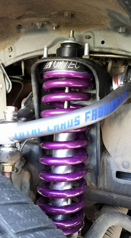

Just had to look outside and admire all the beauty......and heres the purple coilovers & TC UCA's we installed last week!!
