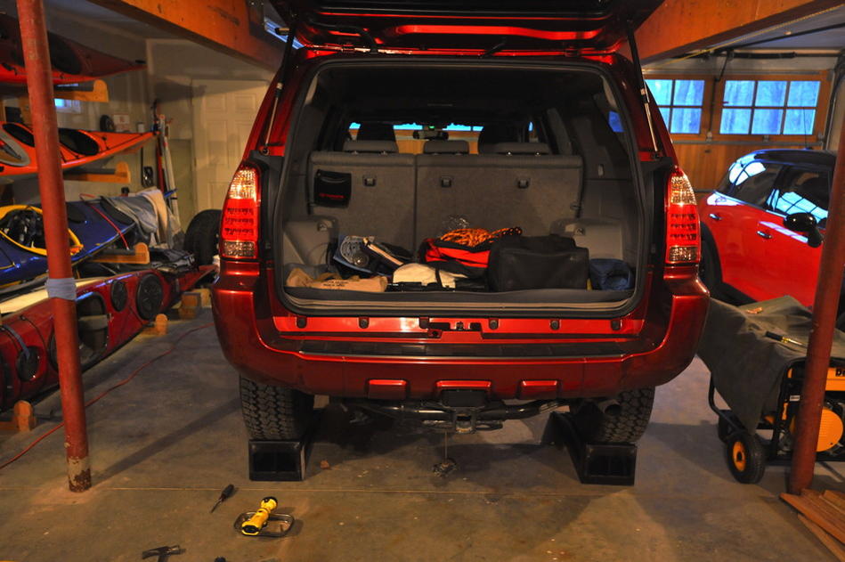

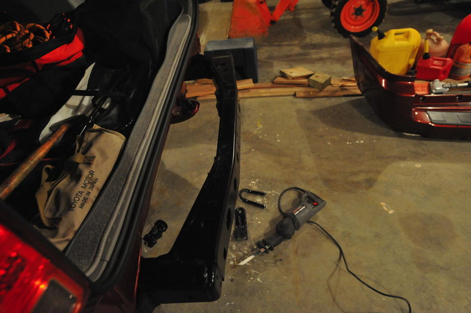

Drove her to work to have some fun on my day off!
Did some work on the back end ...
Before:
During:
"After" has yet to be completed.

any noticeable difference? I want to get rid of my ugly resonator but worried it'll be too loud.
I cant tell a difference. Some people say you can but i cant and my gf hasnt said anything about it being loud so if it made any difference it's little
