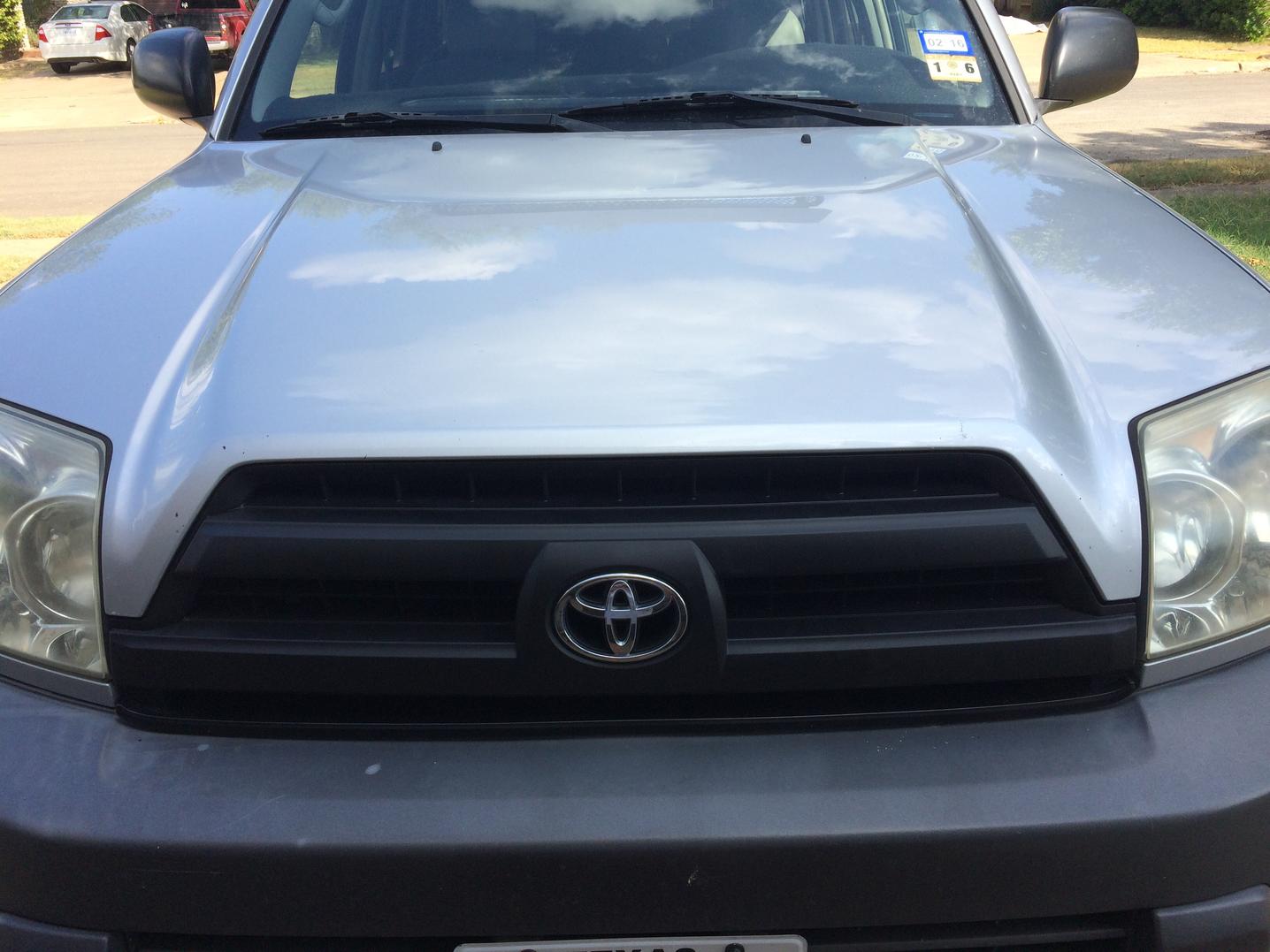

I am new to the site and have looked everywhere i know to look and havent been able to find where to post this so.... I have a 2003 v6 2wd that i like to have fun with in the fields but the traction control is really holding me back. I know there is an easy fix for the 4wd models, but havent been able to find a fix for the 2wd. Please help!

Look here: http://www.toyota-4runner.org/showthread.php?t=187143
This erases the calibration of your yaw sensor which will in turn deactivate both your TCS and traction control. It's easily reversable and only takes around 30 seconds to do. It should work for both 2wd and 4wd models.
