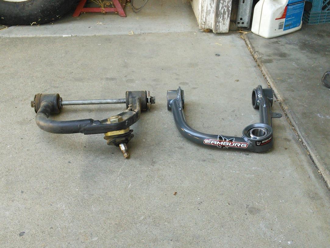

Last weekend I decided to up grade from a up grade. After feeling how much slack
play was in the BJ, didn't like the feeling they would brake on me while wheeling, especially with low miles on them.

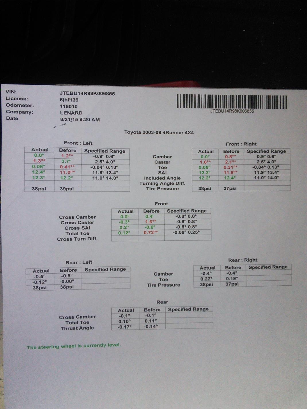

Took her in before work this morning since the alignment I had done after install was unreal, I know the Camburg are not easy to get to specs. Did some searching for 2days and found a guy that knew his sh!t. Feel pretty close to it was before modding it.:dancin:
The guy took it for a spin, came back, said it felt like it had a slight pull so he switch the front tires and through it back on the machine. Drove it again and then he was pleased with his work. Talk about service for $65.

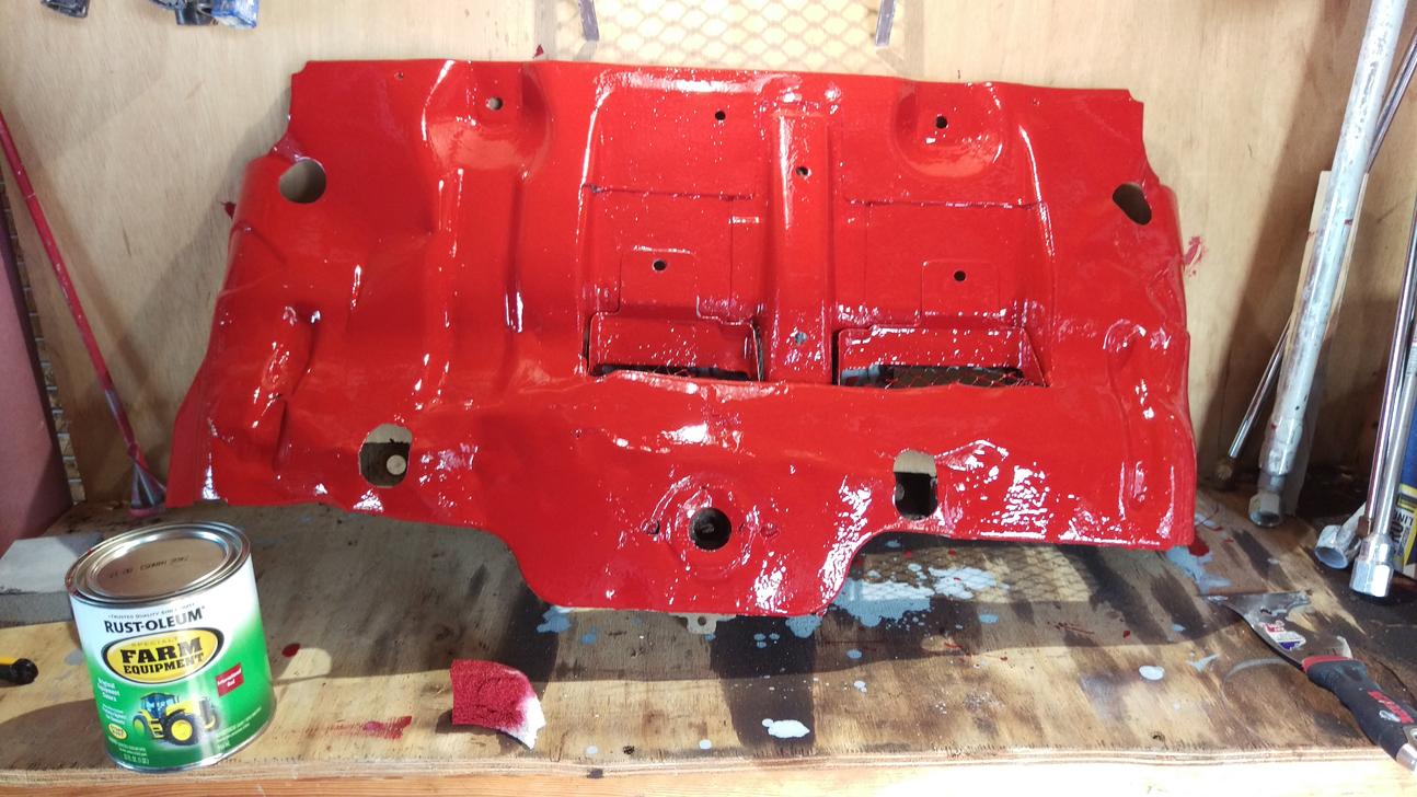

Cleaning up my skid plate. I pulled the front one off and used a wire wheel to clean it up, found out how mangled and rusted it really is. Will have to devise a new skid plate soon. The skid under the motor is stuck for now with seized up bolts. I used 2 coats of Rustoleum filler primer and sanded it down. I then put a coat of Rustoleum tractor paint on it. I have to do one more coat of paint then flip it over and do the underside. Here's a pic of it still wet. uploadfromtaptalk1441112714661.jpg
