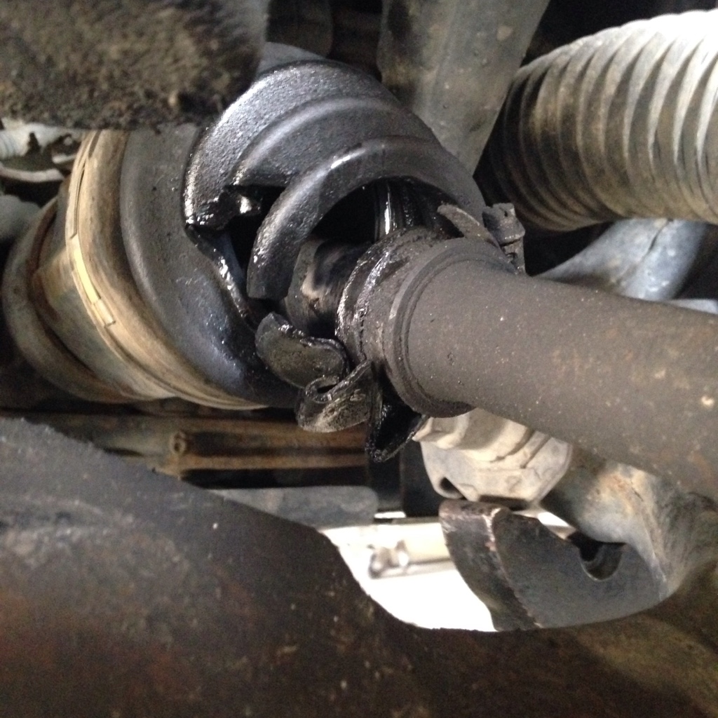

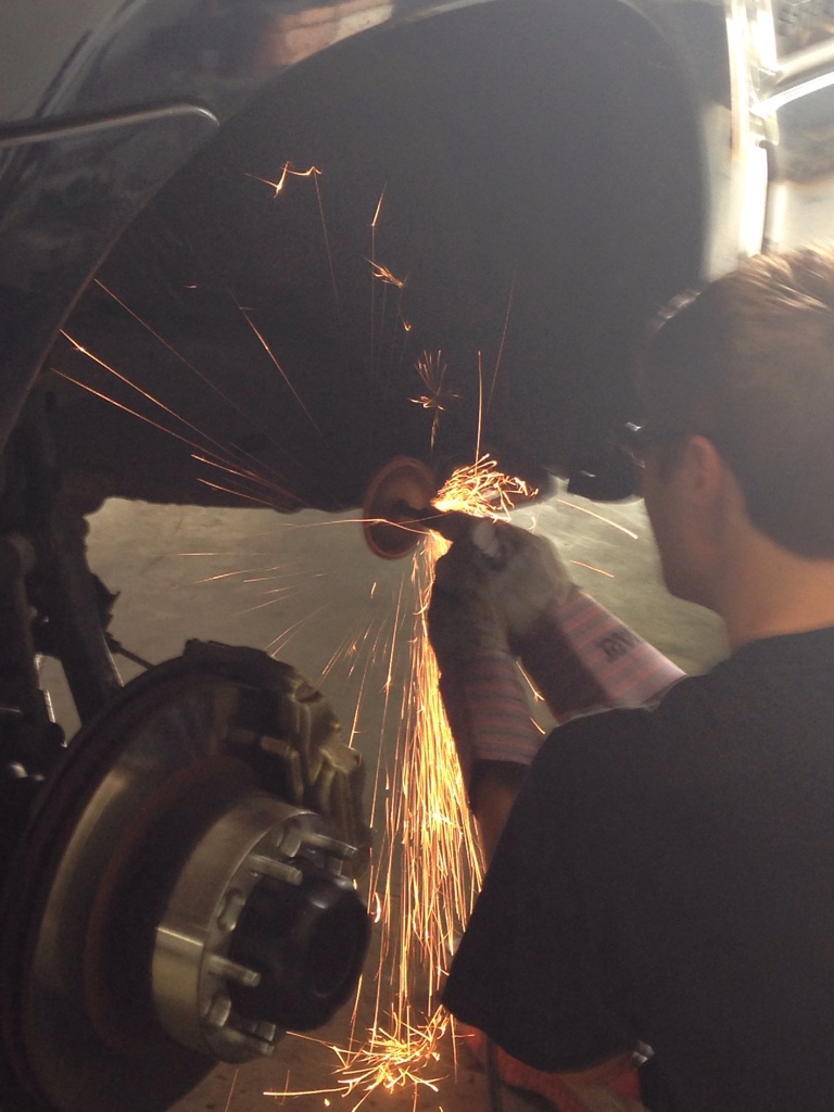

Cut some more off my body mount cause I rub like crazy still... Also I think it may be time for new cv's sometime soon

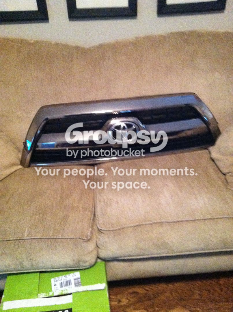

Got my chrome grill finished up today with a little wet sanding and polishing.
From
to

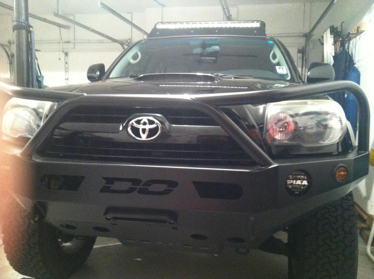

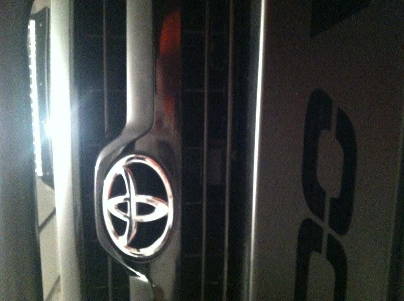

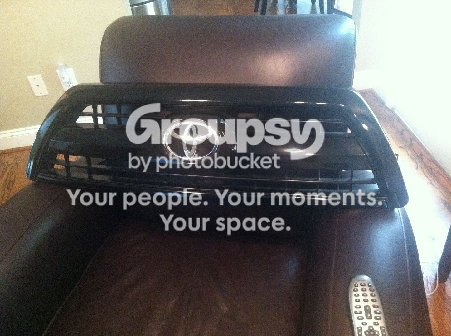

When i got my Demello bumper installed it left a huge gap under my stock 03-05 grill. This is the reason i decided to buy an 06-09 grill. When i got the chrome grill i just started working on it by sanding, priming, painting, wet sanding and polishing. This is where that second pic left off
I figured the hardest part would be to make the longer rod for the secondary release. I went out and pulled my old grill and installed the new one. Lowered the hood to see how close it was......it wasn't even close to fitting. I spent several hours cutting, grinding and test fitting. I finally gave up and put my old grill back on. Today i decided to give it another stab. I ended up cutting over an inch off the bottom, just above the bottom cross bar. The metal frame has an "L" shape to it across the bottom. I cut the vertical portion off, leaving the flat part. This did make it slightly weaker so i installed small screws all the way across the bottom holding the frame to the bottom of he grill. It is plenty strong now. I still have to make the longer rod but that can happen another day. Just glad to get this part done. Better pics to come

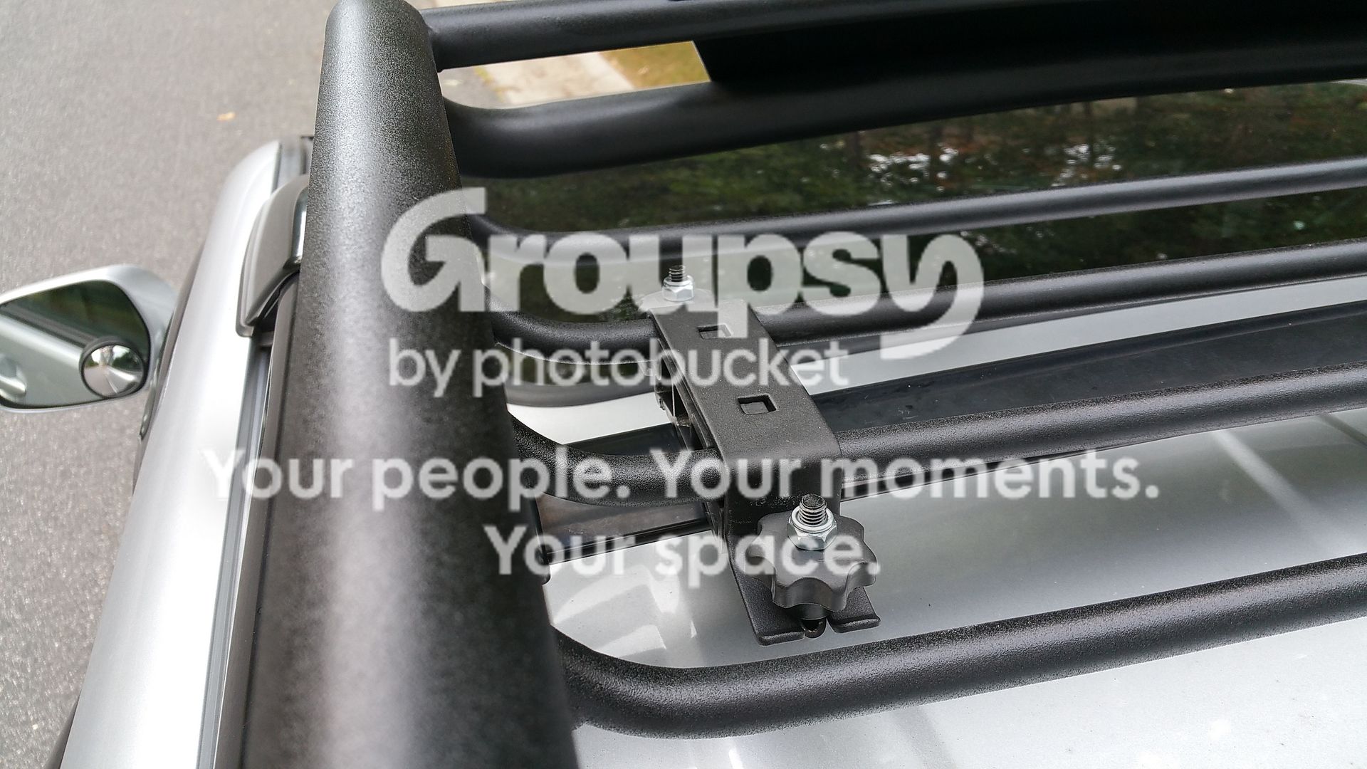

i didnt like the idea that someone could just walk up and take my rola rack off by hand so i added some lock nuts. not that it will help for someone with tools but i see no need to lock the thing to the truck
