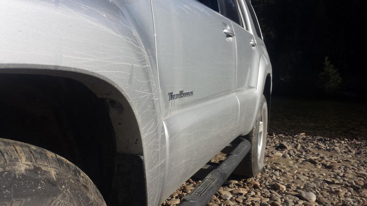

Went out with some friends for some trigger therapy and found an easy trail with a decent view
Here's the aftermath

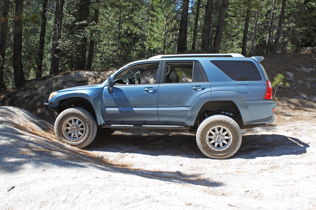

Finished up the lift today. All told, 11 hours. That's including a couple shopping trips for a torque wrench and some blades for the sawzall. I had to cut the rear shocks off.
End result: Pretty well leveled. I didn't take measurements so not sure what I gained, but I'm guessing 2 in the rear and 3 in the front.

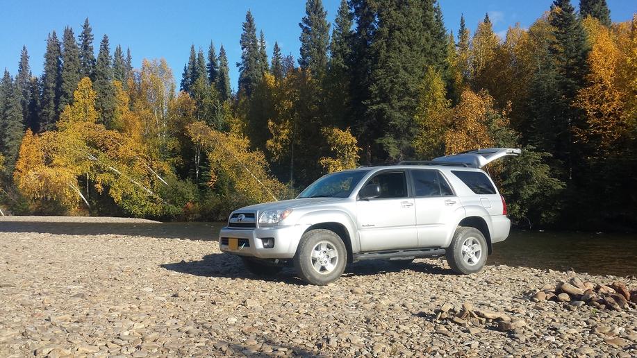

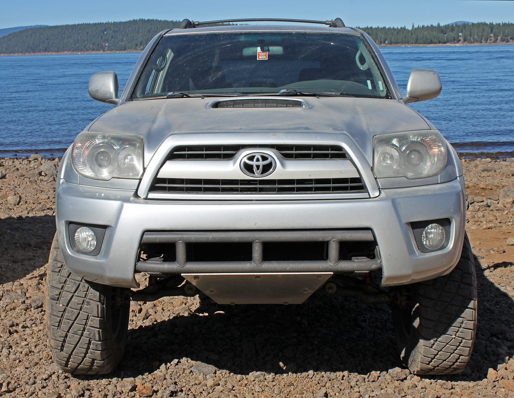

Went and scouted some roads/trails. Found a nice spot to camp on the river bank for the next time the wife and I need to get out of town for a couple days.
Also, these stock 4th gens have painfully low ground clearance. :ohwell:

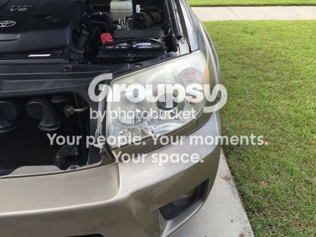

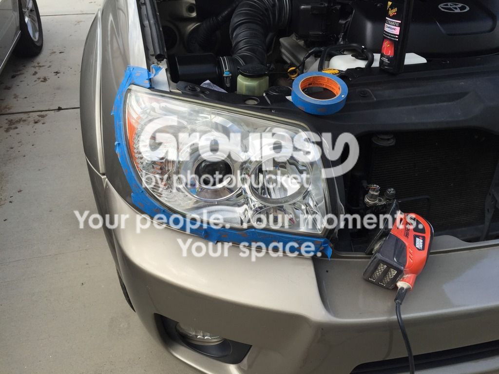

cleaned headlights
I spent alittle time and cleaned my oxidizes headlights. I used mothers polishing compound, micro fiber cloth, and a sander.
before
after

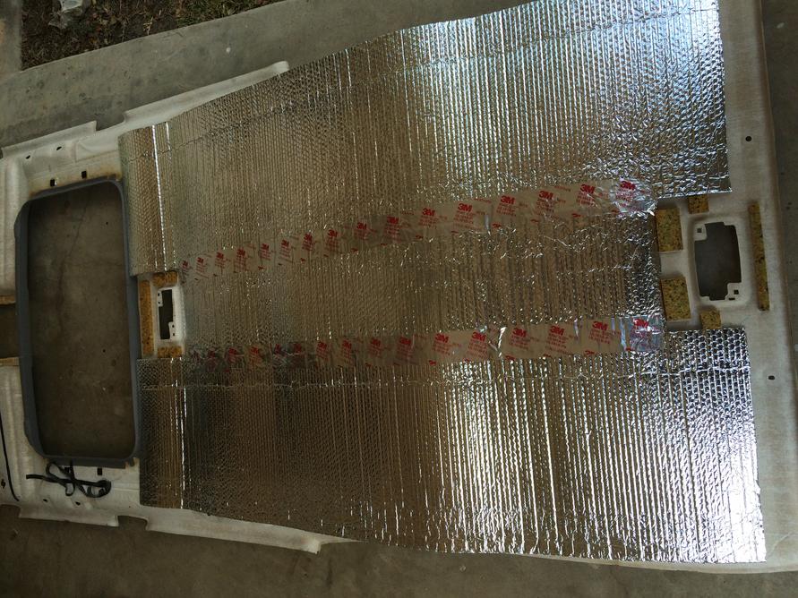

Took the headliner out, rattle proofed the underside, then lined the underside of the liner with heat reflecting foam. Not sure how much heat it will help discipat, but has to be better than just plain foam.

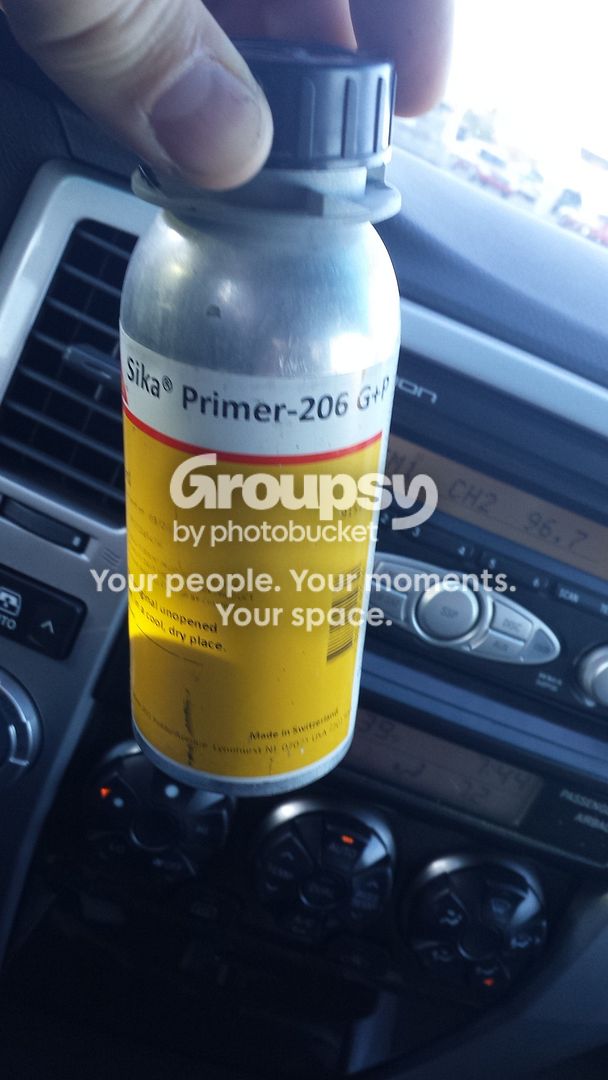

I painted my light cups on the SW bumper with an amazing primer/rust inhibitor called Sika Primer-206 G+P...this is used as the primer before windshields are installed to prevent and stop all rust from occurring...after sanding the cups with 80-grit sandpaper for the primer to adhere to, I taped off the light cups very well as this stuff will NOT come off no matter what...or at least once it dries a bit...nonetheless, I no longer have any surface rust occurring and hope this solves my issues with the rust...
The Primer:

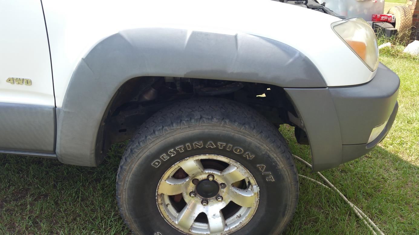

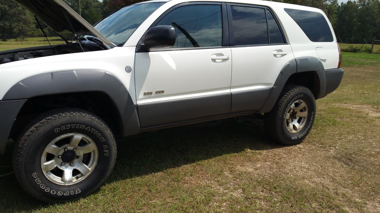

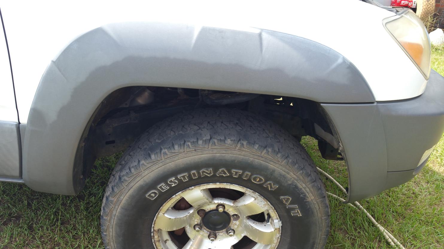

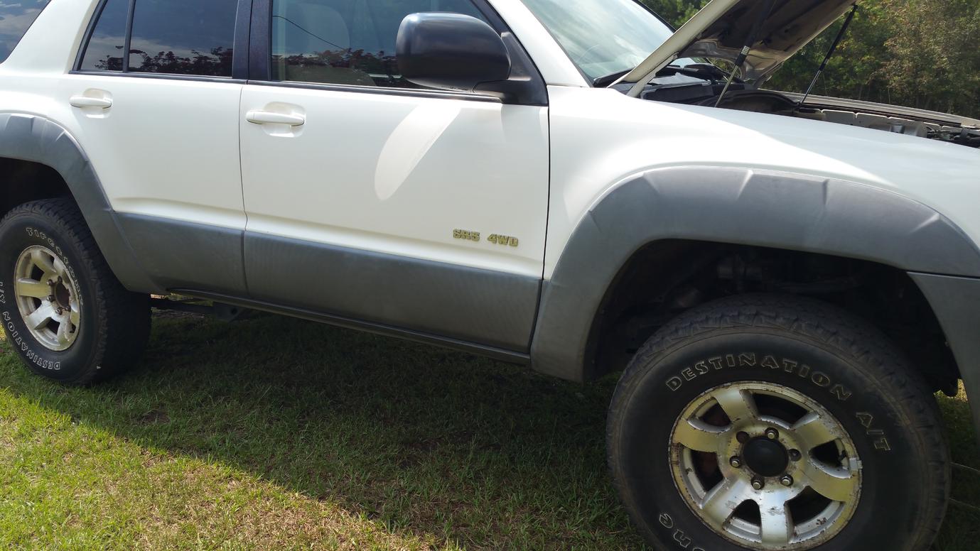

It was not today, but this past weekend I attempted the heat gun method for restoring my grey cladding. Figured I would share the results with anyone interested. The results are more dramatic in person.
Before: (It was the same on both sides)
Mid way:
After:
I will post the same thing in the picture thread. If anyone has any questions (although its pretty cut and dry) let me know through PM.

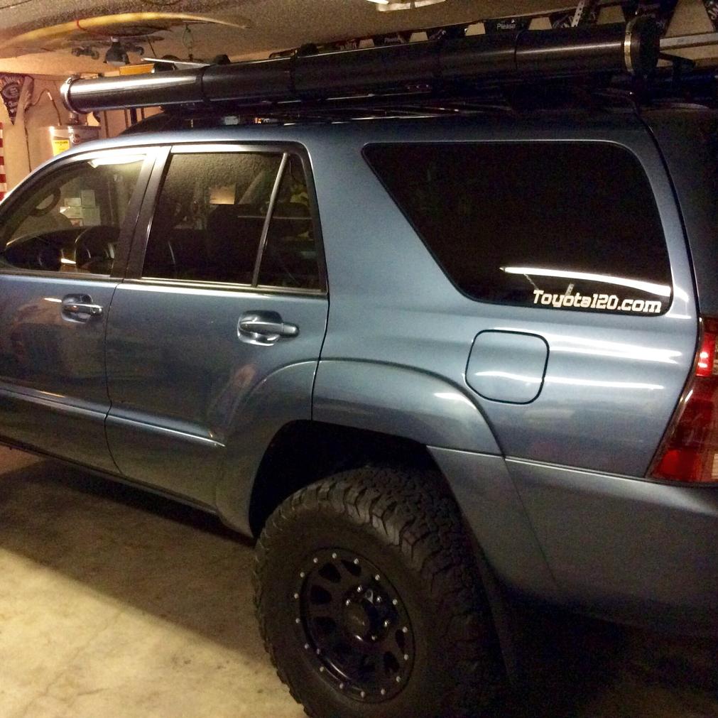

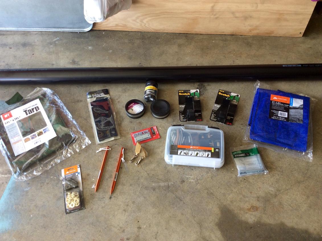

i ended up going with 4" pipe instead so theres a lil more room with all the poles and tarp, stakes, guy line, and lights to not damage things being so cramped. I cut out the center section about 15" from each end half way through and mounted three hinges allowing it to open down .
Still need to paint a few things black like the clamps, and poles.
Will post pics tomorrow with everything out and extended.
