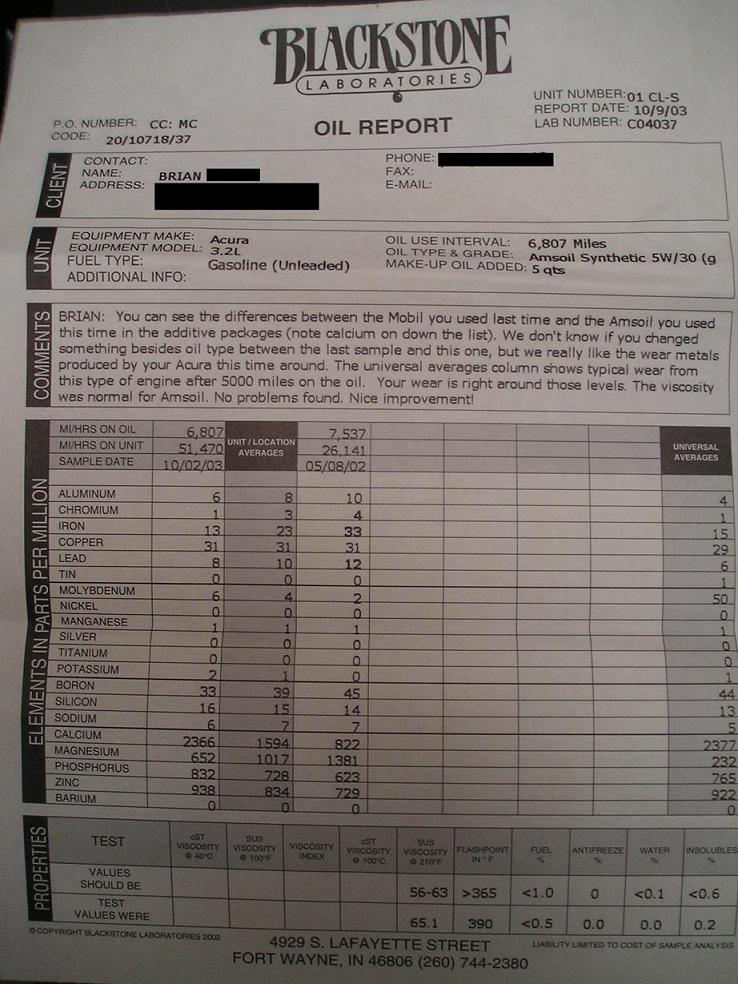

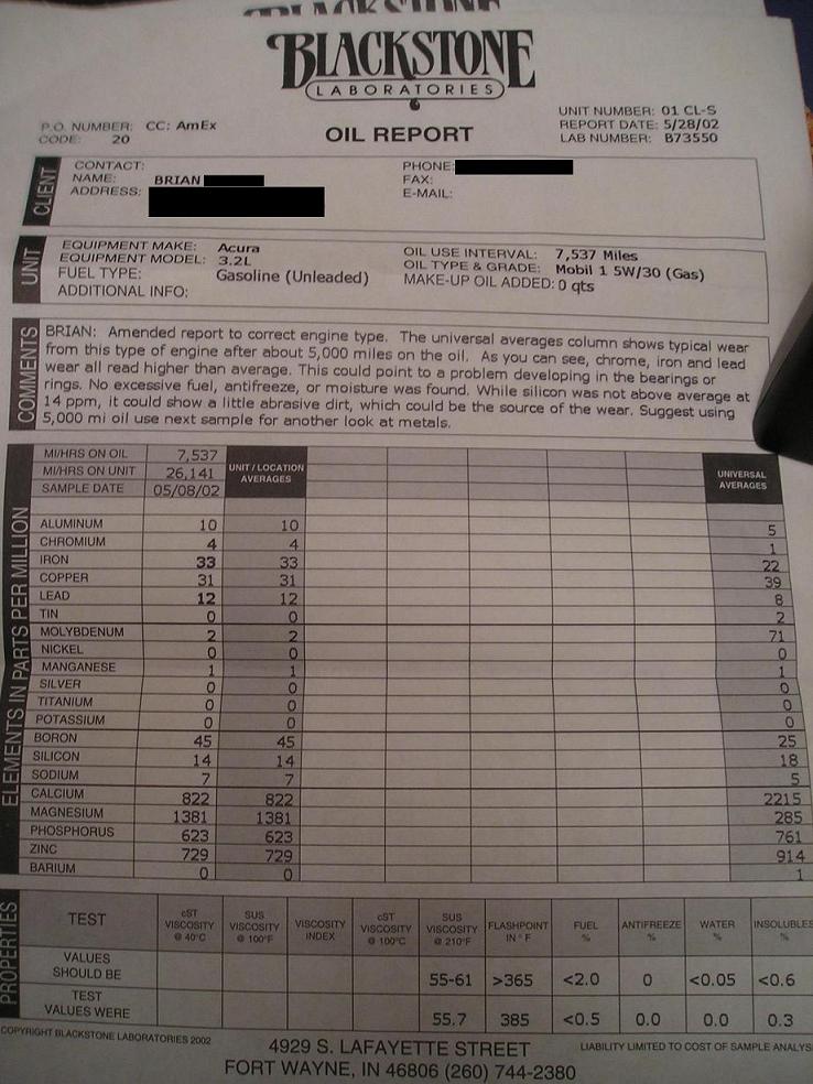

Mobil 1

Bluto, did you get the TBN performed on either of these UOA? That 2nd UOA is great! The Silicon seems a bit high.. but your wear metals went way down!
No 2 engines are the same. What works in one won't work in all. My current V8 is nothing like the Acura V6.
I don't drive a lot anymore. So I won't analyze different oils in the 4Runner to see which is best. Once I switch, I will analyze the Amsoil at 25k.

Bluto, what Air filter are you using on that acura? When was the last time you changed it?
I ran a Comptech drop-in foam filter, starting at 7500 miles. I cleaned and oiled it every 15k.
At the time, I was looking to extend my drain intervals past 7500. Based on the analysis, I did not want run the Mobil 1 7500 miles.
No TBN.
The Silicon is most likely due to my driving environment. A lot of industry in and around Baltimore. There is a silicon plant on the west side of the Key Bridge. I drove by it everyday.
