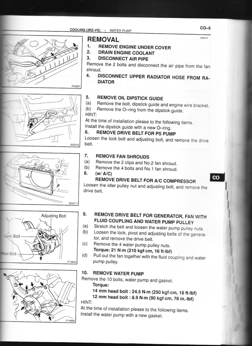

Here is the relevant page from the FSM which I guess you have. The on-line FSM is from 2002 and doesn't cover the 4cyl., but my paper '99 FSM does. Obviously, you don't need to remove the water pump. Stop at 9b. You probably don't need to drain coolant if you can leave the rad hose in place--I don't know. You may not need to remove the dipstick. Use your judgment on what is necessary just to do the belts.
