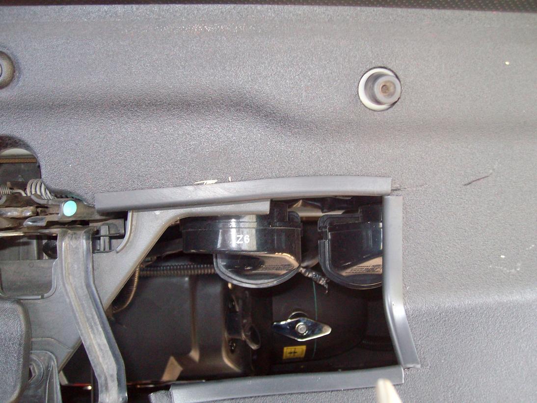

I'm running a ComeUp Seal Gen 2 9.5k rsi on my hidden winch mount, however not Budbuilt but most winches you will find will fit 9.5kishh. It's wireless, lil pricey, and you do have to disengage the clutch to free spool.
Easy fix though...

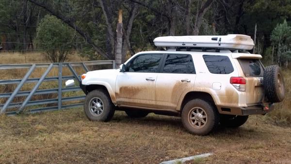

Warn 12,000# on Budbuilt hardware
Warn 12,000# winch on my '13 LTD fully armored by Budbuilt, best in the business, superbly engineered, provides 'peace of mind' on unmaintained forest roads/trails @ 34.2047, -110.9744
