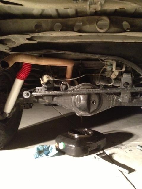

:banana: Things felt a "little tight" so I talked dirty to it until it spewed it's goo all over my lap.:frisky: *F'n Sierra Rocks Suck*
Replaced the GL-5 in the diffs and GL-4 in the trans and case. Shift's like it should.

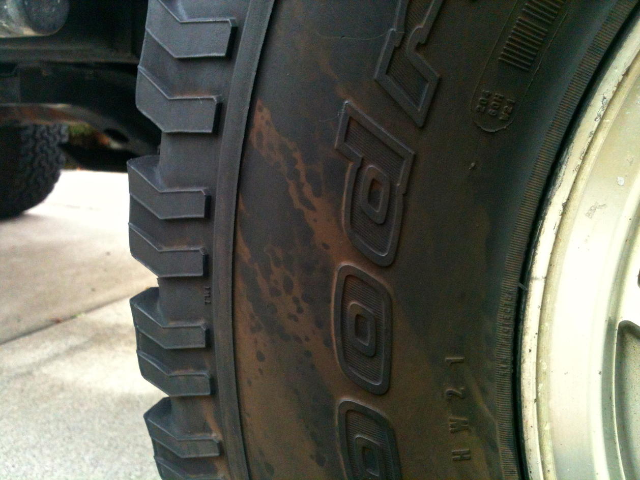

Finished the baseline process and decided to finish up the annual cleaning, pulled the dogleg (rear door/fender) covers, glued them back, and washed the rig down.
Apparently even though I washed the tires down first, Meguiar's HotShine Tire Foam DOES NOT like the saline-y-slit-Hollister Mud/Dust or the BF_Goodrich rubber because it did this to my tires.
Had to re-clean them w/ silicone spray to fix the problem and am gonna email this to Meguiar's for the warranty/guarantee refund.

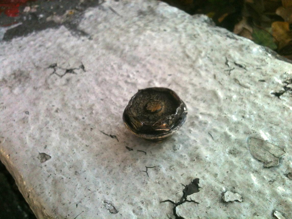

quite a busy weekend with ye old runner...
Fluids: front & rear diffs, TC, manual trans, and a fresh oil change...

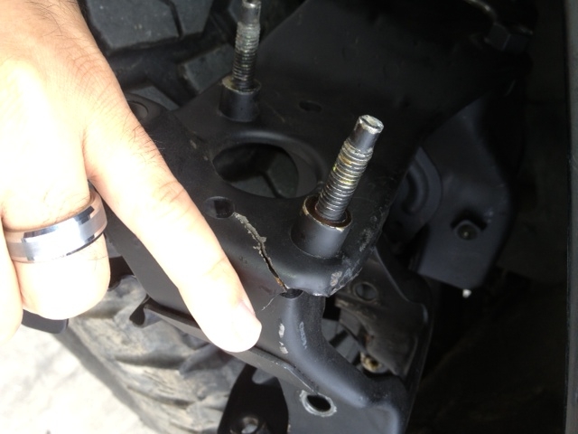

Here's the kicker/where things got weird...
jump in it to take it for a spin, will not shift into reverse. Grind...grind ...grind..
Dear gawd what have I done?!
checked the fluids...no leaks...check the clutch bracket...sure enough.. clutch pedal bracket broke (again)
woke up the next morning and hit up pick a part.. no 4runner clutch brackets..pulled one from a v6 pick up (2wd) ...not the same BTW :naughty:
ended up pulling my bracket and welding it up and bracing it a little.
Such a PITA working under the dash in the pedal area.
All is well now. :driving:
