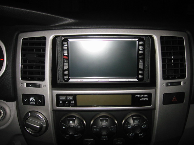

Installation Done!
All went smooth took about 3.5 hours last night. I ordered the trim pieces today should have them by the end of the week. The installation information provided here was a great help, Thanks!!

Yep, I finally got them a couple days ago, but they're not going to to work with the JBL sized opening in my dash. They're not wide enough and do not angle out to match the angle of the dash opening.
I had already modified my old single din dash kit I got from Crutchfield (see my earlier posts in this thread) to fit the Eclipse. The gaps are now filled in, but since I used a dremel tool to carve out the plastic, some edges are a little rough. I finished it off by cutting out a "faceplate" out of a thin black plastic folder I got from office depot. I used double stick tape and overlayed that onto the dash kit I modified. It now looks a lot cleaner, although still not perfect.
