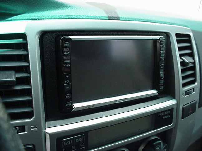

Ok, here is the first shot at this. The ring installs right over everything. Just use a small piece of double sided tape and all is golden. I

Jelgas, that looks nice! I have a feeling that wouldn't work very well with the JBL setup, but on yours it looks perfect. With the JBL, there's no inside trim behind the silver front part of the dash. Since the radio sits vertically and the dash has an angle to it, there would still be a gap between the trim piece you made and the opening of the dash when you look at it from the sides.
You're right, but I'm sure I can do one for yours. All you need to do is get me the width and height, it would look just as good as mine.

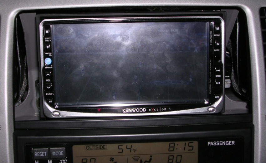

Here's a quick shot of my attempt to modify my old Scosche single DIN trim kit to fit the AVN 5435. I went a little crazy with the dremel tool so it's not super smooth and clean looking, but it looks better than it did without it. I basically just cut the bottom pocket out and trimmed the top and bottom to fit the Eclipse. The sides get filled in nicely because the kit was made for the JBL opening. There's still about a 1cm gap along the sides of the unit, but it's not too bad.
