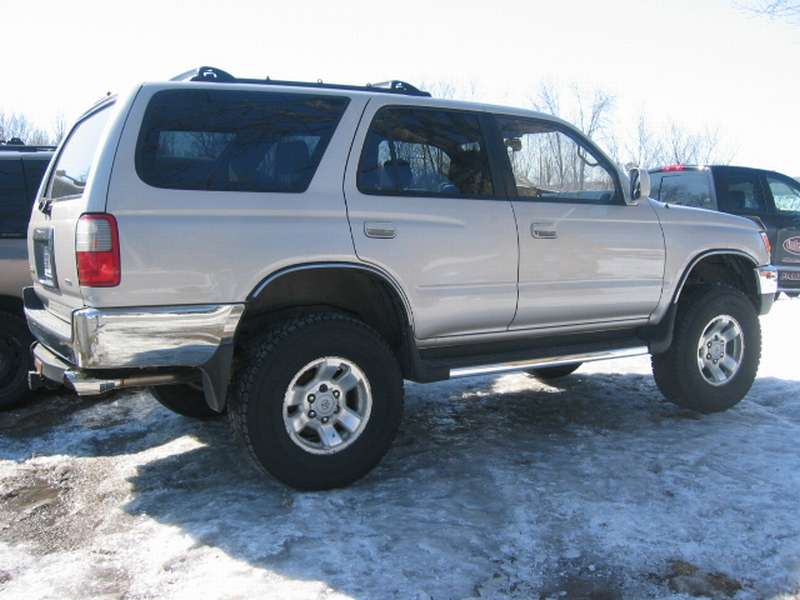

i pieced all the lift together but you can get all of it from toytec lifts and they have the best prices!!! if you do lift you ride and like my setup i have the OME (old man emu) OME 883 springs and the toytec top plate spacer in the front (which were intended for 2in of lift on the new 4runners and gives us 3.5in of lift. only three of us are using them) and in the rear i have OME 890's and a 1.5 coil spacer (the spacer is the only thing i did not get from toyec and i got it from this site http://www.suspensionconnection.com/.../KT09107L.html ) (if that link doesnt work just go to suspensionconnection.com and search around.) also get new longer shocks i have the OME ones toytec also sells.
I am currently piecing togethor my lift. there is another fella running a similiar lift on the yota forums..
front: OME 883 coils w/ toytec top plate spacer (intended for 2" of lift on 4th gen T4R's but gives us 3.5" of lift"
rear: OME 890's w/ 1.5 coil spacer (the spacer can be purchased from http://www.suspensionconnection.com)
OME shocks.
I would post a picture of the fella's T4R..its a beast, and runs 35" MTR's!
